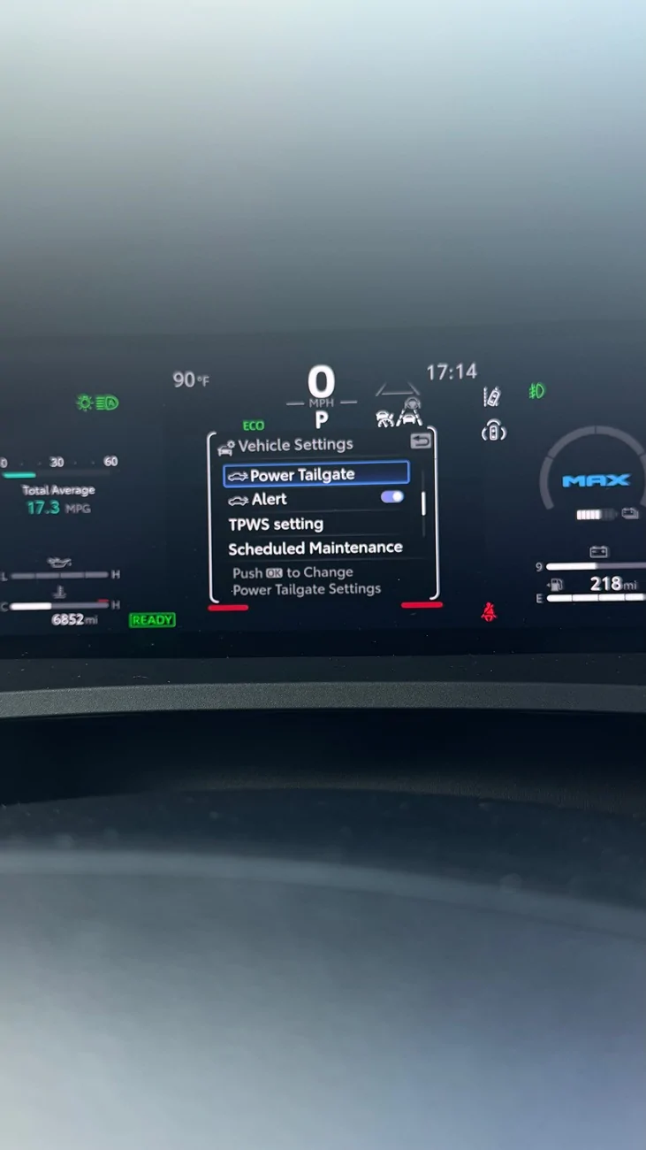

guys can't we just disable the setting in the in the dash? the button won't open the tailgate if that setting is off. Am i wrong or missing something? Seems a bit unnecessary to unplug the button.

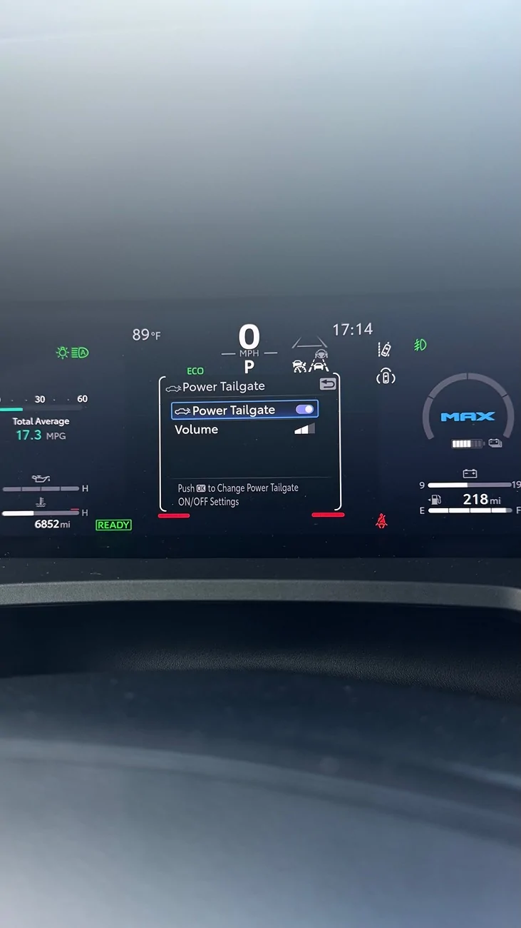

I only know about this because my tailgate button didn’t work when I bought the truck. The dealer helped me figure it out.
2024 Tacoma Stolen Tailgates IMG_1685
2024 Tacoma Stolen Tailgates IMG_1686

That’s super weird I don’t see that setting, will triple check…
..that’s the thing tho, if the truck’s alarm is on/locked they can’t unlock the truck (cabin) after breaking the window. Roll down your window and lock the truck, get the fob in a faraday bag and test it.. if you manually open the doors with the vehicle locked yes the alarm goes off, but lock buttons are inop
EDIT: found it! Yea buried deep in vehicle settings. Good eye! šŸ¤™šŸ¼ gonna put black sticker over the button until I trade it in
Awesome! Glad you found it. Hopefully now you see my confusion. I was wondering why someone would go through the extra work to unplug and replace the physical button when you could just disable it in the settings.
Side note: it also disables the buttons on the side of the tailgate and the kick function too. It just becomes a regular manual tailgate.
So…interesting wrinkle to disabling the power tailgate on the digital dash settings: once I deactivate it, my powered tailgate will still open by using the side buttons near the tail lights, but will no longer close. It’s odd, suppose not a dealbreaker for some but I’ve gotten used to using that Gucci tailgate motor. Disconnecting the button on the driver console takes about 5 minutes so net net that’s still the easiest way to disable that security vulnerability while still benefiting from near field communication & functionality with my fobs & phone
