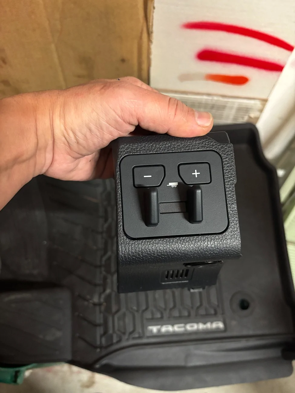

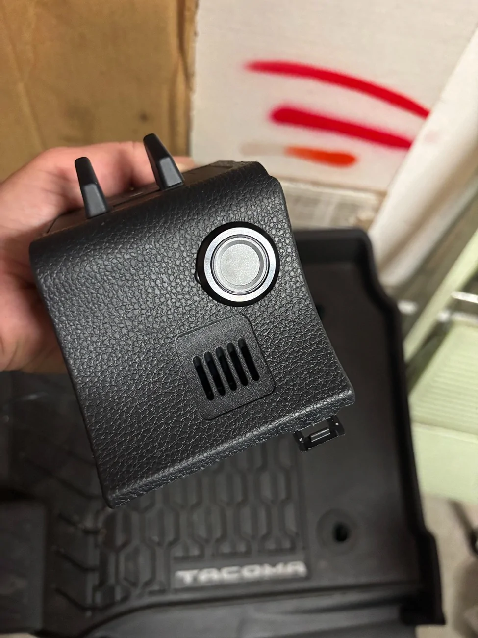

Hey guys, new here. Wanted to share an idea to someone who might be interested. Anyway the first thing I did installed 41.22 relay kill switch but instead of the switch it came with I did purchased 30$ CAD fingerprint scanner with relay controll box on Aliexpress. Dont have to hide it. Works very good. So even if a thief got my keys they won't be able to start it unless replacing starter relay with original one. Fingerprint connected to constant power. It draws 50uA at idle and 150mA when active which is few seconds. Installed it not direct view but under trailer brake panel.

If you cannot garage your rig this is one of the better security ideas. ☝🏼
Got a link for the fingerprint scanner with relay control? There are many to choose from.

How hard is this to wire up?
I’m about to find out next week when my kits deliver. There’s two setup methods according to filgr8, I DM’d him today. It’s pretty badass and ironclad in terms of security. The only way a thief could steal a Toyota with this implemented is if they got their hands on a tow truck. But if you AirTag your rig, cops will be there before they can get the truck running on it’s own volition

Interesting - how would this compare to Ravelco
Well a physical plug with a Ravelco is pretty solid, it’s definitely something within direct view from dealership service techs unsure if that voids a warranty, whereas the fingerprint scanner method using a mix of either in-line kill switches with a removable relay and a smaller UI scanner that can basically look like nothing and will act like nothing unless it’s your fingerprint. I would think this Ravelco is more expensive net net but don’t quote me on this I’m pretty new to onboard electronics anti-theft setups.
