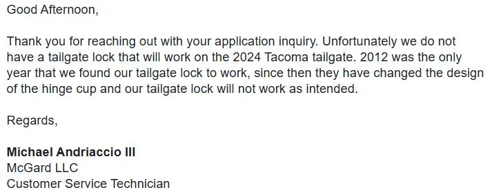

I wanted to be sure before ordering a tailgate lock from McGard, so I contacted them. Their reply is attached. Does anyone know of a company that has a different solution?

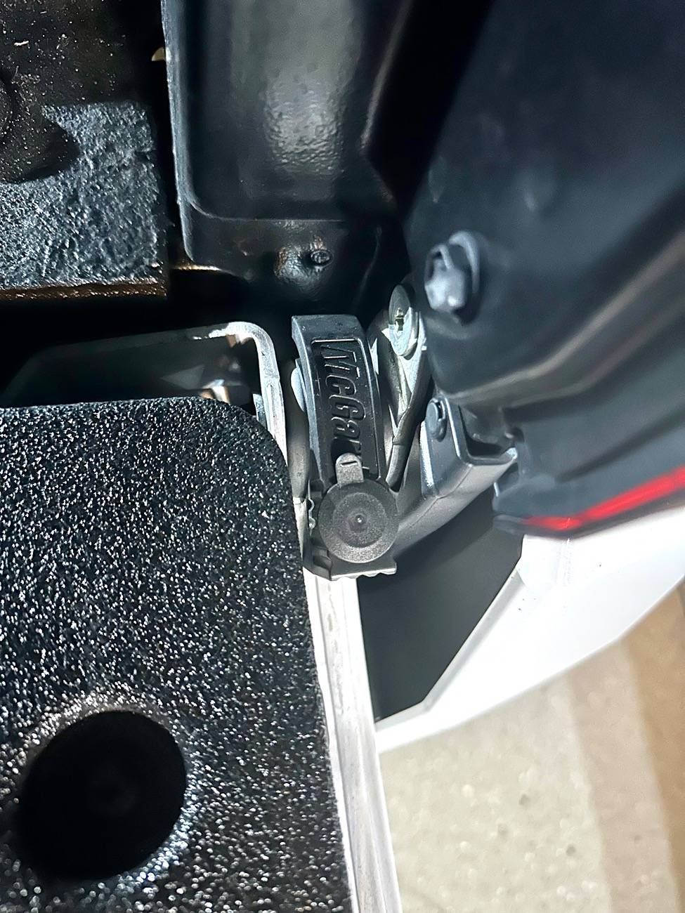

I had to cut a 1/2ā€ wide strip of aluminum to wrap around mine (the clamp band is too narrow) and then installed the clap around it. You’ll have to leave it slightly loose to be able to rotate it to its final resting position (It has to rotate forward for the tailgate to close). Position clamp as far right as possible and aluminum strip to the left. After looking at the Pop & Lock, I think I would order that one. It looks like it would be the better choice. But they will both work.

It looks like you may have it rotated 90 degrees forward. Here is mine.
Yes, it is! I had to do that for my tailgate to close properly. I notice that your tail gate doesn’t have the rubber edge that mine does. Is yours a 2024 - automatic tailgate?
Wow that is different. Mine is a 2024 TRD Sport without an automatic tailgate.

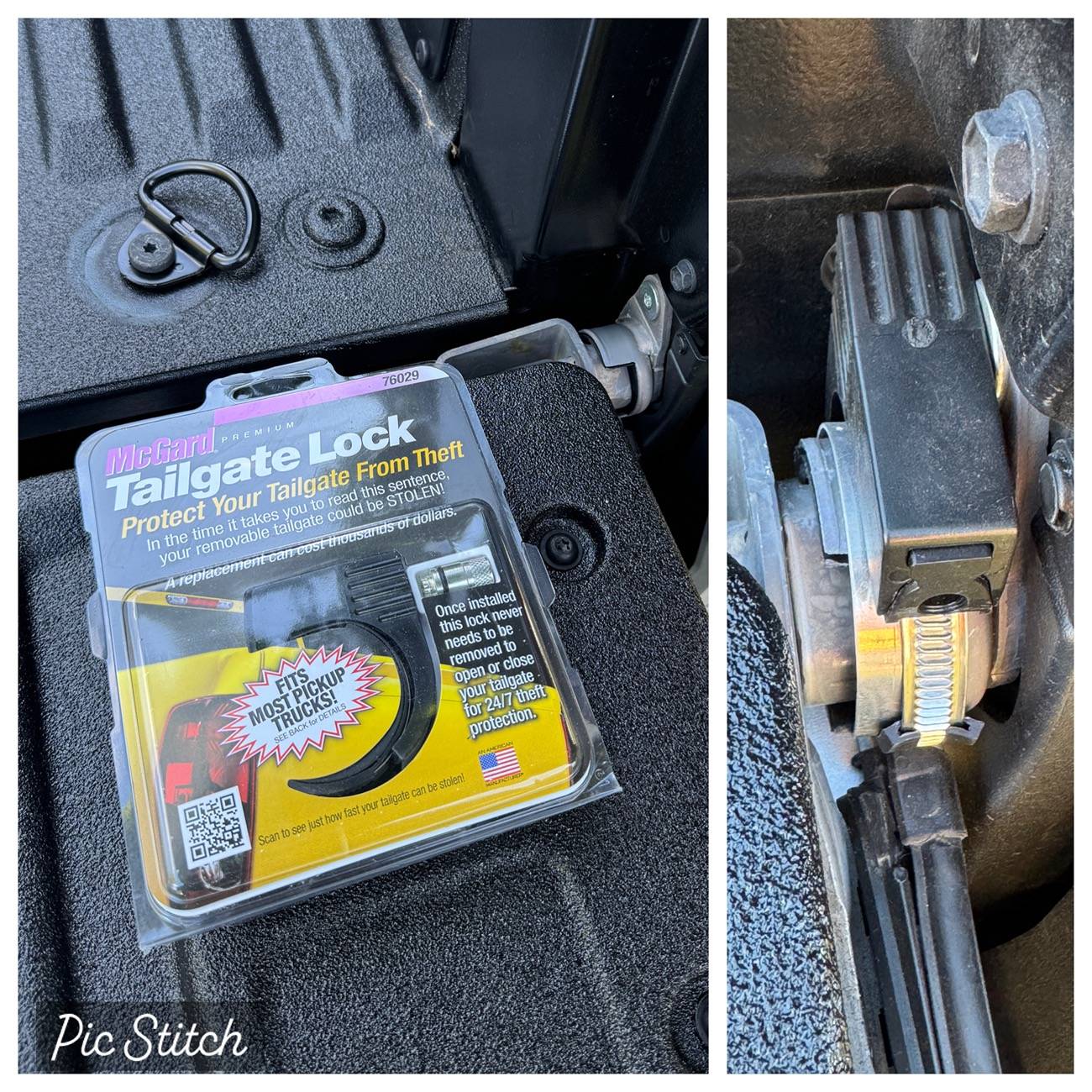

Thanks for all of the advice. I have the TRD OR without auto tailgate. I just installed the McGard lock. It took 2 minutes and fit perfectly without using the included sizing inserts.
