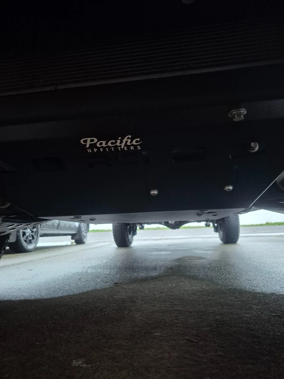

I have a 2024 TRD OR with the SDC, I run a full set of RCI skids with no problems with the SDC. I will say it's protected well by the skids, yet as I know anything can happen when you think it won't.
I've had no problems with the SDC working as it should. I will admit I did not know. I didn't know that I need to cycle it once a month. Thank you.
2024 Tacoma Sway Bar Disconnect Mechanism Question 20251216_082134

Looks really protected. Nice!
