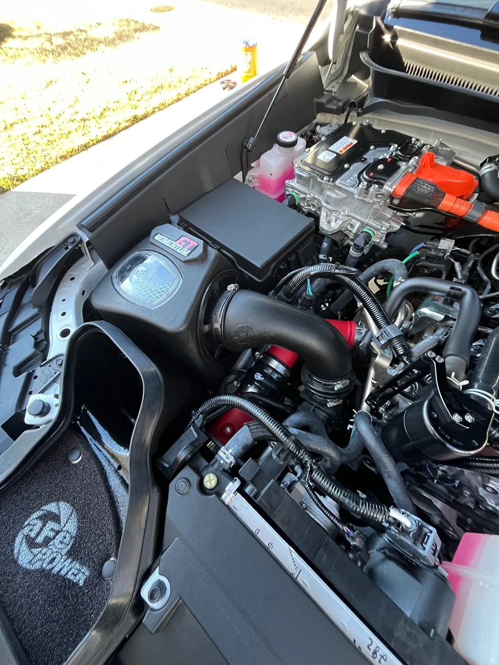

I’ve been using the AFE Power charge pipes now for +/- 9k miles. No issues. Knock on wood
