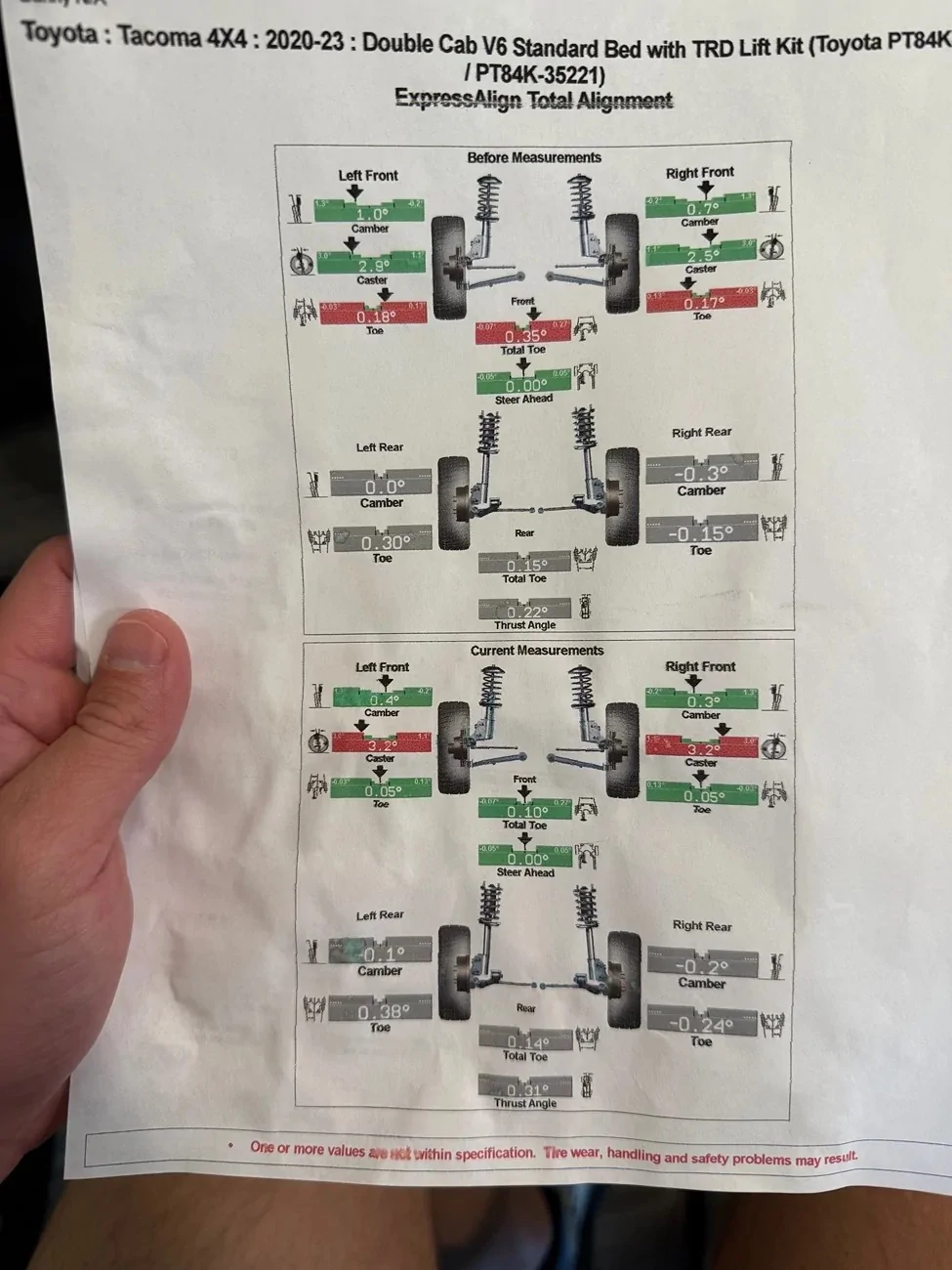

In comparison here is my trucks last alignment:
2024 Tacoma Toyota Dealer - No clue on alignment 36413-a205674f5e38c8ca1aaf29eaf70d5ef1
Which should apply to all 4Gs front end to be honest.
The spec is just completely wrong. A degree of toe?? In what world is that correct?

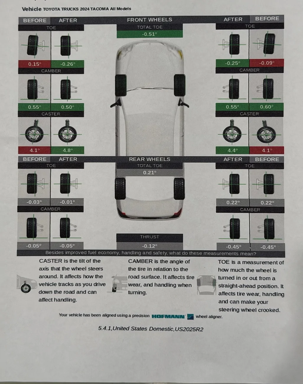

This was my readings after an alignment today
2024 Tacoma Toyota Dealer - No clue on alignment IMG_4998
All are in green so I guess I’m going to drive and see. 🤷‍♂️
Why a quarter of toe in instead of zero toe each? At least you have almost no cross toe..
Toe in isn't going to do your tires any favors. I guess it helps high speed stability.. big deal in a truck 🙄

Honestly I’m not sure why the specs ask for it. They did it according to their computer. Hopefully the toe isnt going to scrub my tires much.
EDIT: Apparently my brain went to trucks, and some cars are zero toe.

No mass-produced factory vehicle has zero toe. All have some amount of toe-in to prevent wandering or rut following.
(I'm sure some supercars have weird alignment specs, but those aren't relevant in the real world)
Most shops hadn't updated their alignment computers for the new specs for the 4th Gen. And most chain alignment shops flat out suck... I can do better in my shop by hand.
But the numbers have always been available in the Factory Service Manual.
Plenty of cars have a range like "-0.12 to +0.12" for toe, which means it's up to the owner / technician. WRX/GR86 both use that number above.
A normal amount of toe out or in is like -/+0.10 not 0.90. A full degree is crazy and will be visible when looking at the wheel with the naked eye. Even half a degree is too much.
Zero toe is also fine, my truck doesn't tramline or follow ruts an abnormal amount even on grooved cement freeways.
Huh, I guess I'm wrong. Maybe I was thinking of trucks more than cars... It's been a long time since I've done anything on non-4wd vehicles.
I've also ran zero toe on my modded trucks and cars in the past. But in recent years I've stuck with very slight toe-in. More like 1/8" toe-in per side at the most, which is 0.44° with a 32" tire.
