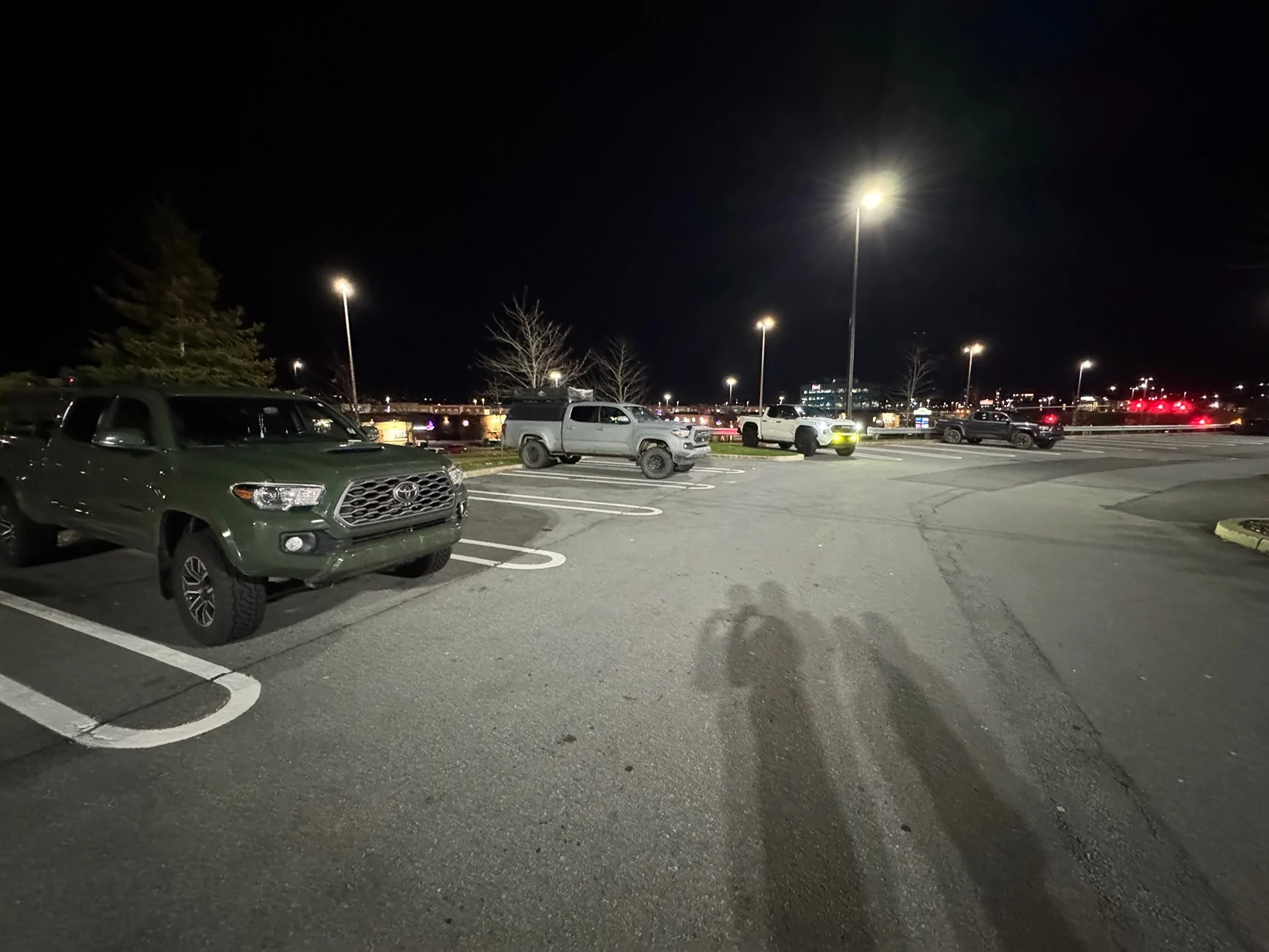

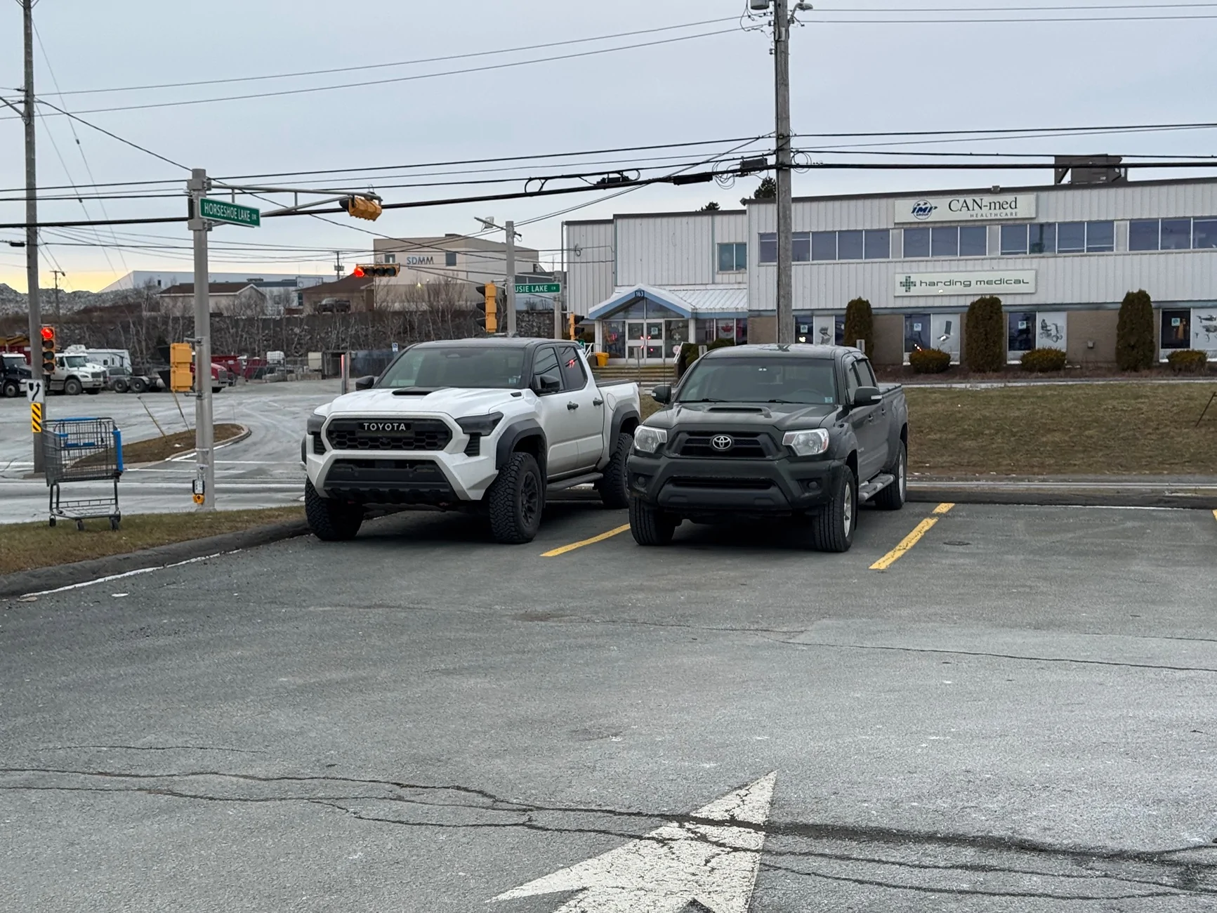

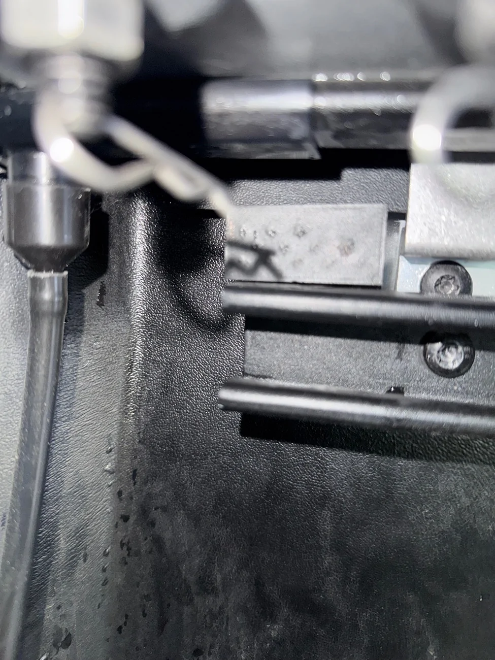

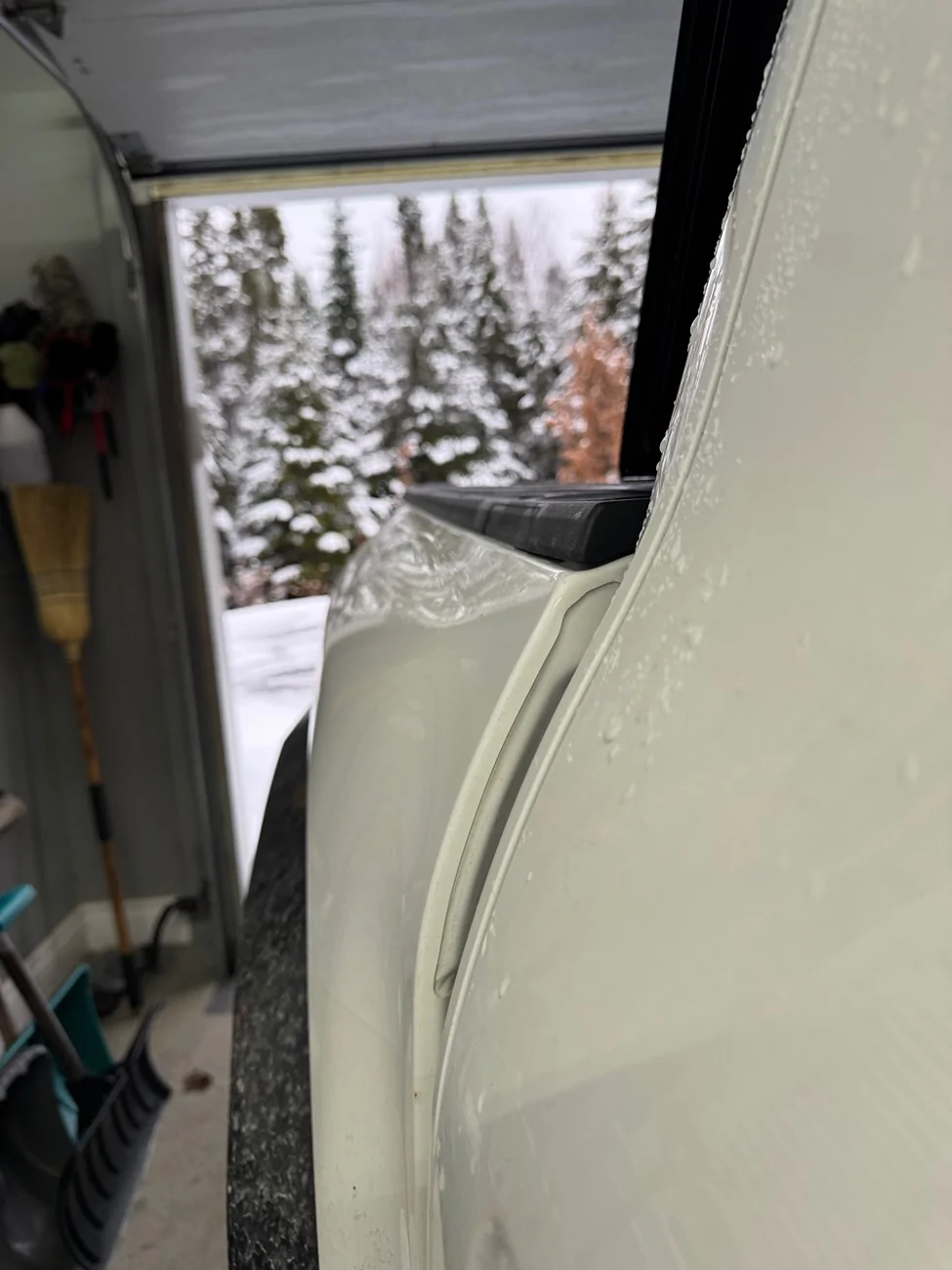

This weekends waste of time that took over 2 months to find out, had these pieces printed at a local university to help the bed top gap for the oem tonneau, they don’t help at all, there’s not much I could be missing besides it just doesn’t do what it’s meant to, bonus picture of being Tacoma’d at Lee Valley

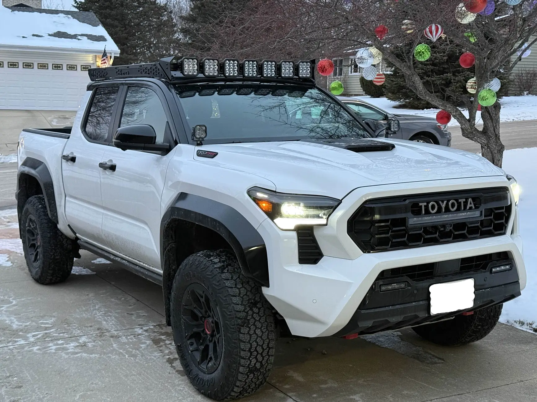

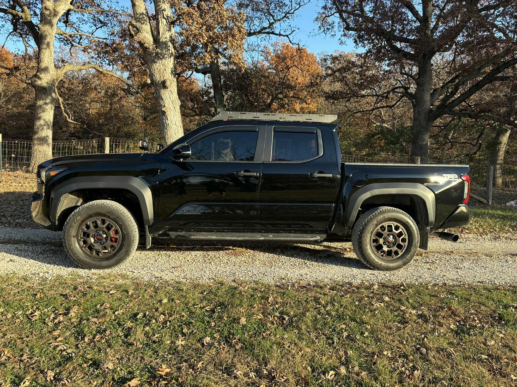

Installed a new Rago Fabrication Roof Rack with a Diode Dynamics 7-pod SS5 Sport Crosslink light kit (4 combo lenses, center 3 are spot lenses). Lights are wired (not shown in this photo) to factory Auxiliary-HI harness that comes with the 2025 hybrids, though I'll probably get a D-Switch or similar at some point.
Next on the list are frame-mounted rock sliders (Haven't decided on which one I want yet) and a power relocation kit to provide battery-connected and fused positive and ground terminals under the hood for future upgrades like a D-Switch, winch, etc.

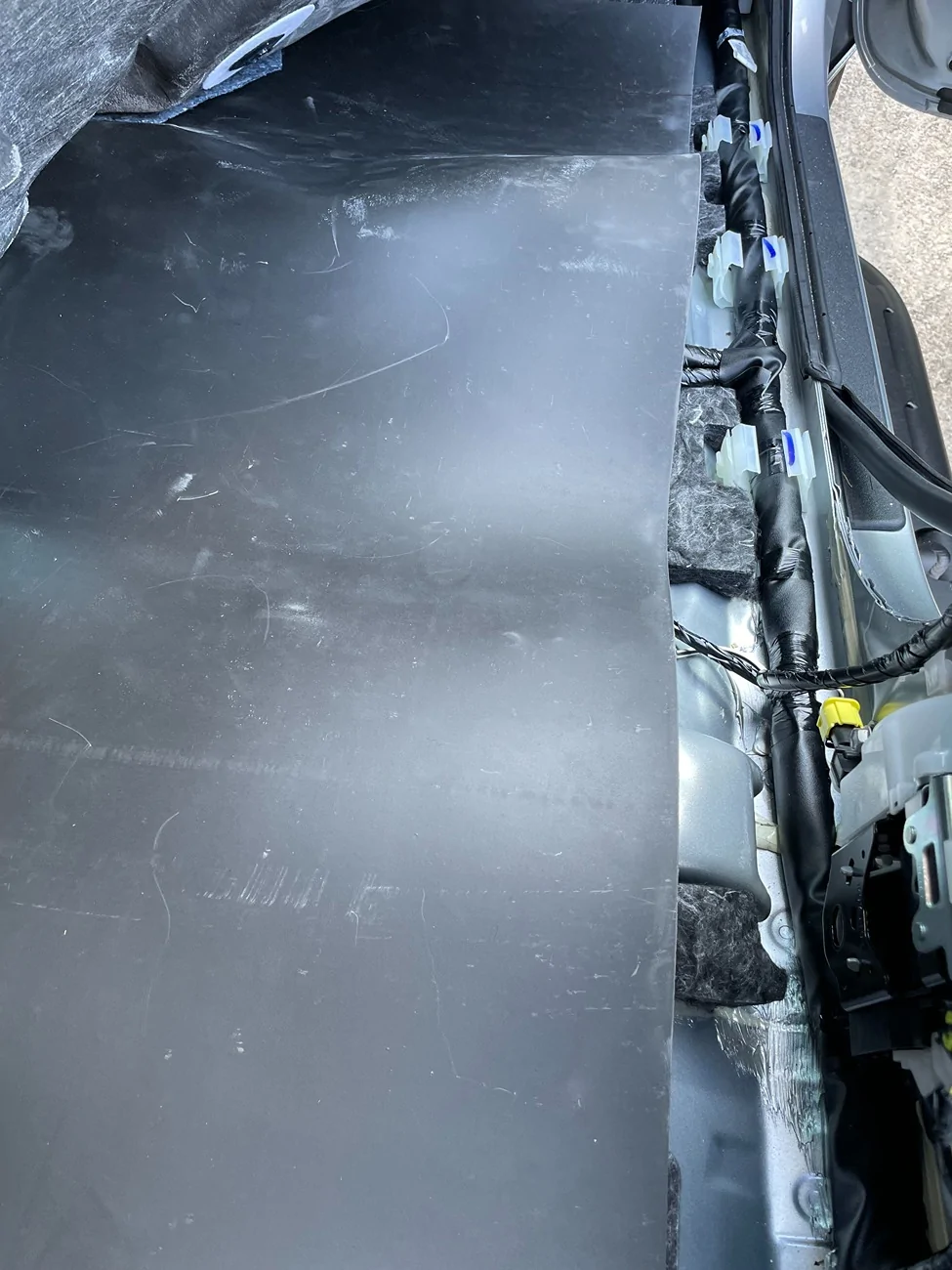

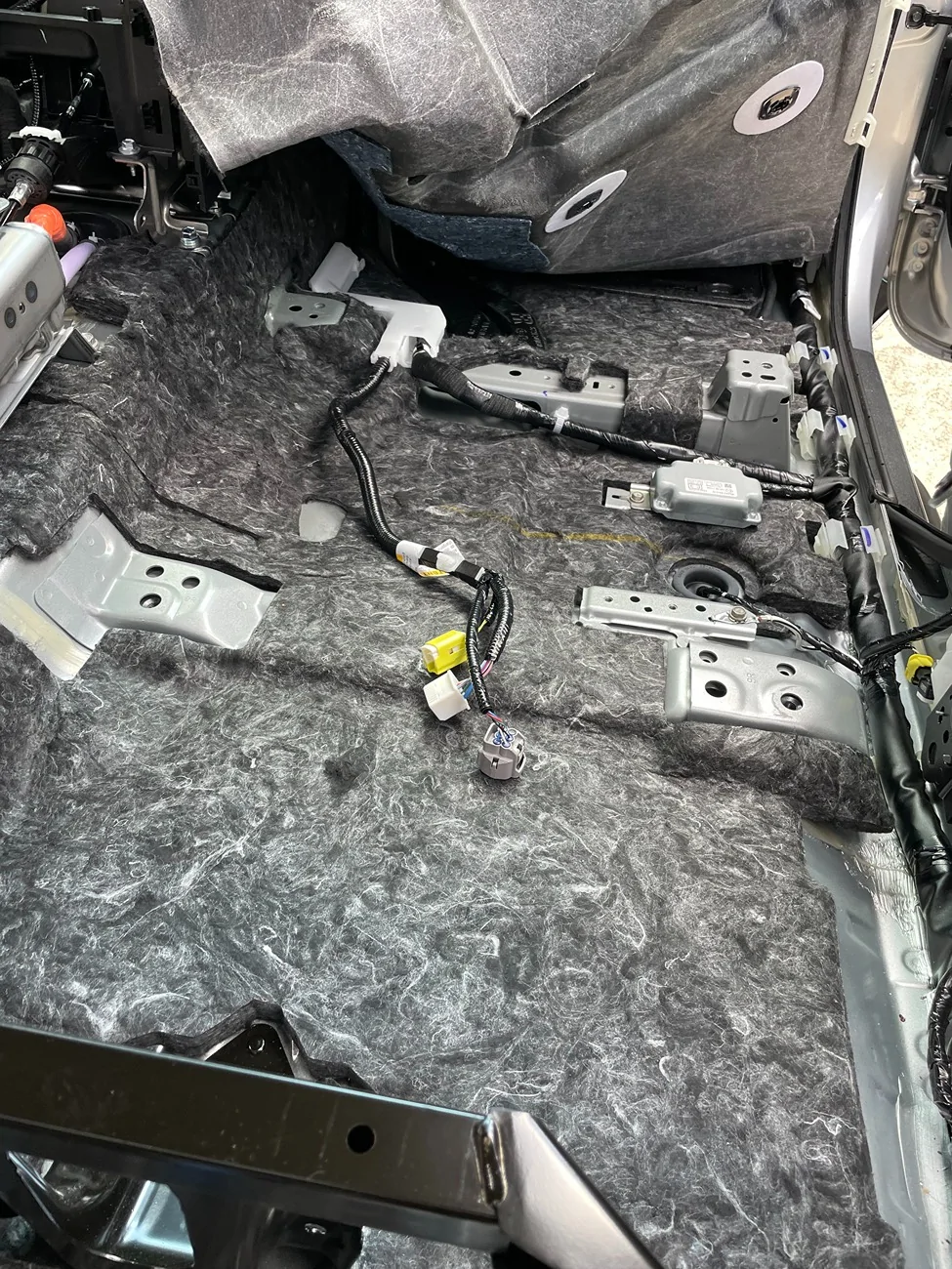

Finally had a chance to finish my sound deadening project. Today I installed mass loaded vinyl (MLV) on the floor. Toyota did not put 1 inch of any sound deadening on the roof, doors, rear wall, or hood. I installed sound deadening in those areas and had already posted pictures on this thread. Toyota did put a small amount on the floor but it was not nearly enough. After removing the front and rear seats along with the center console I was ready to tackle the hard work. The first picture shows the carpet removed with just the carpet pad on the floor which will decouple the MLV making it more effective. The second picture shows the layer of MLV which goes between the carpet pad and carpet. I still had to cut holes for the bolt holes, wiring harness, and floor duct and then put everything back together. I did a quick test drive and it did make a difference.

Congrats! Patience of a saint to have tackled that huge chore.

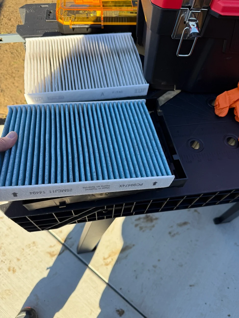

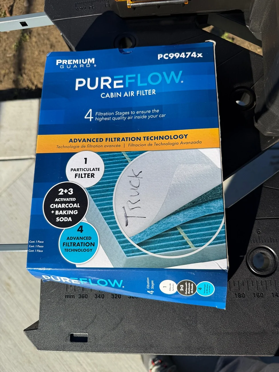

Saturday: Cabin air filter change. This pic shows the original Toyota cabin air filter and the PureFlow with carbon that I bought via Amazon.
