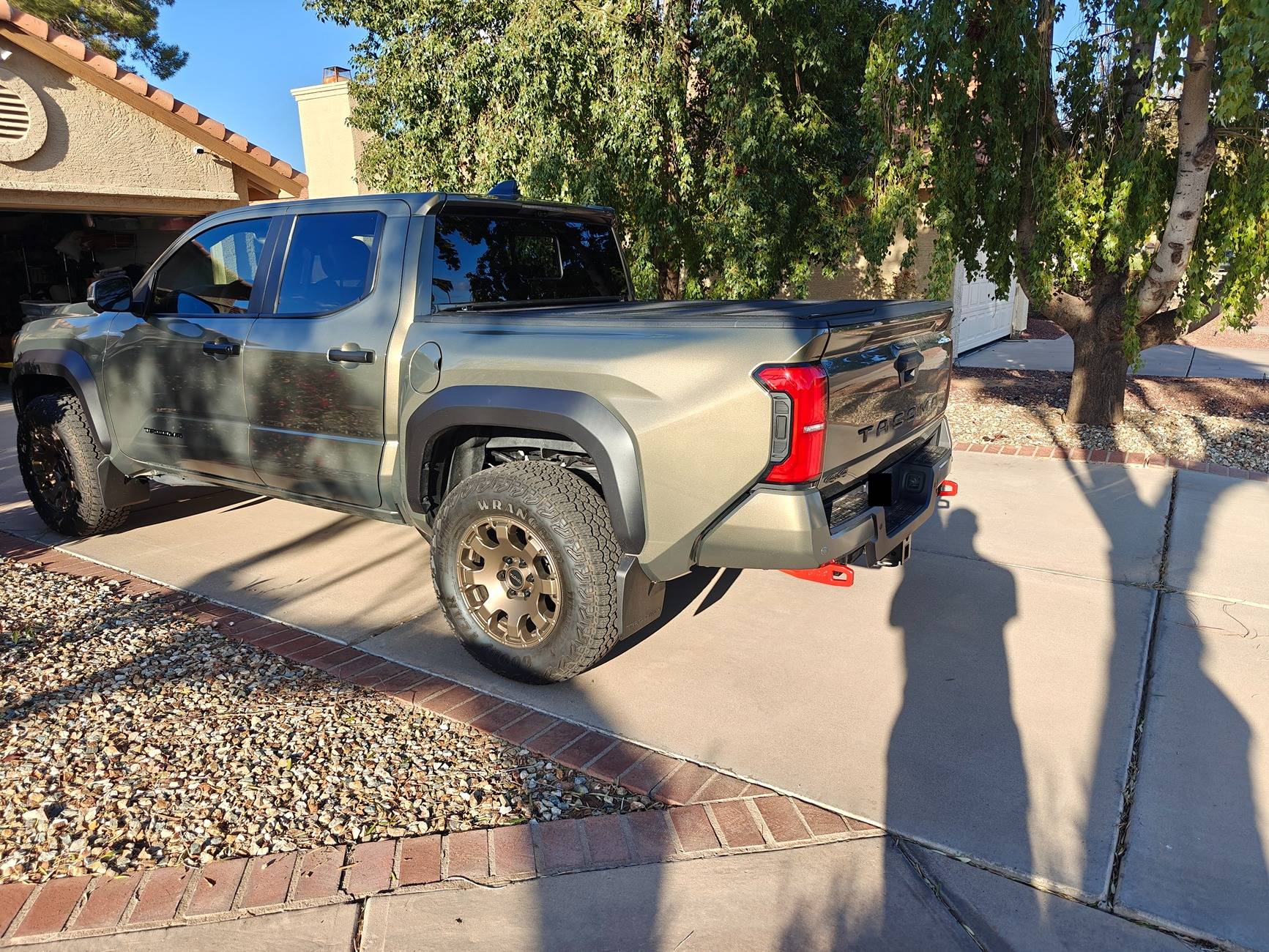

Which Icon wheels are those? What’s the offset?Do they poke out past the fender flares a lot?
I,m wanting to run the same tire on new wheels, but unsure on what specs/offset to get and have minimal poke.
Thanks!
I’m running the same icon wheels, recon SLX +25 offset.
