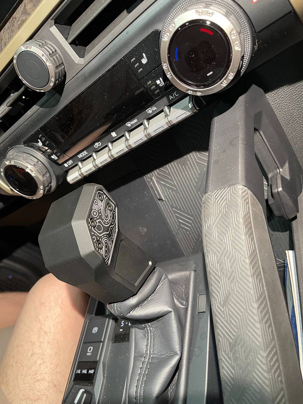

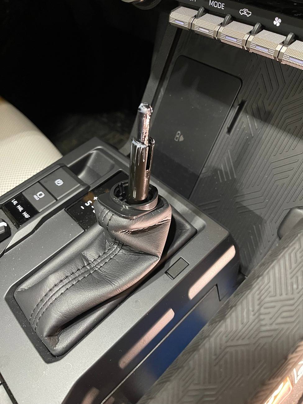

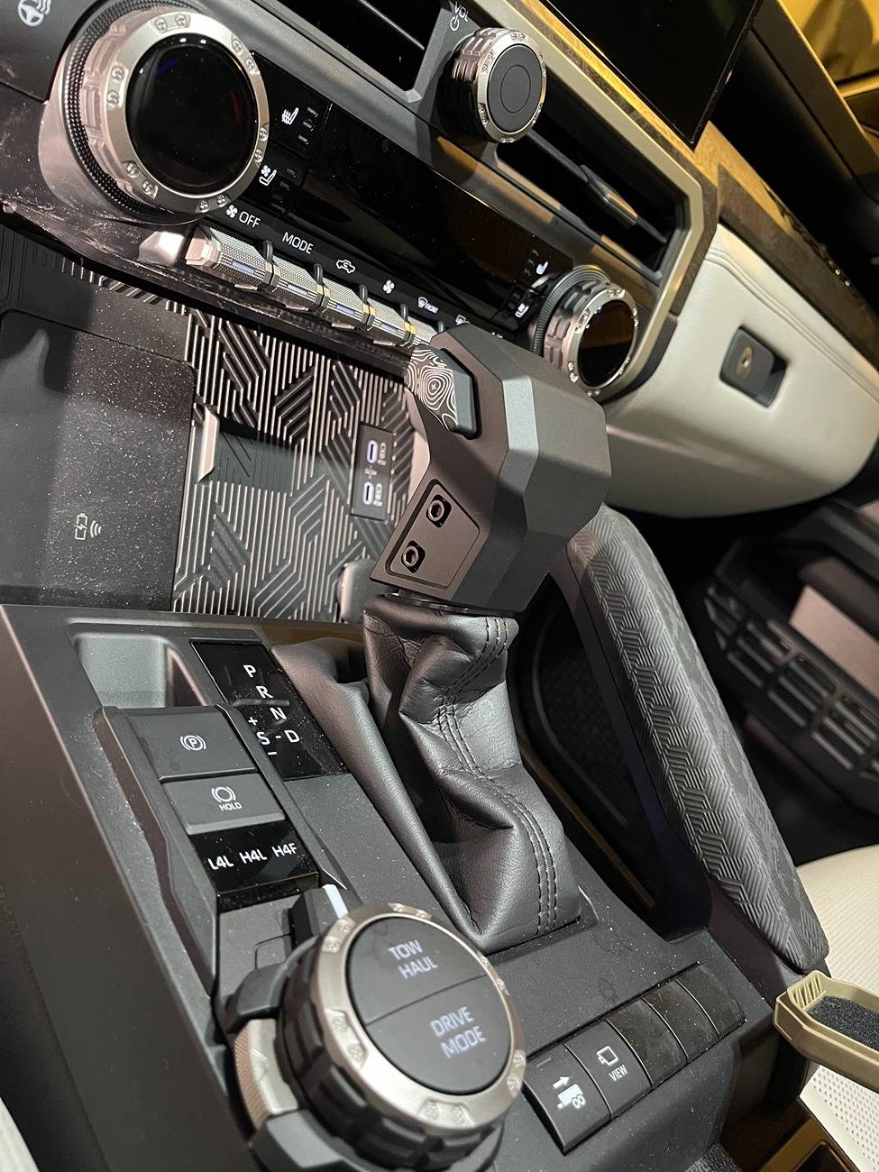

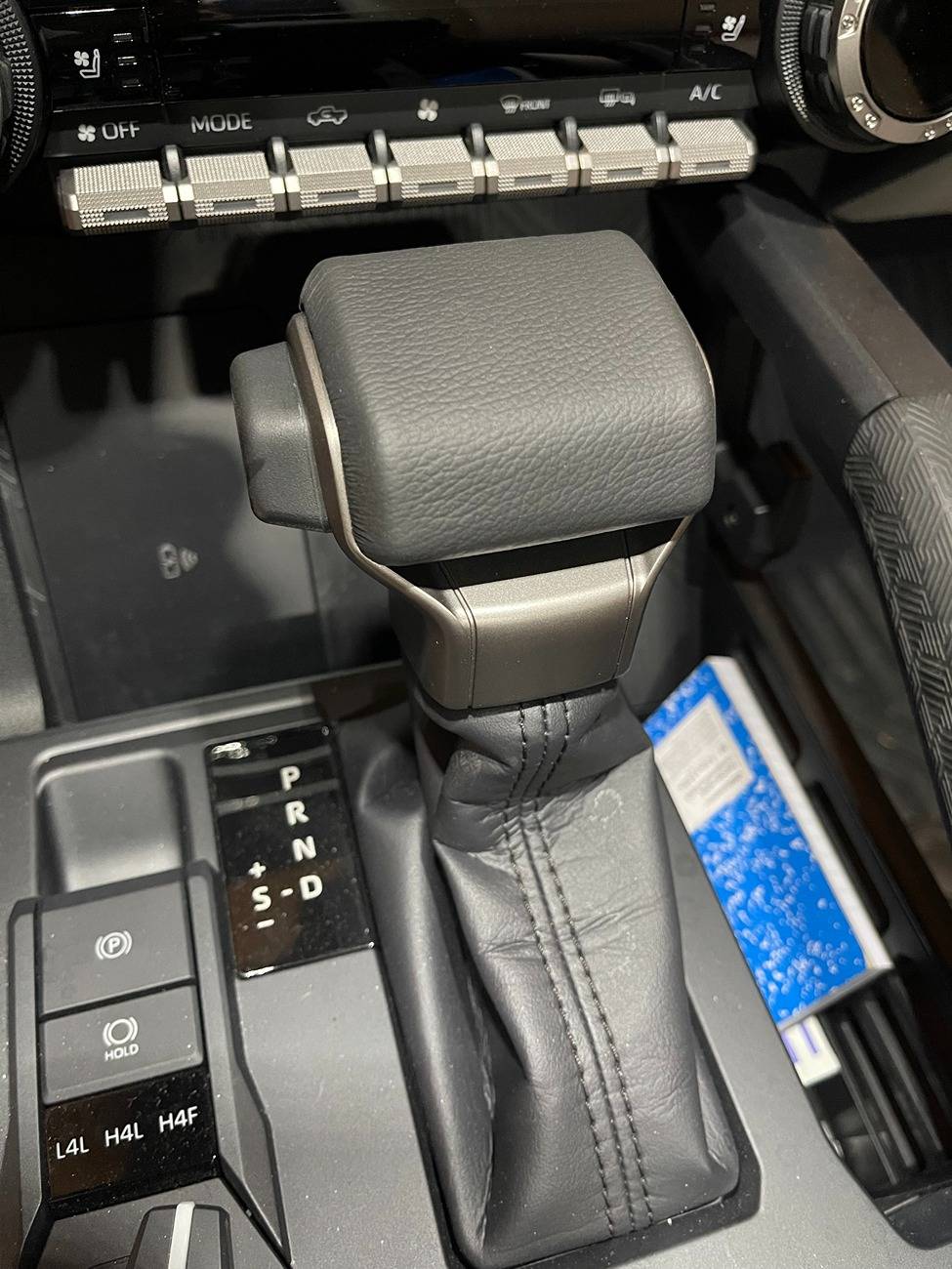

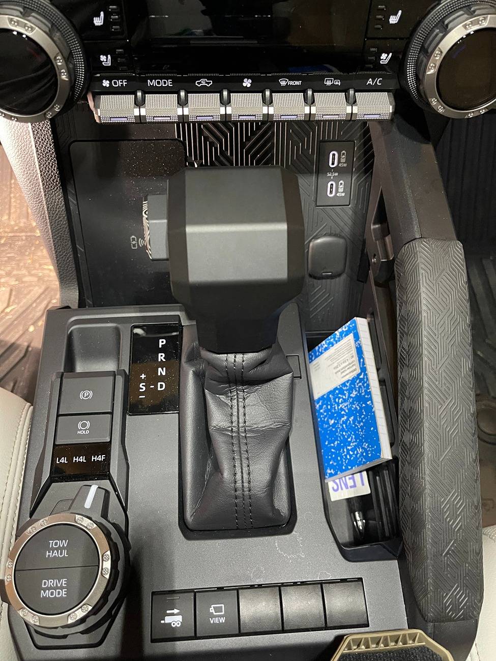

Got my AJT DESIGN Shift Knob installed. The spring clip holding the original knob on gave me a little resistance, however as the Borg say, "Resistance is futile."

Hey bravada do you have any fitment problems? AJT shift knob causes the truck to think I am not in park when I am in park.
I reached out to AJT and they kinda gave me the runaround and told me to try to lift it up and have the set screws hold it up but it binds up.

So far no issues. I believe it came with instructions to not bottom it out on the Tacoma.

thanks, ill give it another go. feels like either it binds up (too high up) or does not think im in park (too low?)

I'll try and make a short video later, to show it functioning.

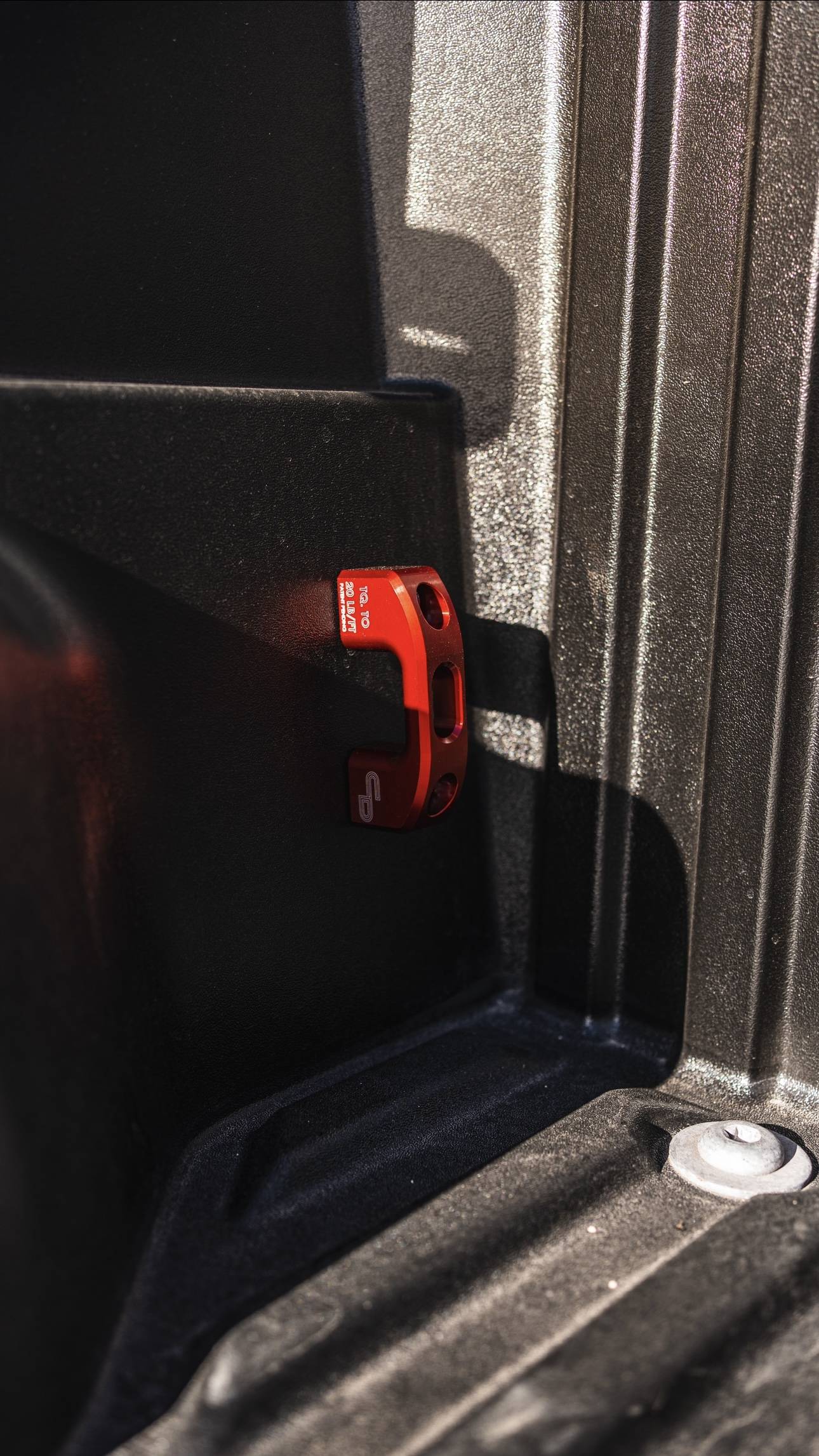

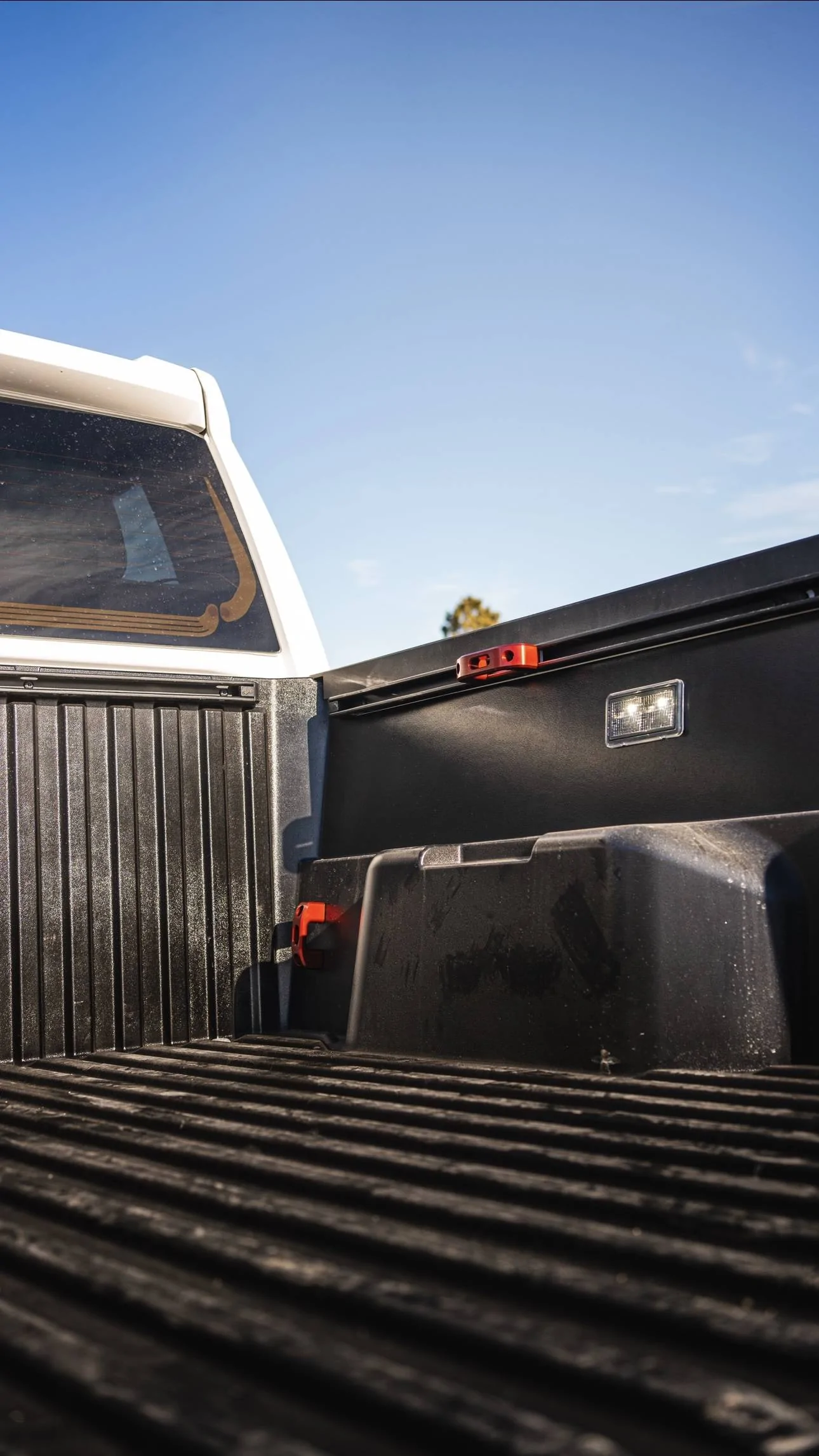

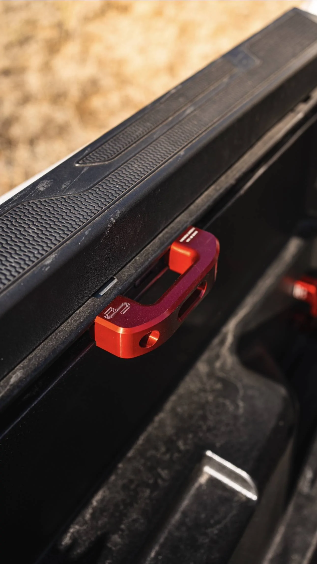

I just installed these billet tie down points on my 2024 Tacoma TRD ORP. If you want a pair, head over to https://billettiedowns.com/ and use code β€œGHOSTED” to save on your purchase!!
I bought a set of these but I'm having a hard time removing the OEM from the spray-on bed liner to install these. Pls advise. Thanks!

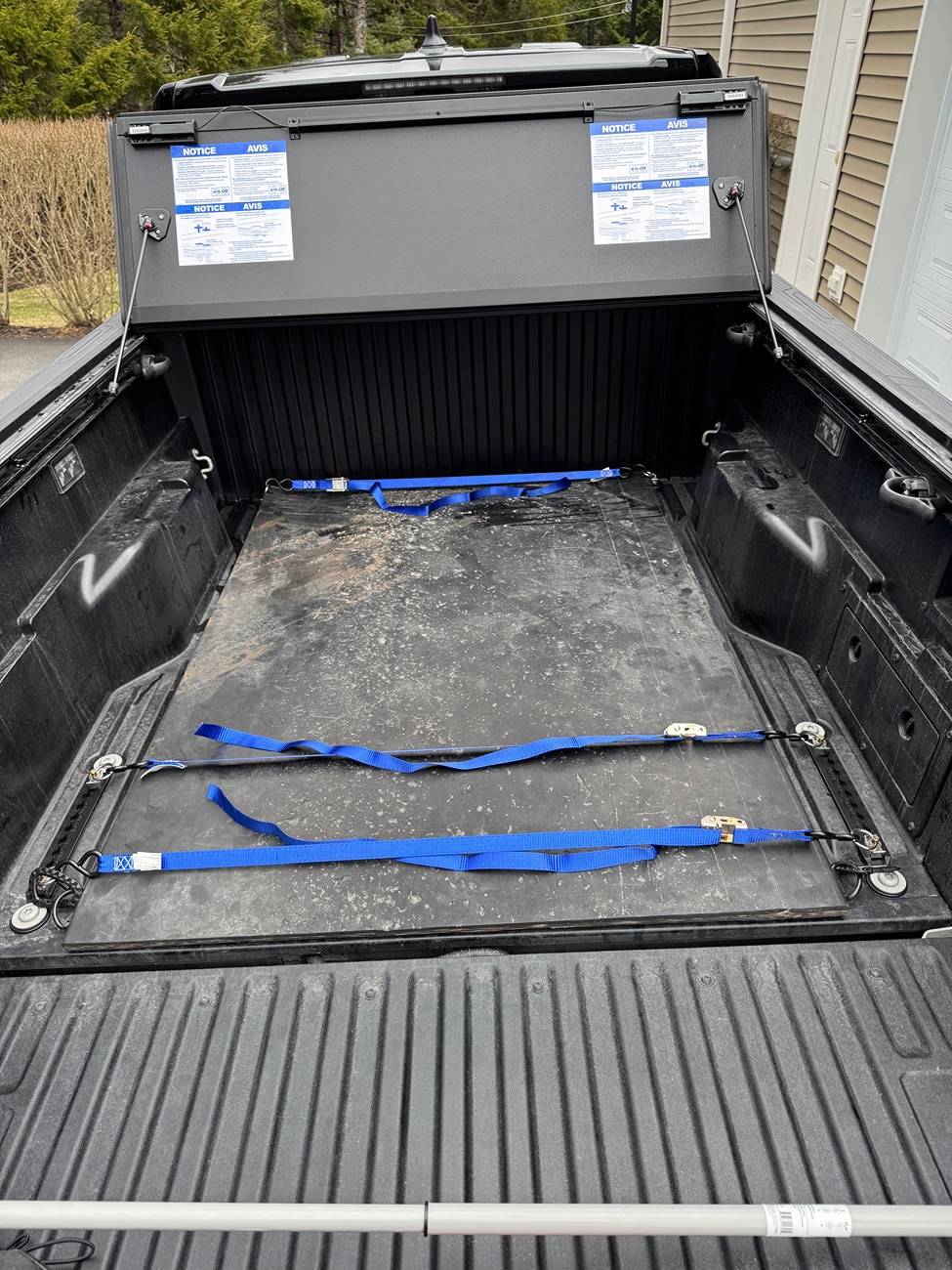

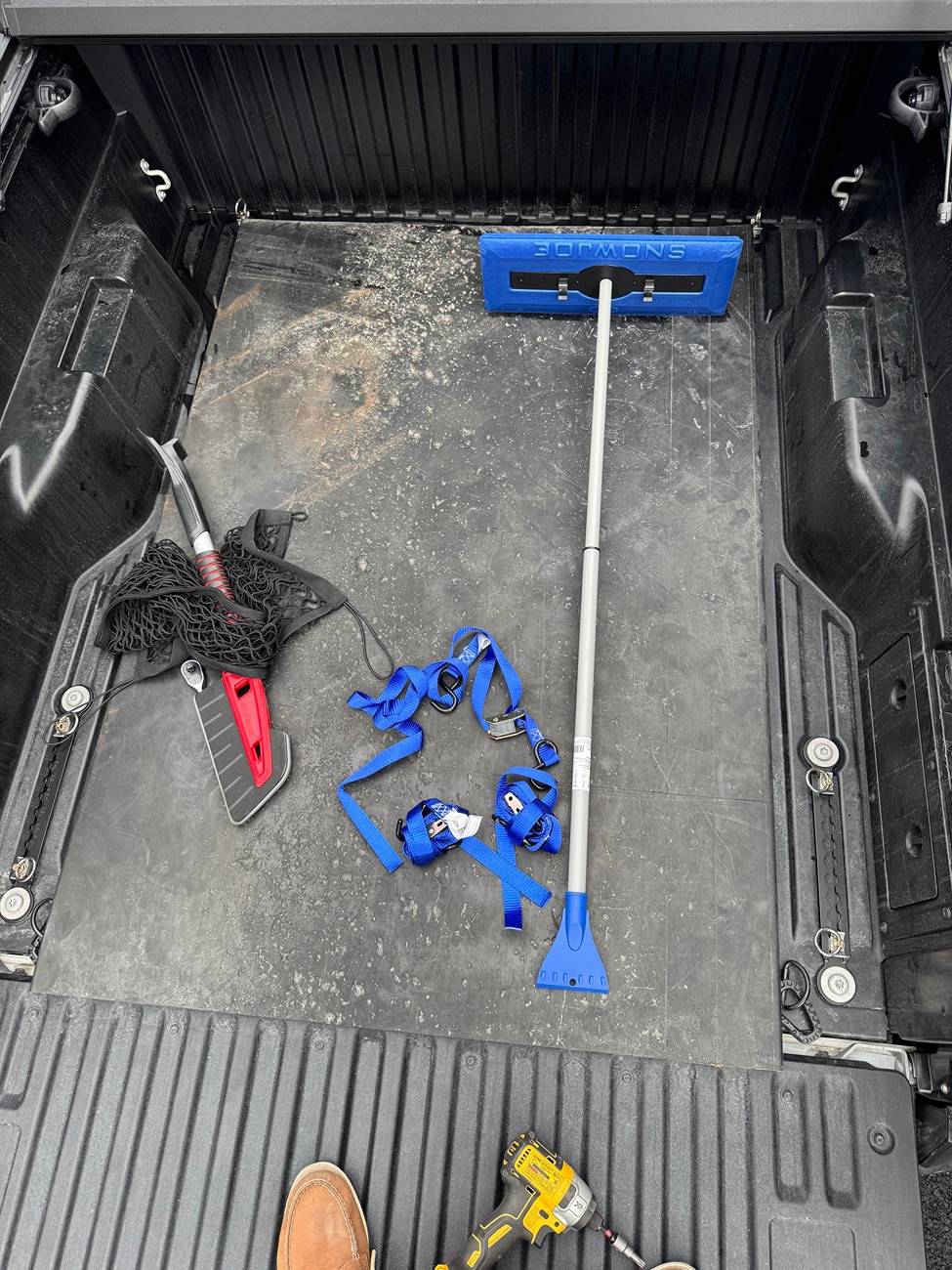

Added Versatrax for some extra tie-down locations. When the rings are removed the tracks are flush and bed mat lays flat over the top.
You’re today’s bad influence, these costed me a ton with tariffs but I LOVE the idea, I am going to trim my rubber mat to fit the front anchors better but that might be a Sunday issue

Sorry about the extra $$ you had to pay, but yeah, I think you'll find them helpful.

Your rail end caps are stuck on with the spray-on bedliner? Or the tie downs on the floor of the bed? When I installed my front bed Molle panel, I had to take a razor and a pick to get the bolts out of the bed floor. I cut carefully around the bolts, and used the pick to dig out the bed liner from around and in the head of the bolt, so I could get the bit in the bolt.
