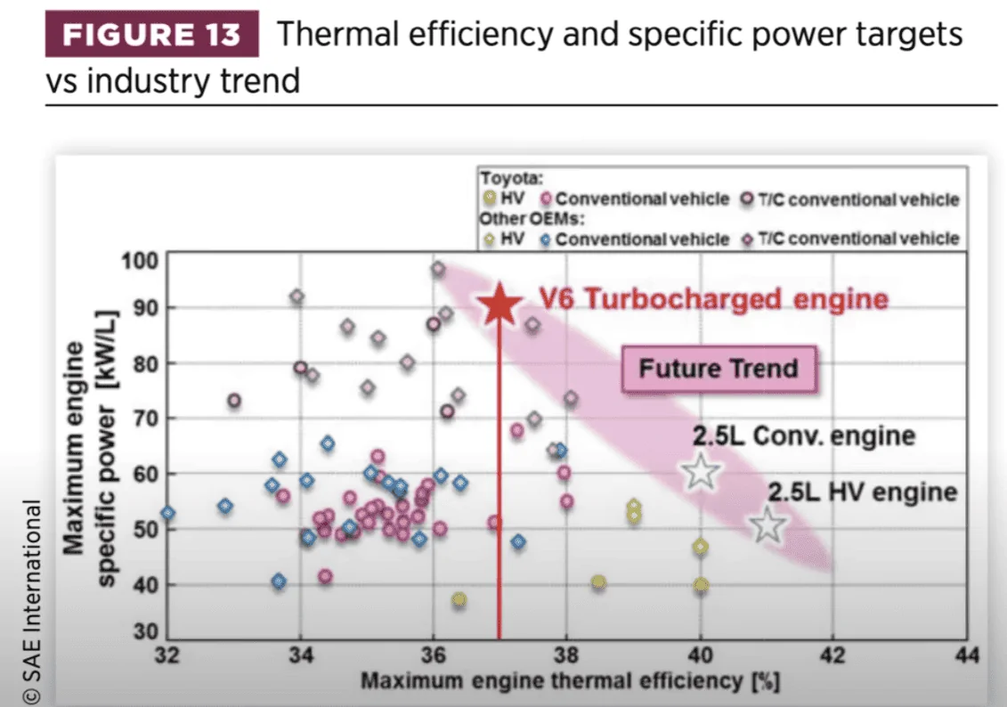

I found this video really interesting. It looks like Toyota has been making a concerted effort to improve thermal efficiency in TNGA engines. In terms of engineering, it's a whole slew of innovations to shift the graph below to the right and increase reliability via thermal efficiency. So TNGA has been focused on performance targets like tumble ratio and flow coefficient, combustion speed, exhaust gas temp, knocking mitigation combustion stability, scavenging LSPI, and fuel consumption.
2024 Tacoma Will the Turbo engine last (reliability / longevity)? 1715777864453
Tinkerer's Adventure:
Here's the SAE publication:
https://www.sae.org/publications/technical-papers/content/2018-01-0366/
