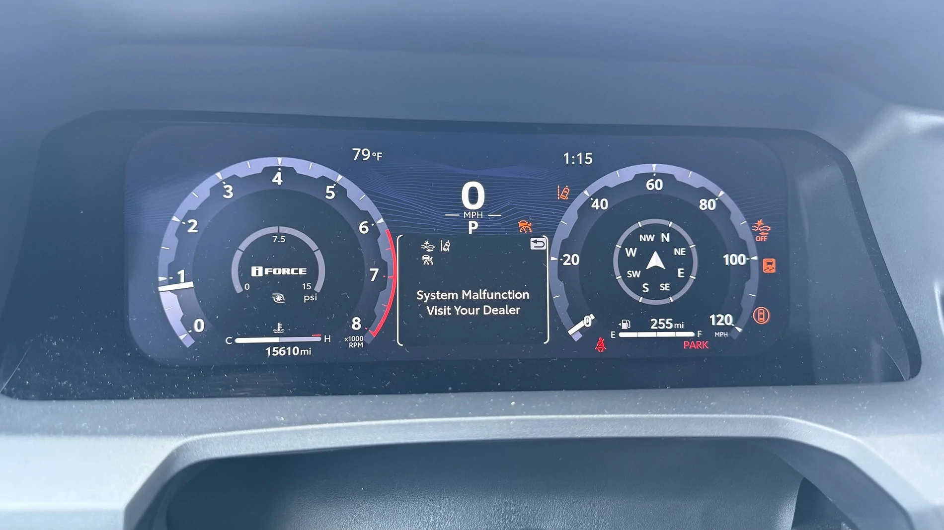

I just got done installing the Traxda 1" front lift (preload collar type). It's Sunday so I won't be able to get the alignment done until tomorrow at the earliest. I drove it around the block and multiple warning lights came on. Anybody seen this before?

More than likely will need a recalibration of the ADAS system. I've seen some lifts cause this, not for that little of a lift though. Might try disconnecting the battery for a while and see if that resets the system.
If you didn't disconnect the battery when installing that might be what caused it.

Unfortunately Maxx75 is right, if the pickup was “awake” when you jacked it up to install the lift it may have caused the problem, if your lucky it might just need a code reset?

I took the truck to the dealership this morning. They did a front alignment but that didn't clear the errors. They ended up needing to do a "hard reset" on the computer to clear it out.
When I was disassembling to remove the shock, I didn't think to index or mark the eccentric cam bolts on the LCAs until it was too late. So the steering was WAY off once it was all back together.
The Toyota tech said the alignment being so far off was the cause of the errors.
Moral of the story: Mark those bolts!! LOL
