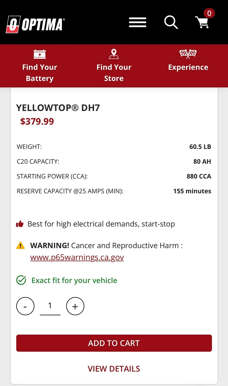

Lauren,
Are you replacing your OEM battery with an Optima battery and, if so, which one. Not sure if Toyota will/ can add an alternator to the 24 TH but I am asking tomorrow at Oil change. Also interested in when and where you guys will be wine tasting at HipCamp in couple of months. Might be when we are in area.

Lauren,
Optima Yellowtop DH7, rated to 880 cca, pic attached.
