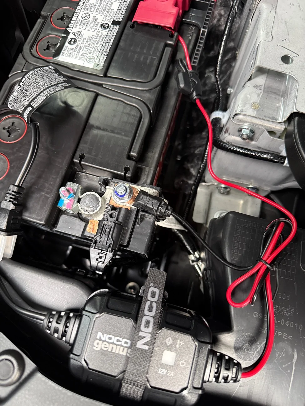

Whenever I test the battery with a test monitor, it always says “Battery good, recharge”. SOH is about 91%. Voltage usually 12.1-12.2v. I installed one of these chargers, and will plug it in if the truck sits for more than a week. Just another rinky dink task that’s part of owning this truck I guess….to overcome Toyota’s recurring stupidity.

I don't know if this is true, but charts I have seen say that a 12 volt is only 50% charged at 12.2 volts, which is what mine often is.

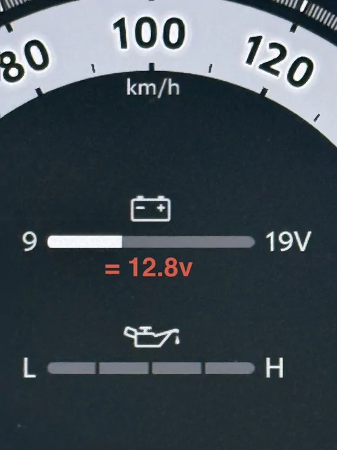

Confirmed with Carista, while driving. Spends majority of the time at 12.8v...
In my experience, vehicles with a traditional alternator will keep the battery at 14v +...or 13.8v. Never 12.8v. That would indicate your charging system isn't working. So, having said that...this is an extremely weird charging system logic that toyota has programmed in these hybrid trucks. No wonder the batteries fail.

Yes, strange charging system in the hybrids. My truck jumps from its resting SOC to the low 14V range when I first start it. Then it fairly quickly drops down 12.8V and mostly stays there, so it is not a surprise that hybrid 12V batteries have short lives. I guess as long as they last for the 24 month warranty Toyota doesn't care.
When I complained at my dealer, a lady with a good solid couple months of service advisor experience told me I don't drive it enough. I said even after driving it all day it is still not fully charged, which tells me the charging system is inadequate. She then told me I needed a trickle charger, and I have never gone back. I don't have to drive an hour to get lied to by some fat chick who has no clue about automotive electrical systems. Bottom line, neither the dealers nor Toyota give a crap and we are on our own.
I just gave up and I put a trickle charger on it every week or two and now its resting SOC is usually between 12.3V-12.5V, so maybe 70-80% charged. That is better than what it can do on its own, but it is never fully charged unless I leave it on my maintainer whenever I'm not driving it. It looks like it is working as designed to me, but it is just a crap design.

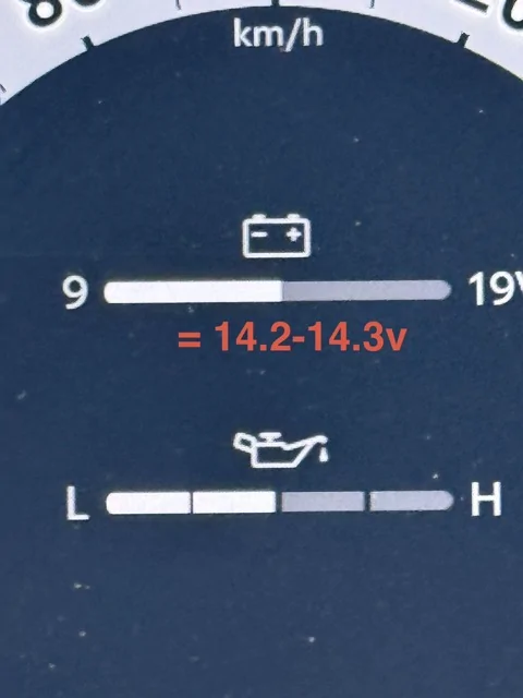

Just drove 30 minutes stoplight / highway mix and 30 back. Voltage was 13.9-14.2v going up, steady 14.2v going back, 2026 Trailhunter 1,082 total miles.
You would have an alternator on yours, being a 2026. So maybe it does make a difference, and charges “normally”
A different though, if OTT coded their hybrid tune to fix the charging logic…I’d be interested
