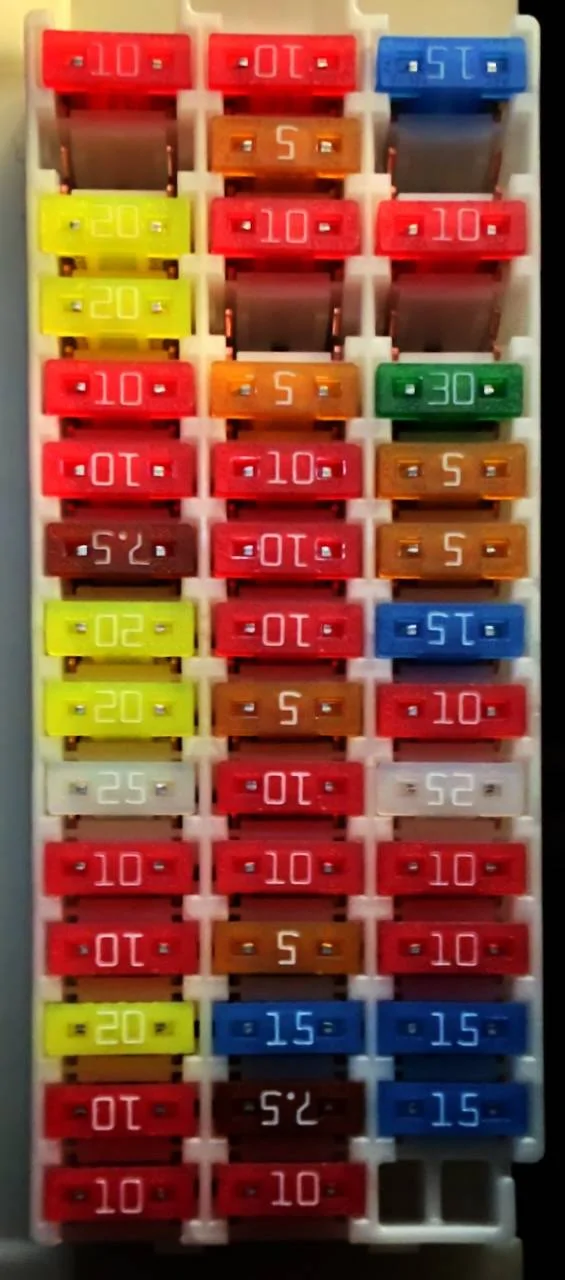

In-cabin Fuse Panel
2024 Tacoma Fuse Panels (Photos) in 4th Gen Tacoma Limited Hybrid Cabin Fuses

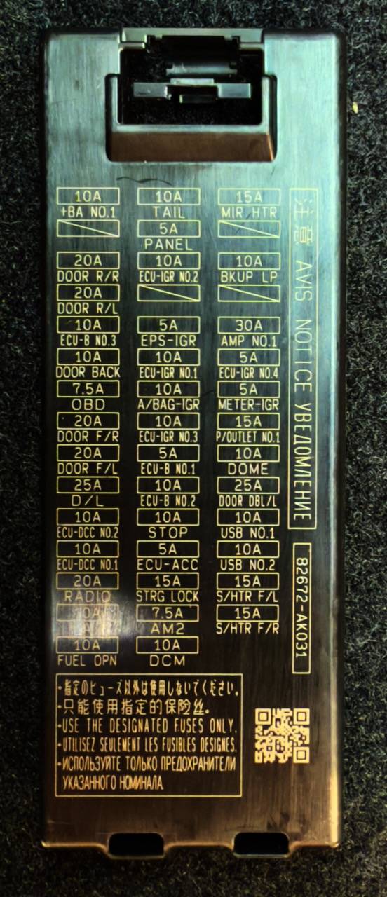

2024 Tacoma Fuse Panels (Photos) in 4th Gen Tacoma Limited Hybrid Cabin Fuse Legend

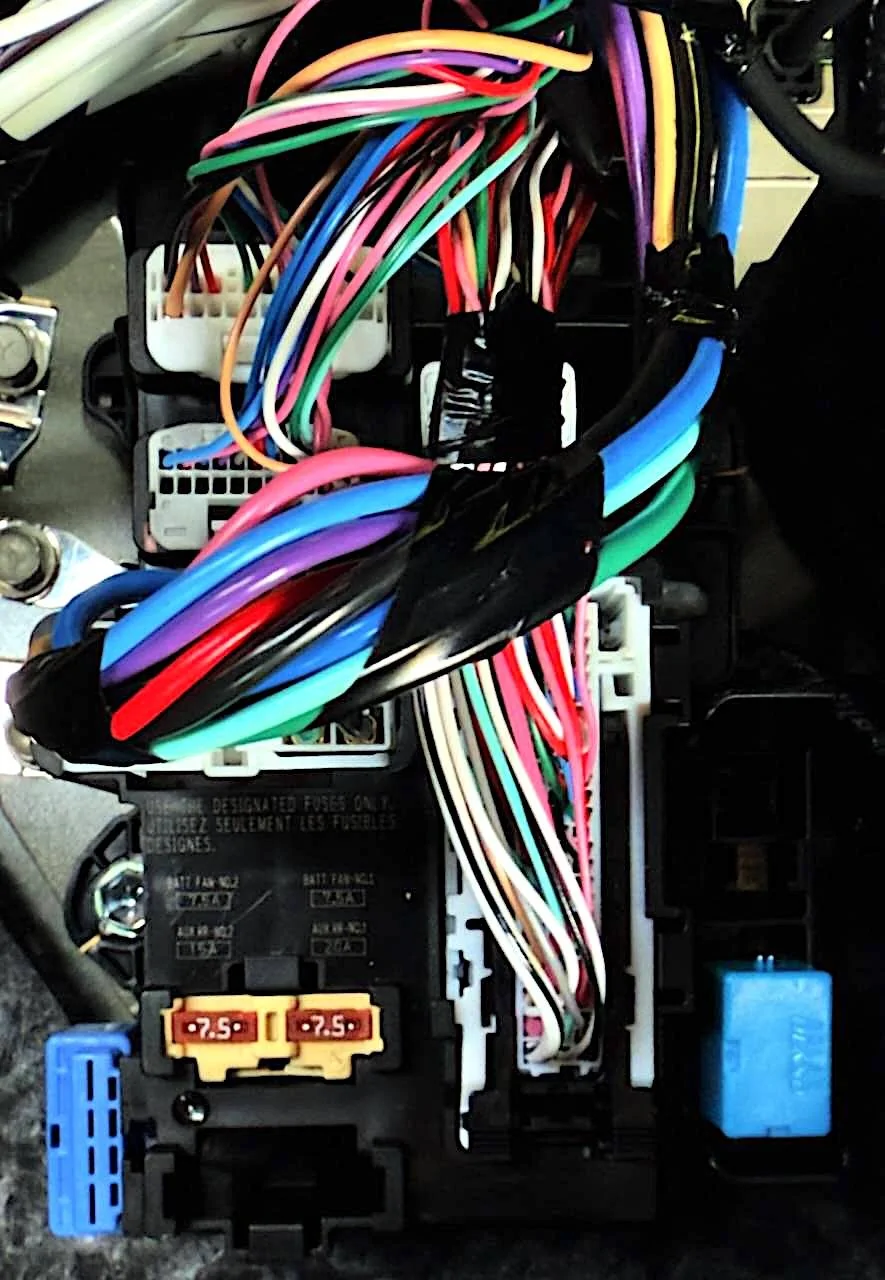

Under back seat fuses - Passenger side
2024 Tacoma Fuse Panels (Photos) in 4th Gen Tacoma Limited Hybrid Underseat Hybrid Battery Fus

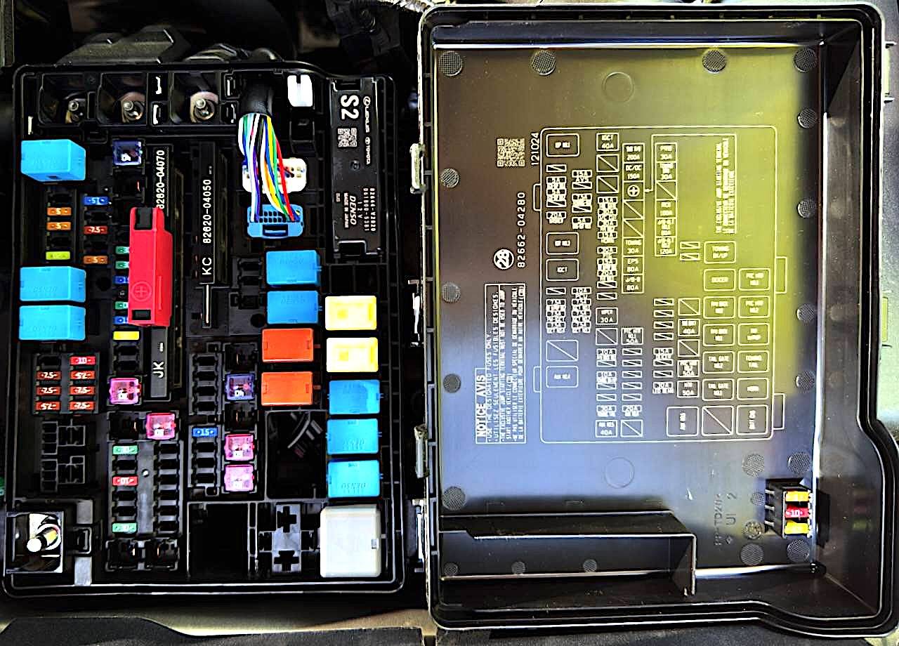

Passenger side Engine compartment
2024 Tacoma Fuse Panels (Photos) in 4th Gen Tacoma Limited Hybrid Passenger Side Fuse and Legend

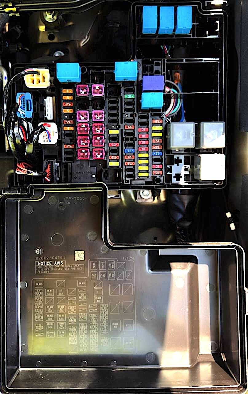

Drivers Side Engine Compartment
2024 Tacoma Fuse Panels (Photos) in 4th Gen Tacoma Limited Hybrid Drivers Side Engine Fuses and Legend

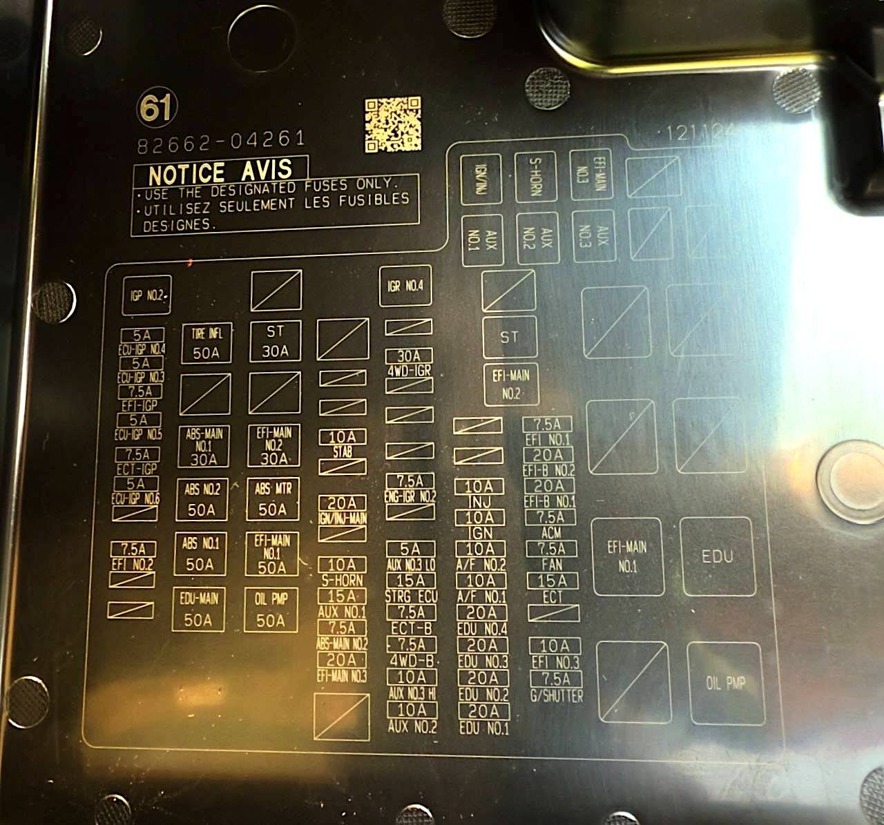

2024 Tacoma Fuse Panels (Photos) in 4th Gen Tacoma Limited Hybrid Drivers Side Engine Legend
