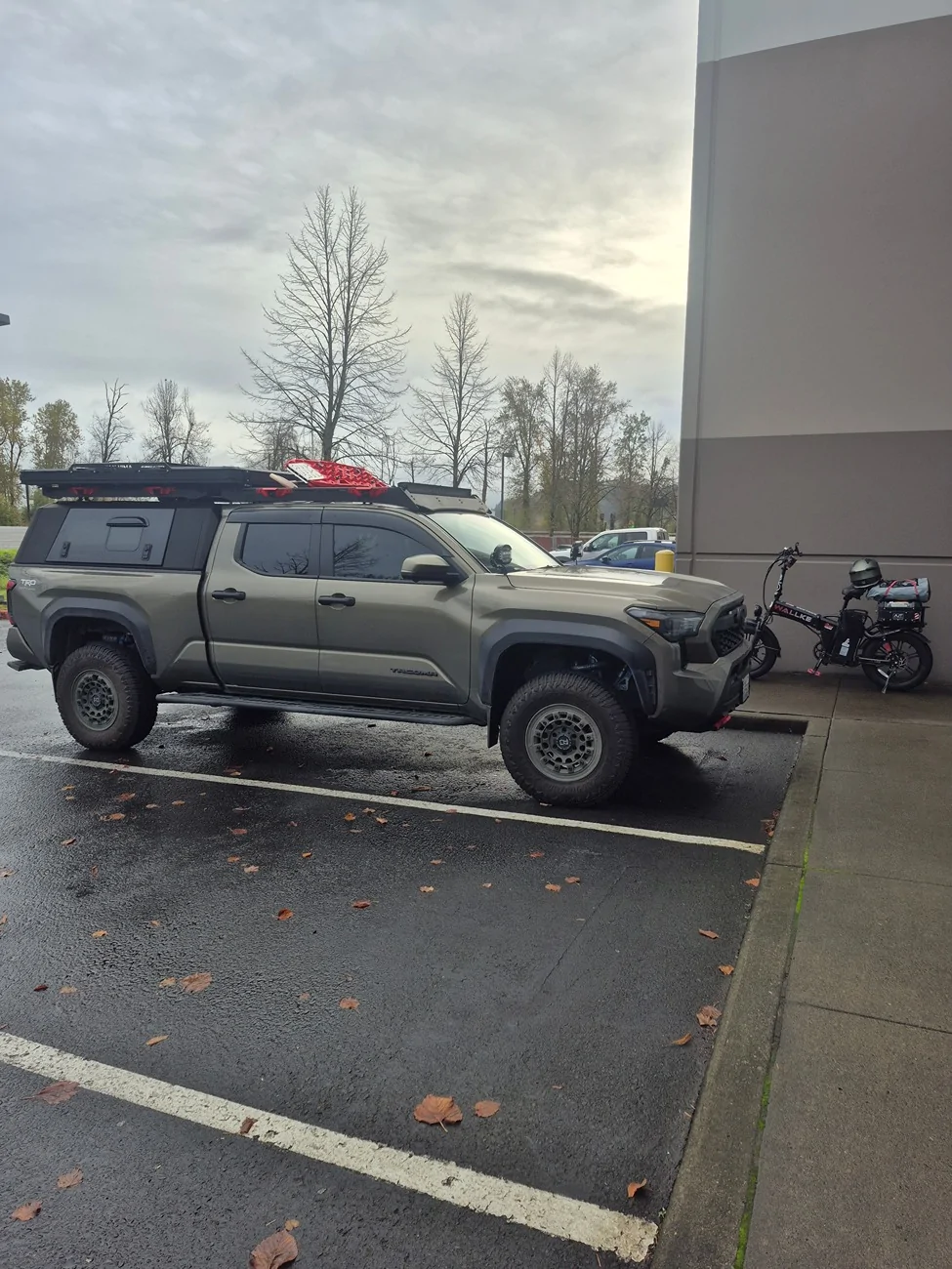

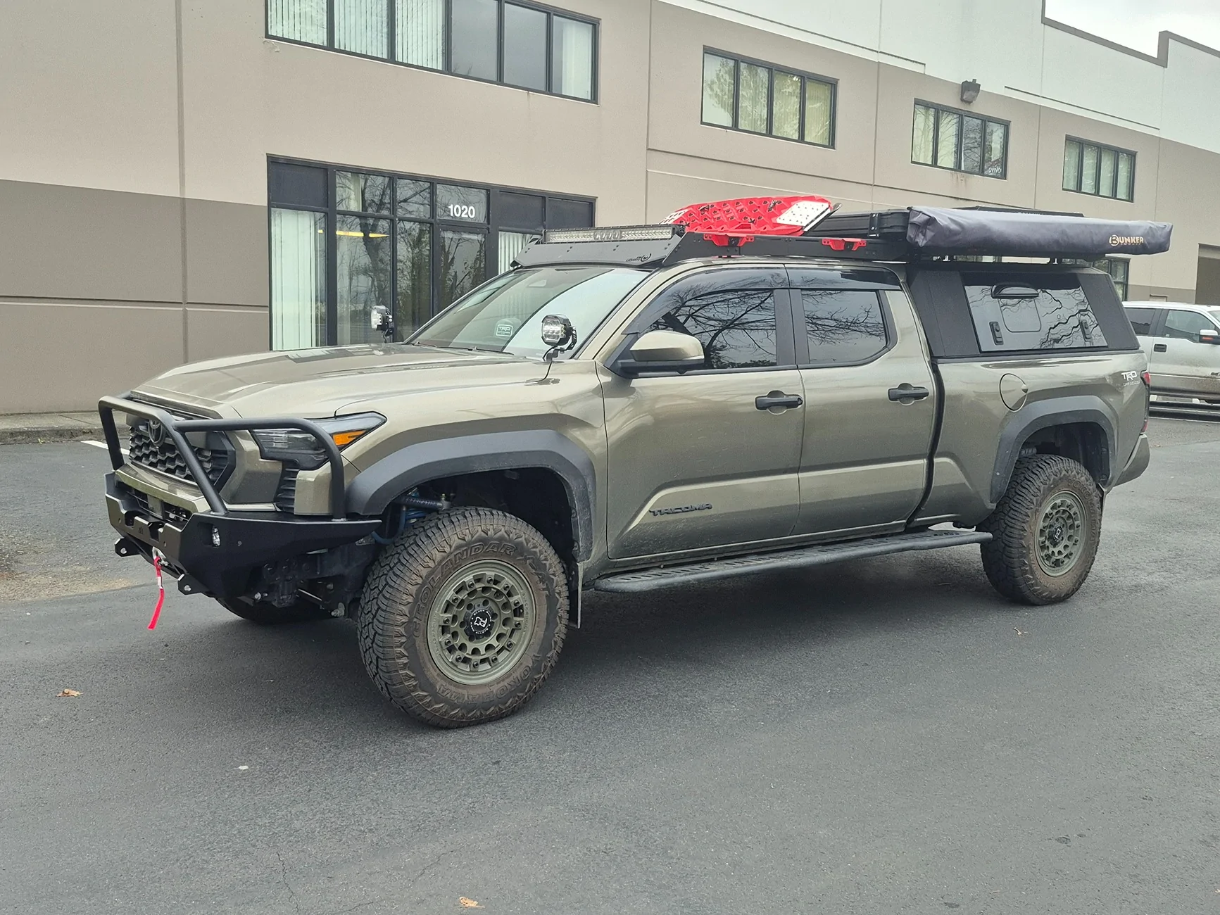

My goal was to lift the rear and level the truck after adding a bunch of weight, maybe with a tiny bit of rake. Stock springs were sagging pretty bad.
After talking with Dobinsons, they recommended C59-823V. Here is what they told me:
Hybrid models will yield 1" less lift
C59-823V (55mm - 2.25") 880-1210lb Load / (30mm - 1.25") 1400-1600lb Load
Which means I should get ~1.25" of lift, pretty close to stock Trailhunter rear height.
However after installing the springs and taking some measurements, I ended up with +2.5" rake. All heights measured from center of hub to fender:
Front: 23"
Rear: 25.5"
This is with 800lbs of constant weight. When we add our usual trip gear (2 eMTBs at 50lbs each + riding and camping gear), I doubt the rear will sag enough to level out.
I hope the springs will settle a bit after some driving but I doubt it. I might throw on a Peak Suspension or Westcott Designs spacer lift up front. Wasn't planning on lifting the front but at least spacers are cheap and I can always remove them later if I add more weight to the rear.
2024 Tacoma Dobinsons C59-823V coil springs installed on Trailhunter with 800lbs constant weight, 2.5" positive rake 39777-c032c342c9416a2ab0394ab4360cfcd8

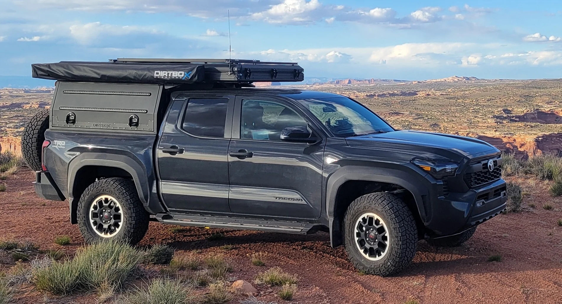

Interesting. When I talked with Dobinson about my truck they told me I needed the 819's. I installed the 819's, and they were a joke, so I installed 821's. Give me a break, so I installed their 1/2" spacer. OK, I can live with that, for now. I suspect the 823's are in my future, especially if I install an auxiliary fuel tank.

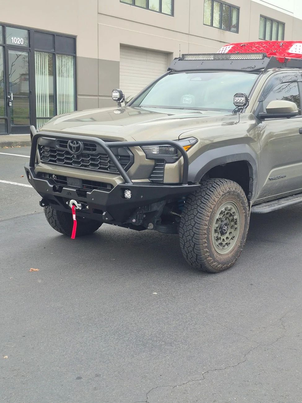

I replaced my suspension with Total Chaos UCA’s and Full King coil over suspension and Dobson 819 rear springs. The 819's are good for my constant weight of 900 to 1000lbs in the rear.
BUT, UGH
after having PACIFIC UPFITTERS in Troutdale Oregon install a Backwoods Adventure high clearance overland bumper with a Warn 12k winch, along with a full set of RCI skid plates, and a set of 8 Diode Dynamics rock lights i have lost a lot of the control in the front, due to the 150lbs of bumper and winch.?
I will be replacing the front king coils with heavier rated ones from King.
The truck sits at 6200lbs and even now handles amazing
Before and after surgery
BUT, UGH

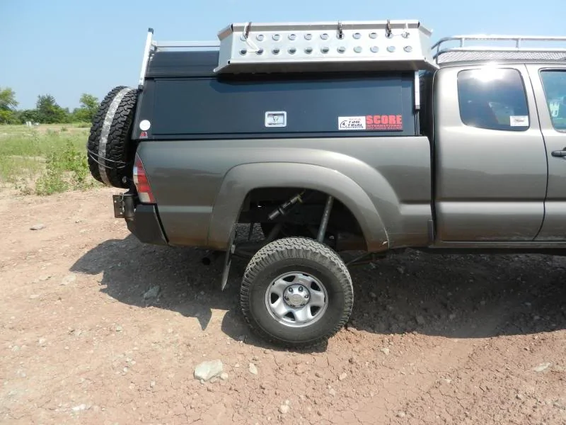

I remember the simpler days with my 2010 SR5...
Simple 10-pack leafs rated 500 lbs and EMU springs up front 200 lbs running 285's on 16's...
Our old Baja truck had National 10-pack leafs...

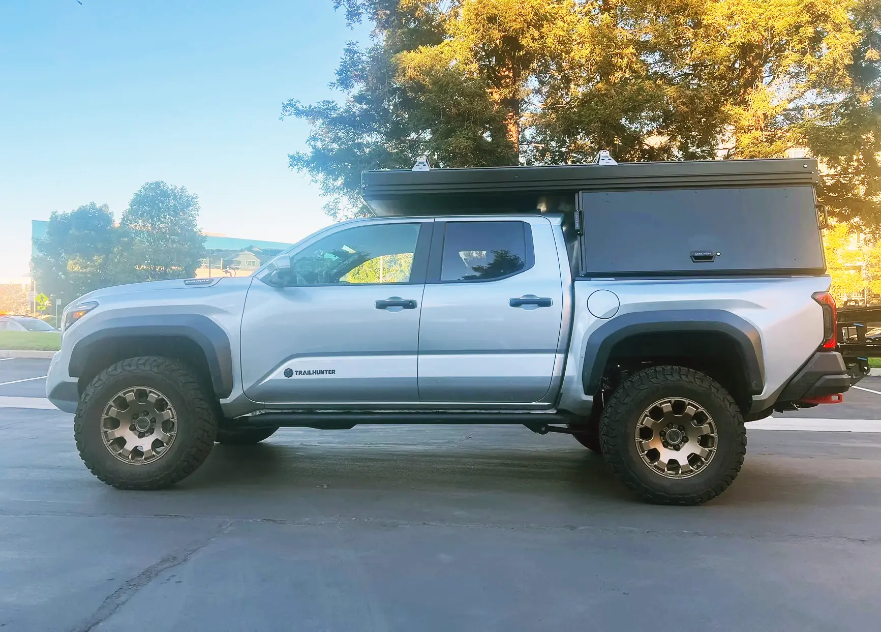

I have the same setup as you - almost. (6’ bed for me, but otherwise identical! Love the LP)
I ended up with the 821s so a little less stiff I think? They’ve been great and my truck looks like it did stock. Or damn near close to it. I think we are running a similar constant load? My drawers are so heavy but I love them.
But I’m not sure the 823 was an option either when I snagged mine six months ago? Hm. Because they recommended the 821s to me at the time. Would it help if I took a pic or measured my rear as a comparison at all? Tbh I’d rather swap the coils to something closer to what I’m looking for vs putting in spacers in the front if they weren’t working out for me. I dunno if dobbinsons would let you do that though or give you a discount etc to swap if you wanted.
Have they settled a bit?
It would help so much if you can measure both front and rear! 🙏
They have settled exactly 1/2" on both sides.
After driving 500 miles and some light offroading, I do think the 823 is the correct spring rate for my load. The rear feels plush, less bouncy, and articulates nicely. I just don't like the rake, and realistically I won't ever carry enough load to level the truck.
