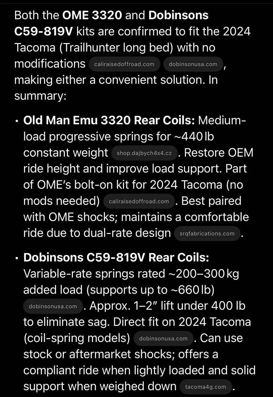

Open Ai deep research yielded this. Anyone installed any of this equipment? Ride quality? Cheers

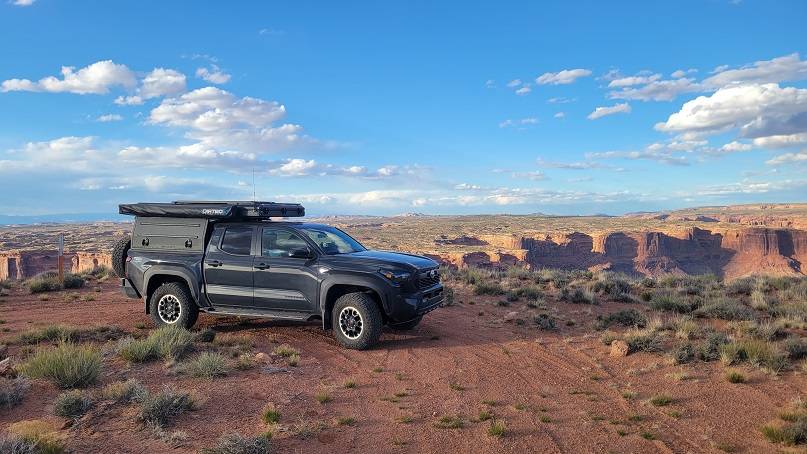

I have more weight than you do. Lots more. I installed the 819V springs in the rear on Dobinson's recommendation, and they compensated for the weight, but I didn't get the lift I wanted. The 819V were pulled and I installed 821V and it's better, but still not where I want it. I think the weight recommendations from Dobinsons is optimistic. Here is what Dobinsons says about their rear springs:
Rear Coil Spring Specs:
  • C59-869V (30mm - 1.25") Stock Load / (Stock Height) 50-100lbs
  • C59-817V (55mm - 2.25") 50-100lb Load / (30mm - 1.25") 175-330lb Load
  • C59-819V (55mm - 2.25") 175- 330lb Load / (30mm - 1.25") 440-660lb Load
  • C59-821V (55mm - 2.25") 440-660lb Load / (30mm - 1.25") 880-1210lb Load
  • C59-823V (55mm - 2.25") 880-1210lb Load / (30mm - 1.25") 1400-1600lb Load
  • C59-825V (55mm - 2.25") 1400-1600lb Load / (30mm - 1.25") 1800-2000lb Load
My 819V are available if you want to chat.
Pic with the 819V. Camper-canopy: 450#. Rear bumper with dual swing-outs: 350#.

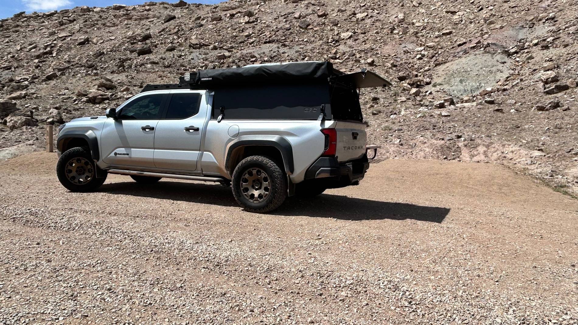

Dobson 819 rear coils i have them on my 24 Tacoma I'm not sure if they'll work with the trail hunter. I don't know why they wouldn't
