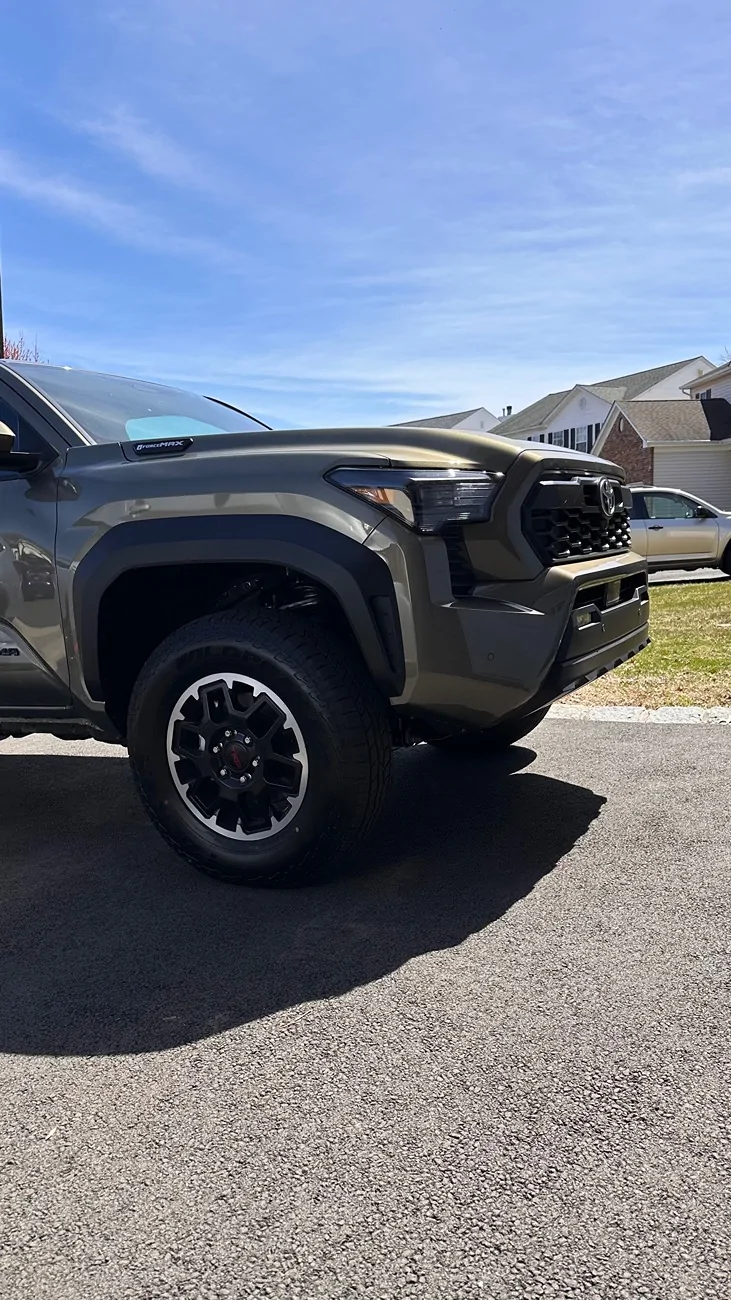

Okay so I’m wondering why everyone is going back to 17” wheels? Does it give you more room for bigger tires or what? I just picked up my 25 trd sport and was thinking of doing 18x9 +20 with a 1.5 level. I see everyone going 0 offset on 17’s running 285. Just curious
added a photo of my ride just because I wanted to

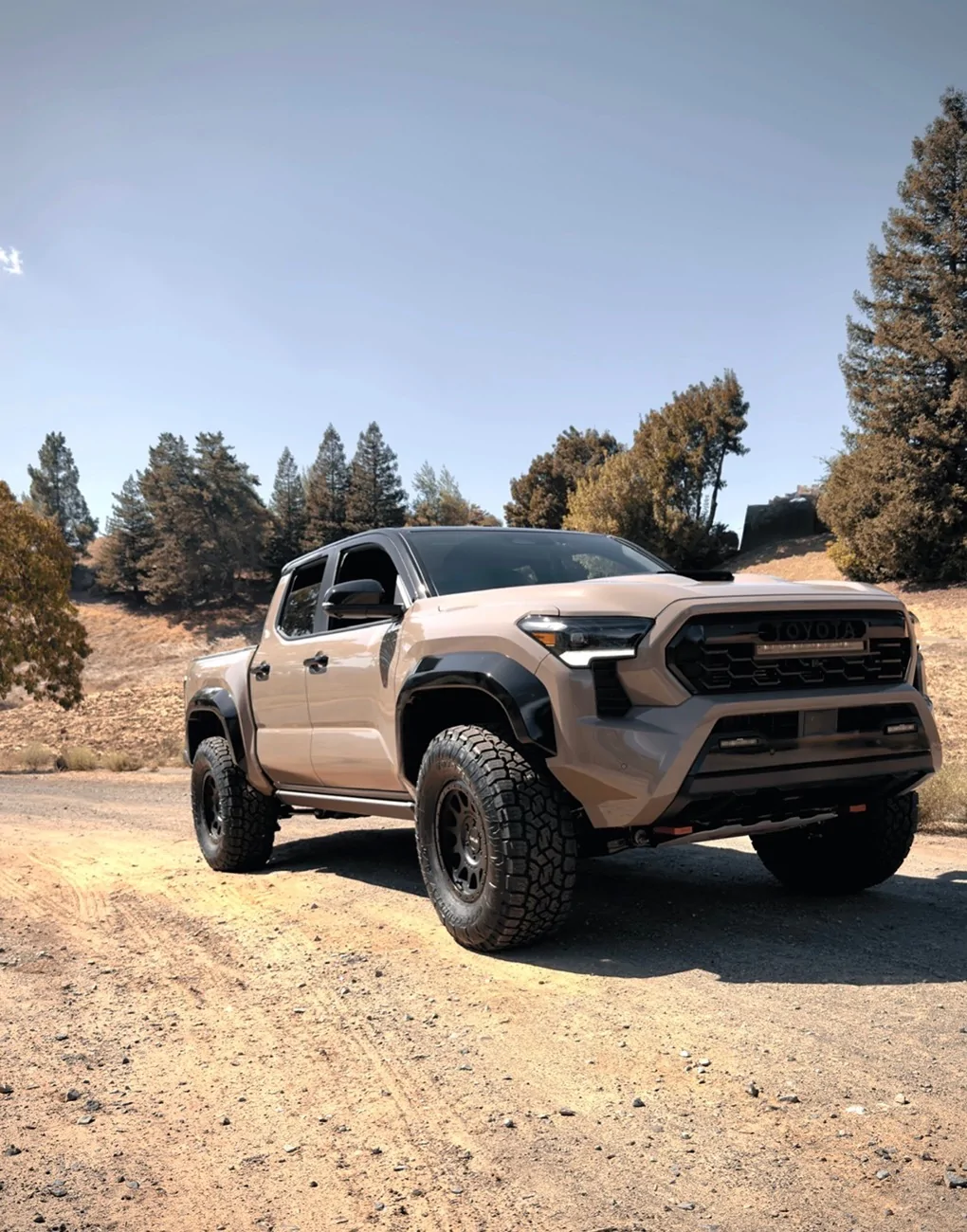

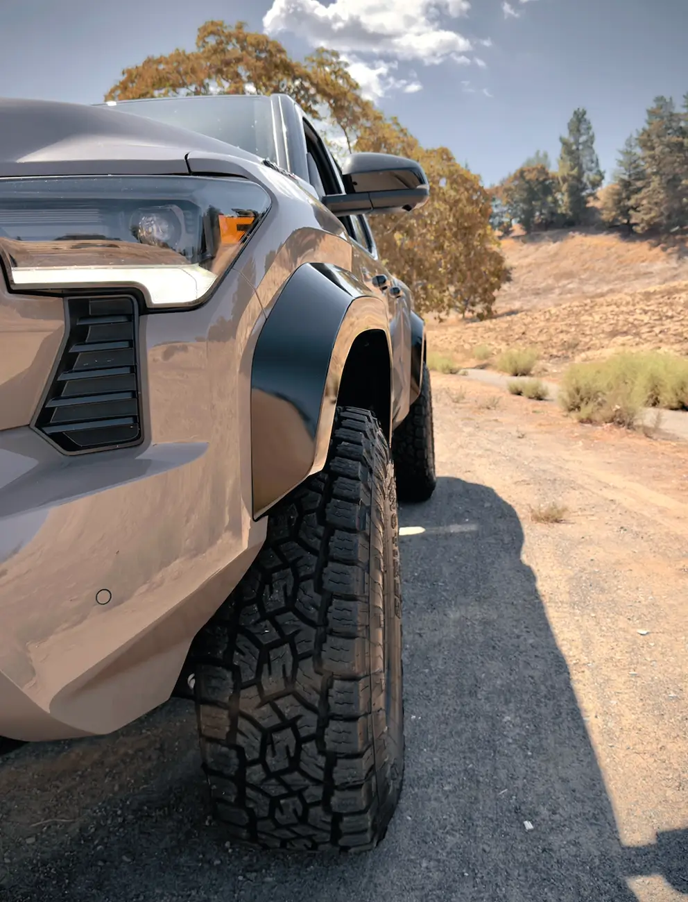

Lots of great input here and I’ll also add, I personally like the size of a 17” vs an 18” rim along with the amount of sidewall you get on the 17.
I know I won’t be doing hardcore off-road, technical routes or rock crawling. I will do dirt roads, fire roads, washboards and less technical 4x4 routes so airing down is important. Ride quality is important.
I didn’t go with a true 35x12.5 tire. They’re heavier and more expensive.
Offset is key.
Method 315 17x8.5 +25
Toyo Open Country ATIII 325/70/17

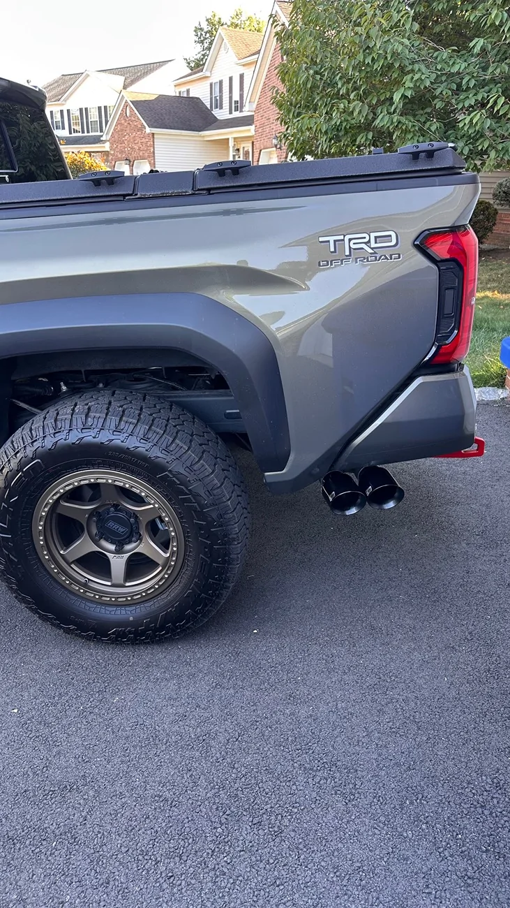

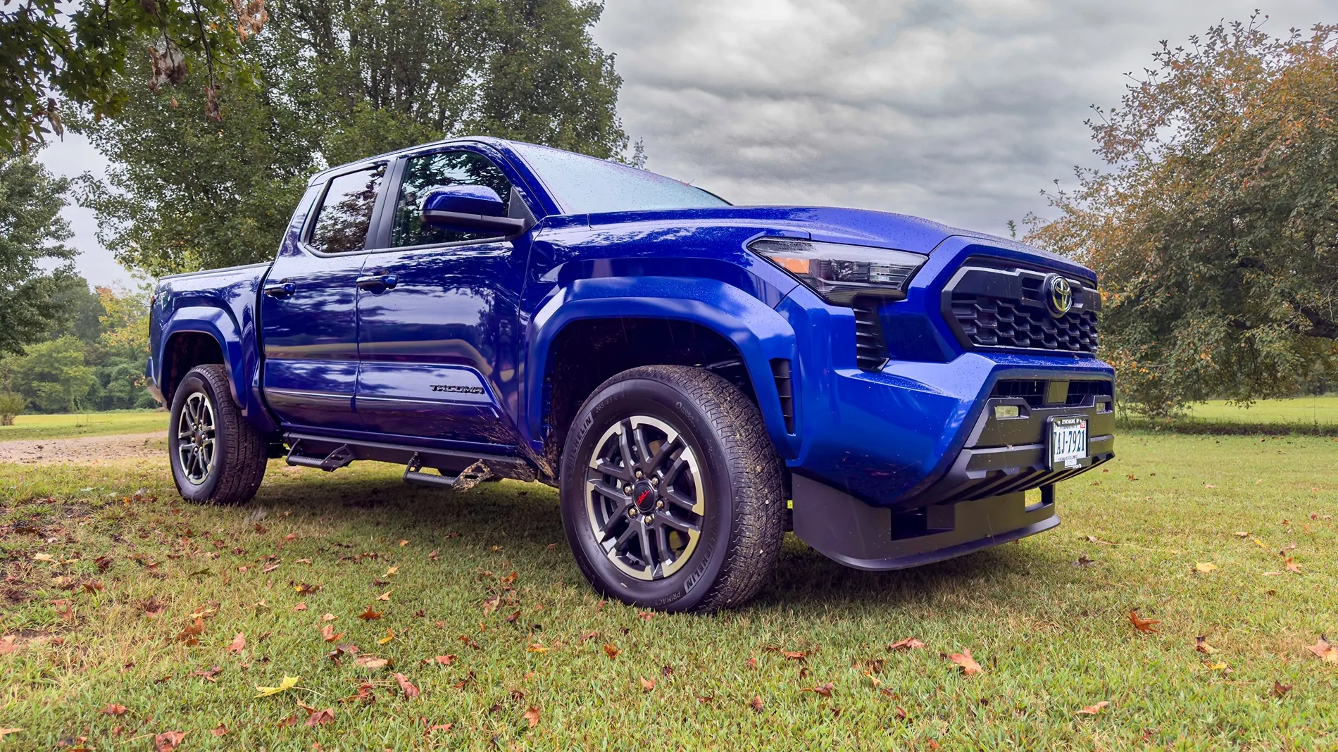

Doesn’t matter the size of the wheels is 18 or 17. 35” tires is 35” tires. Mine is a hybrid so it came with a 18” wheels. I went 17” for availability on aftermarket wheels is larger and more variety of selection of tire sizes.
Before and after.

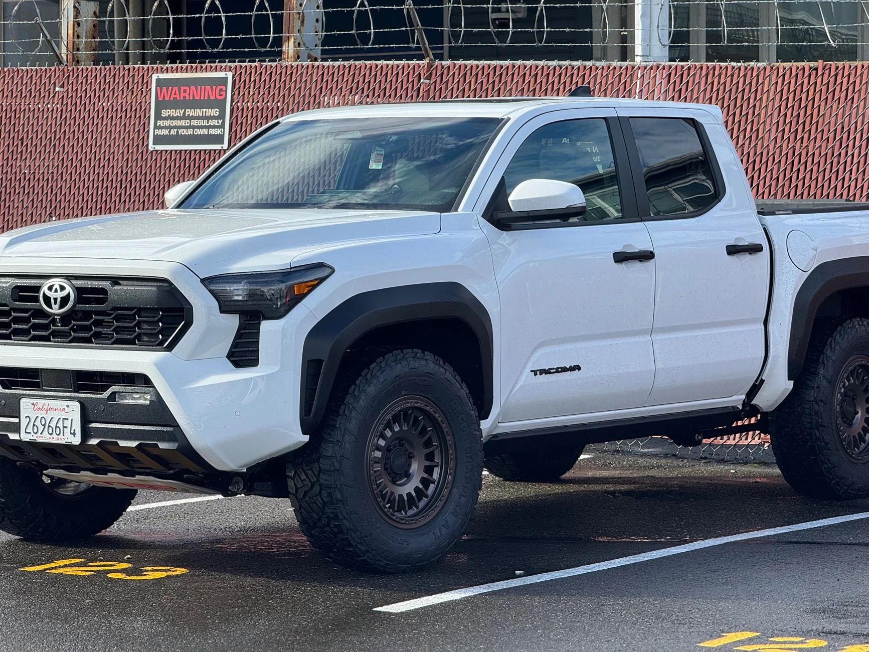

18” to 17” wheel change is only 0.5” difference side wall assuming same tire diameter. I find it hard to believe that will be a big difference in most real world scenarios. 17” wheels will likely offer more tire options, especially if going for 35” or larger. I swapped to 18” RRW wheels. With nitro Recon Grapplers 285/70 R18. Very happy with ride and noise levels on the road. Only 800 or so miles on the tires, but I am happy so far. Offset is +25. Zero rubbing and no mods to truck.
Picture for reference.
