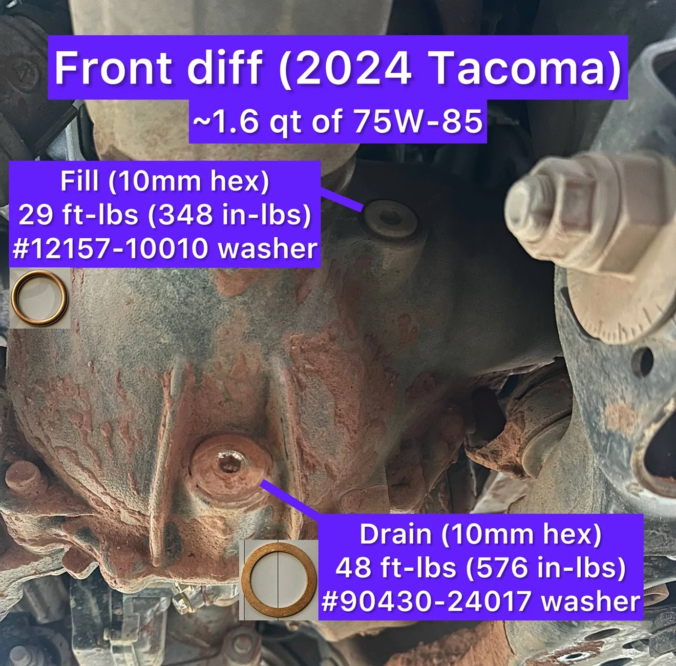

Front Differential
Approx 1.6 quarts of 75W-85 oil
BoltToolTorque SpecsCrush Washer Part #
Fill Bolt10mm hex bit29 ft‑lbs (348 in‑lbs)12157‑10010
Drain Bolt10mm hex bit48 ft‑lbs (576 in‑lbs)90430‑24017

FRONT DIFFERENTIAL
Video of front differential change:
2024 Tacoma DIY Front & Rear Differential Fluid Change Guide for 2024+ Tacomas front-diff
1. Remove Skid Plates
  • Using a 12mm socket, remove the 8 bolts securing the two skid plates.
    • Support the plates as you remove the final bolts—they can be awkward
2. Loosen Fill Bolt
  • Using a 10mm hex bit, break loose the fill bolt first
    • Always loosen the fill bolt before draining... If it’s stuck, you’d be unable to refill the diff
    • Do not fully remove it yet
3. Drain Oil
  • Place your oil pan under the differential
  • Remove the 10mm hex drain bolt and drain into pan
    • Dark oil with metallic shimmer is normal for diff fluid.
    • Remove the fill bolt to help it drain completely
4. Reinstall Drain Bolt
  • Clean the metal sludge off of the magnetic end of the drain bolt
  • Replace the old crush washer with #90430‑24017
    • Verify no old washer is stuck on the housing
  • Tighten the bolt to 48 ft‑lbs (576 in‑lbs)
5. Fill Oil
  • Add ~1.6 qt of 75W‑85 oil in fill hole until the oil slightly weeps out
    • It can be difficult to reach the fill plug, but it's possible to use the 1 qt squeeze pouches (I used those and it worked okay) or you can use a pump
6. Reinstall Fill Bolt
  • Replace the old crush washer with #12157‑10010
    • Place smooth side toward the differential housing; rounded/seamed side toward the bolt head
  • Tighten the bolt to 29 ft‑lbs (348 in‑lbs)
7. Reinstall Skid Plates
  • Using a 12mm socket, reinstall the 8 bolts holding on the two skid plates
    • You'll start by installing the rear skid plate first
    • Torque specs are not necessary, snug them well

REAR DIFFERENTIAL
Video of rear differential change: https://youtu.be/nmftL6F2O0g
1. Lower Spare Tire
  • Remove the tool kit from behind the rear passenger seat
  • Insert and rotate the tool through the rear bumper port to lower the tire fully, then slide it out
2. Loosen Fill Bolt
  • Using a 24mmsocket, break loose the fill bolt first
    • The fill bolt is located high on the rear diff cover
    • Loosen it first to ensure that refill won't be a problem
3. Drain Oil
  • Place your drain pan under the differential
  • Remove the 24mmdrain bolt and drain into pan
    • Expect a larger volume than the front (4+ qts)
  • Tighten the bolt to 36 ft‑lbs (432 in‑lbs)
5. Fill Oil
  • Add ~4.2 qt of 75W‑85 oil in fill hole until the oil slightly weeps out
    • Fill through the upper port using squeeze packets or a pump
      • The rear diff is very easy to refill using squeeze packets
    • The correct level is reached when fluid begins to overflow the fill hole
7. Reinstall Spare Tire
  • Slide the tire back under, align the cable, and crank it up until fully seated
    • Verify it is centered and snug
Final Checks
  • Wipe down all components and confirm no leaks.
  • Dispose of old gear oil properly (O'Reilly Auto / AutoZone / etc accepts it for free)
  • Test drive for several minutes, then recheck for seepage.
Notes & Tips
  • If a washer seems missing, it's often stuck to the housing. Remove it gently.
  • You can do the entire job without lifting the truck, but lifting improves access.
  • Slight metallic fuzz on magnets is normal; chunks are not.
I've also got this guide posted on my website: 4th Gen Toyota Tacoma (2024+) Front & Rear Differential Fluid Change | Taco Tunesday
