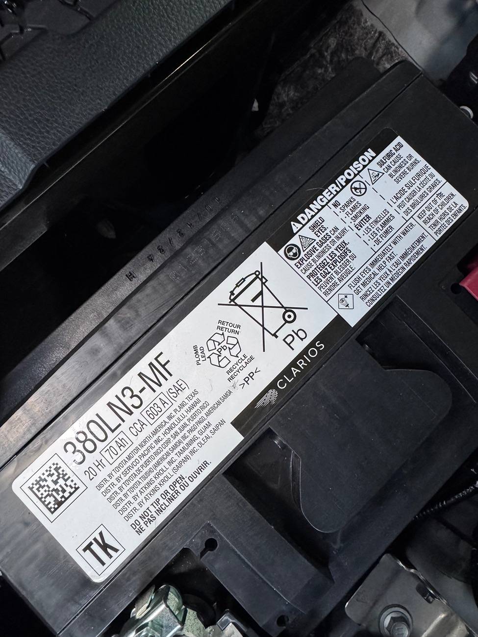

What battery did they replace it with? If you have the capability, could you take a picture of the new battery?
This is the one my 25 came with
