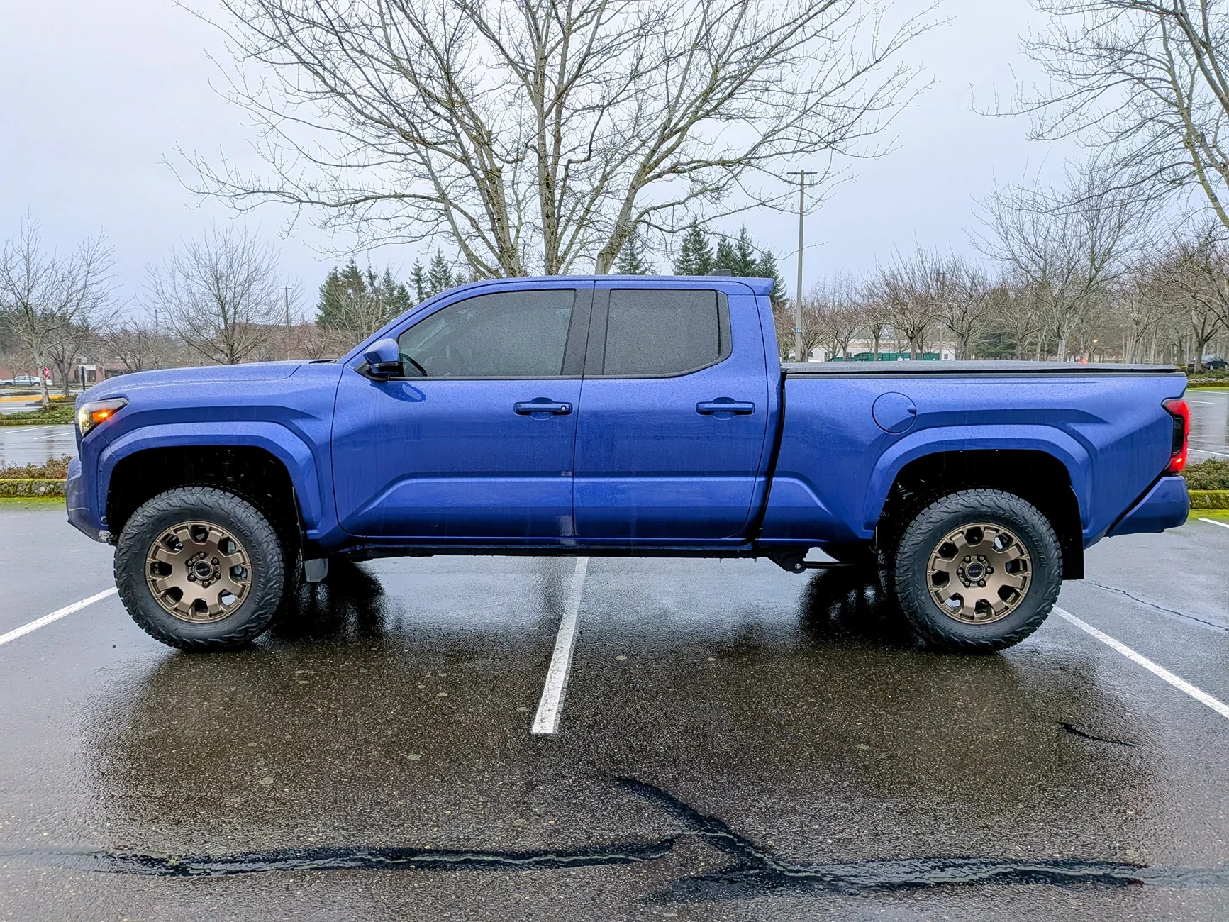

Sorry off topic, but As promised: 5100s @ the 2nd circlip setting up front. Was hoping for a bit of rake as it was supposed to be 1.4" (measured 1.75" difference with factory suspension) but leveled it perfectly. Not sure I'll lower it or add rear spacers because it looks BAD ASS
2024 Tacoma Factory Lift Kit for 4th gen Tacoma are discontinued? PXL_20260131_003655384~2

looks great. I’d add the rear spacers. I wish with my TRD Bilstein lift, I could add a 1/4” top plate and rear spacers to bring it up just a tad. I’d leave it…..

I don't get why those settings are so far off. @magicandlouis had a similar issue with the 5100s. .35" discrepancy ain't nothing! But it is perfectly level with a full tank of fuel.
Anyways, I'll chat about this somewhere else and try to keep this thread on topic 😂
2024 Tacoma Factory Lift Kit for 4th gen Tacoma are discontinued? PXL_20260131_004214604

Looks great, definitely making my pockets burn looking at it.

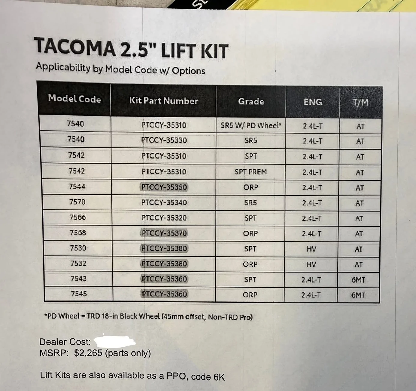

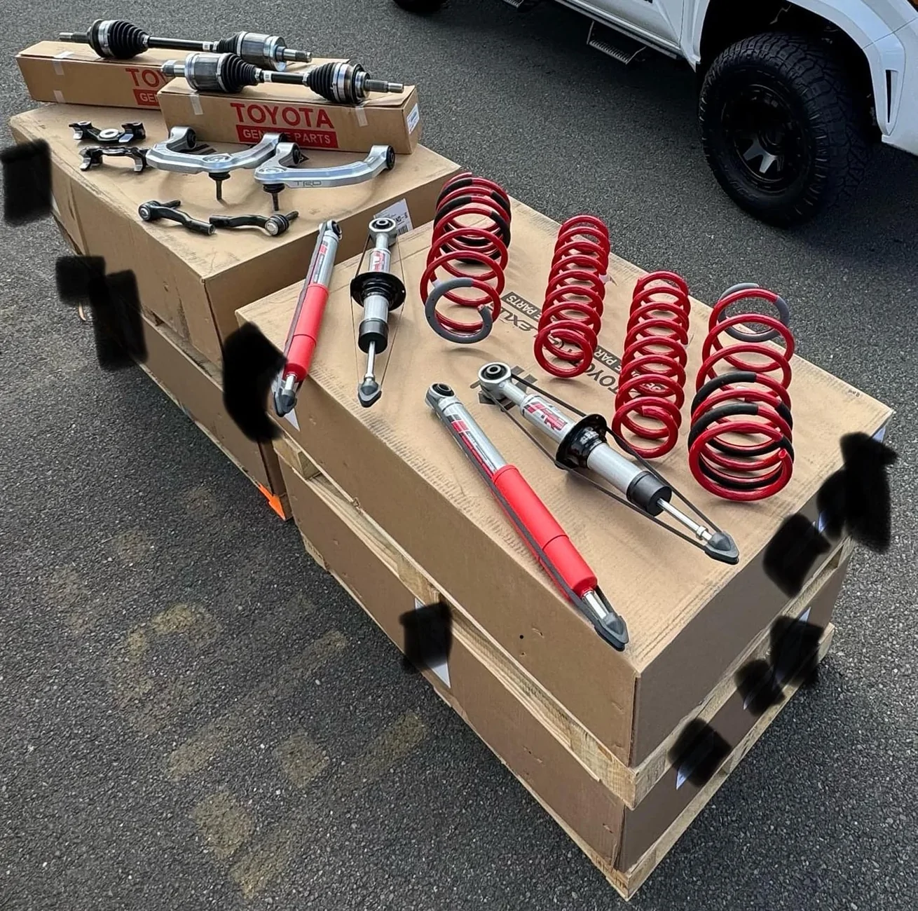

My parts guy has let me know that lift kits are available to buy. I saw this on the Facebook 4G group.
With the current 15% Presidents Day sale my dealer quoted me $1,597.00 out the door for the parts only. Can anyone tell me what is exactly in the kit? Would be all the parts shown in this picture?
2024 Tacoma Factory Lift Kit for 4th gen Tacoma are discontinued? Tacoma Lift Kit Releas
2024 Tacoma Factory Lift Kit for 4th gen Tacoma are discontinued? Tacoma Lift Kits
2024 Tacoma Factory Lift Kit for 4th gen Tacoma are discontinued? TRD Tacoma Factory Lift Kit

Toyota doesn’t give a breakdown on the parts list on the sales sheet, just TRD lift. From everything I read pertaining to the kit, its shocks and springs, billet UCA’s, extended axles, etc. I see a couple other smaller parts in the pic near the UCA’s. Not sure what it is. Another thing people don’t know is if the kit comes with a diff drop. That apparently is needed when you lift 3”. I’d like to think Toyota was proactive and included it. However , id say the pic accurately reflects the kit.

I am going to see if my parts guy can get a break down. You feel that the CV axles are included in the kit then?

According to everything I have seen, yes.

Those brackets in the picture by the upper control arms look like the mounting brackets for the lower control arm. Probably slightly reshaped to account for any change in angle. Diff drop is not usually included because Toyota replaces the axles with axles designed for the extra angle and articulation.
