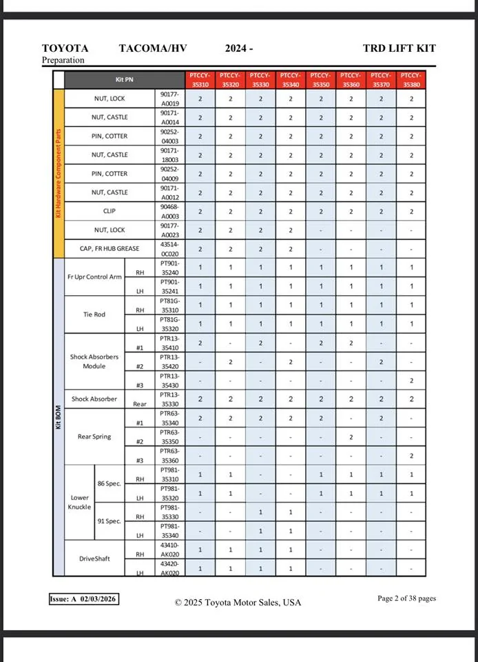

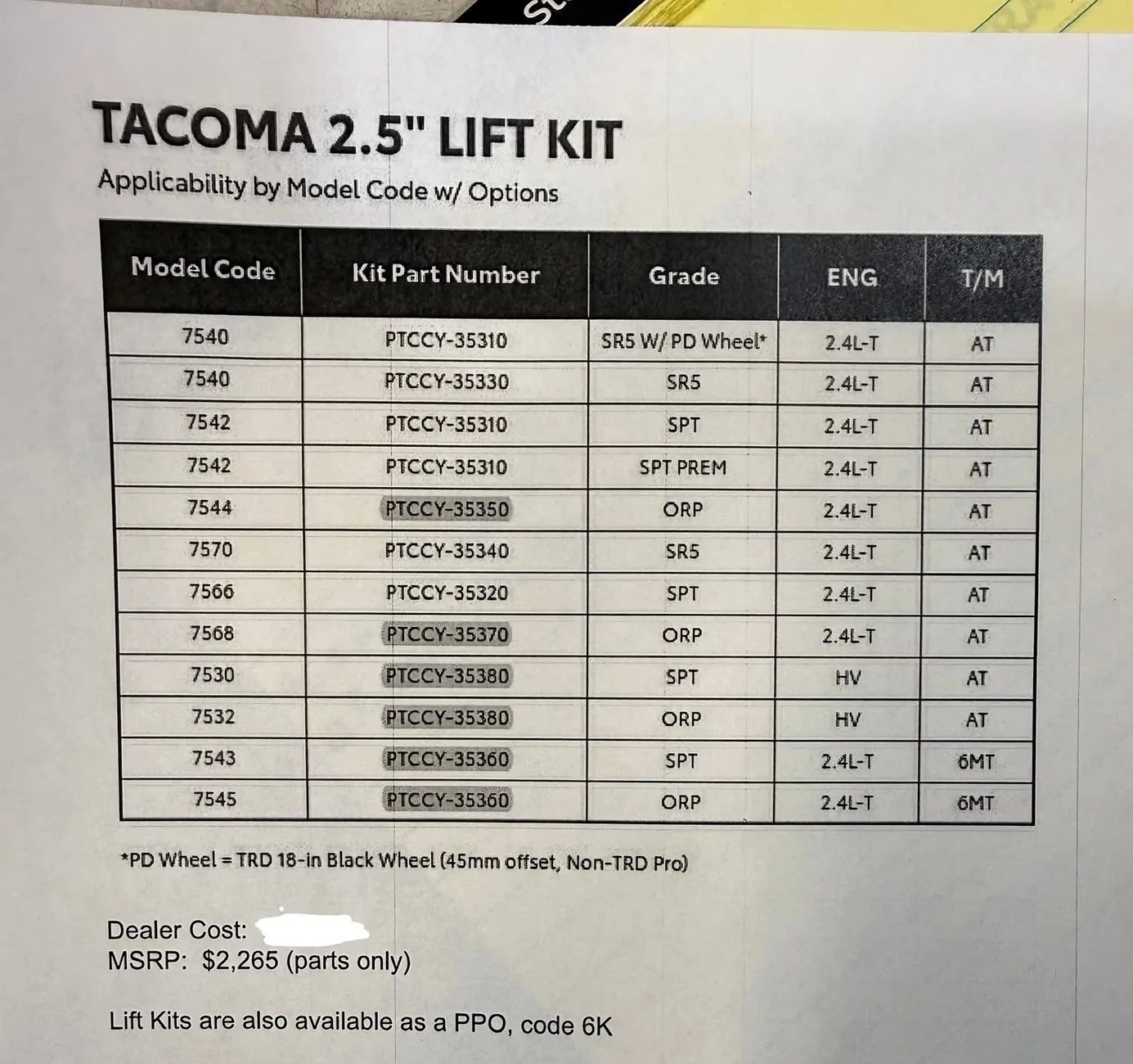

I just want to clarify please. If you currently have an Off-road without the factory lift, you will not need CV axles (Drive Shafts) because they are long enough. They are the same exact axles if you order your truck with the lift installed at the factory.
I proved this to myself by crawling under an Off-Road truck with and without the lift. Same tags and part numbers are on them. You can see by the attached images here that the only trucks that will need the CV axles (Drive Shafts) in the new lift kit are SR-5's & (1) Sport trim model. (35310 thru 35340). Folks with Off-Roads models and some Sport models will not need new CV axles
(35350 thru 35380). This is why they are not in the new kit.
Like you say this will make the kit a little cheaper to buy. Images curtsey of other members.

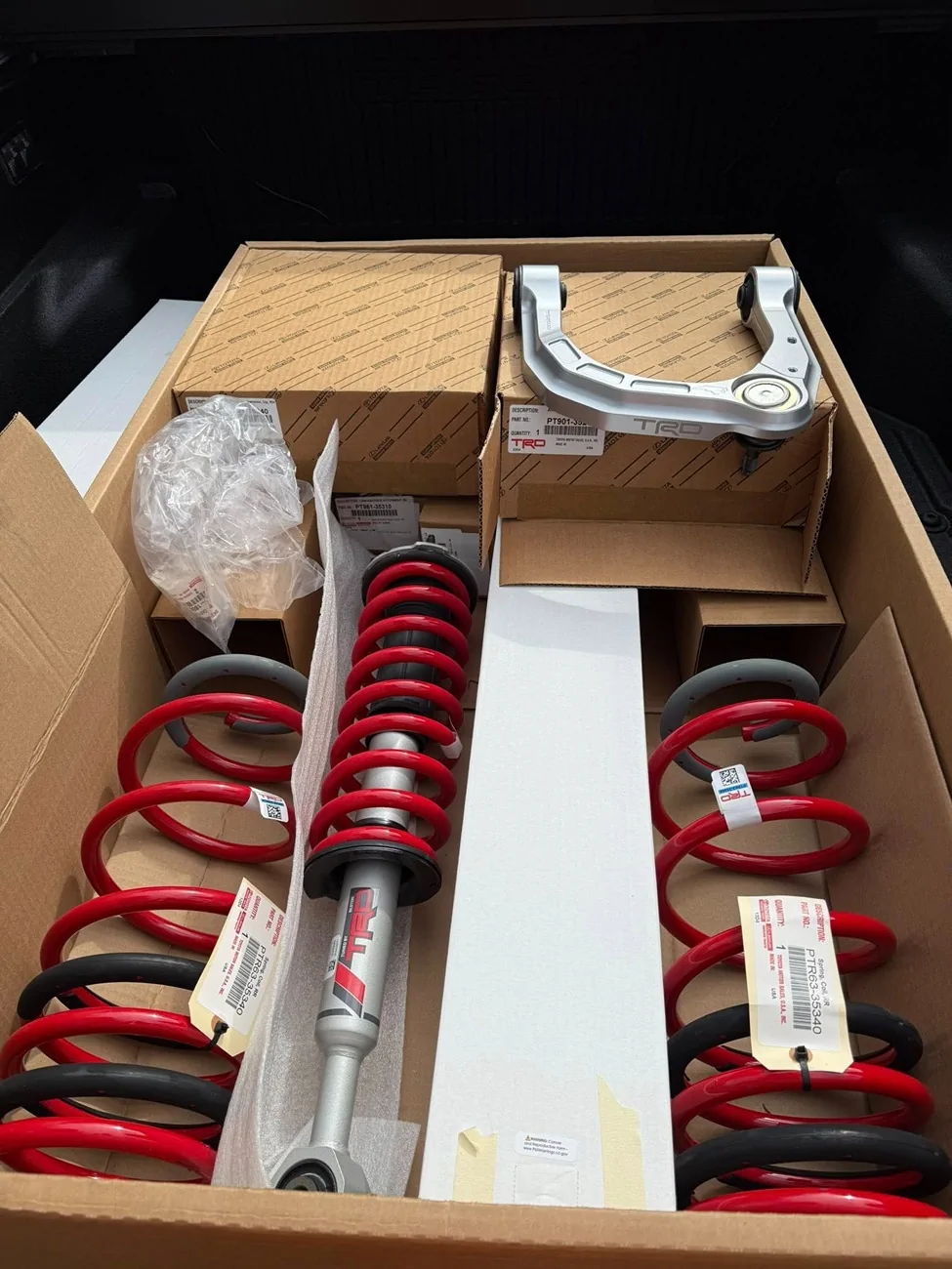

Oh nice an actual parts breakdown. Been wanting to see one of these. I kind of figured it would at least come with new tie rods and the lower knuckles to adjust the control arm angle.
