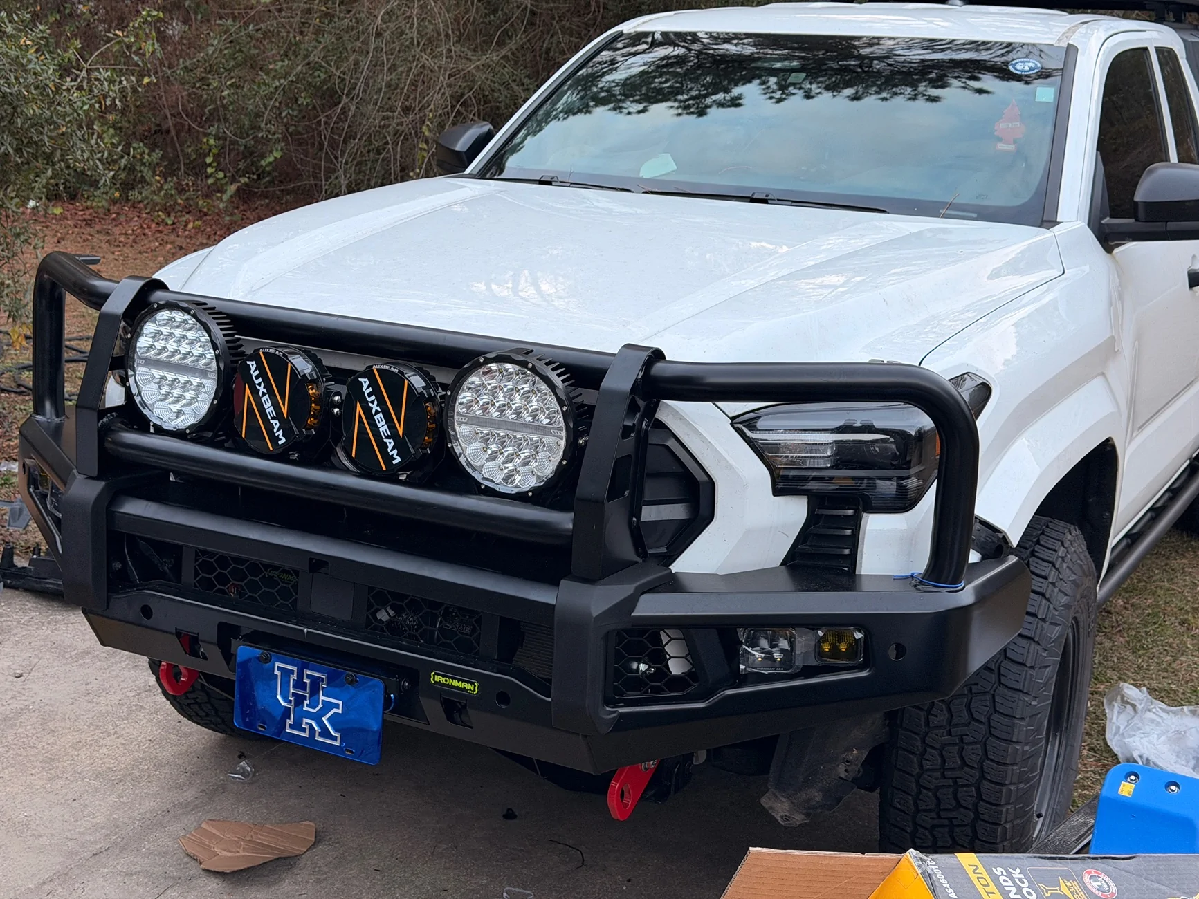

Well at least you have options. As for the owners of Gen 4 tacoma SR we get no options. One dealer said only businesses are buying the SR and not interested in making leaf springs for lift. Sadly I bought the Tacoma because I knew I could buy aftermarket products and sadly am limited because I own an SR. Oh well, don’t take my money
2024 Tacoma Factory Lift Kit for 4th gen Tacoma are discontinued? IMG_6196
