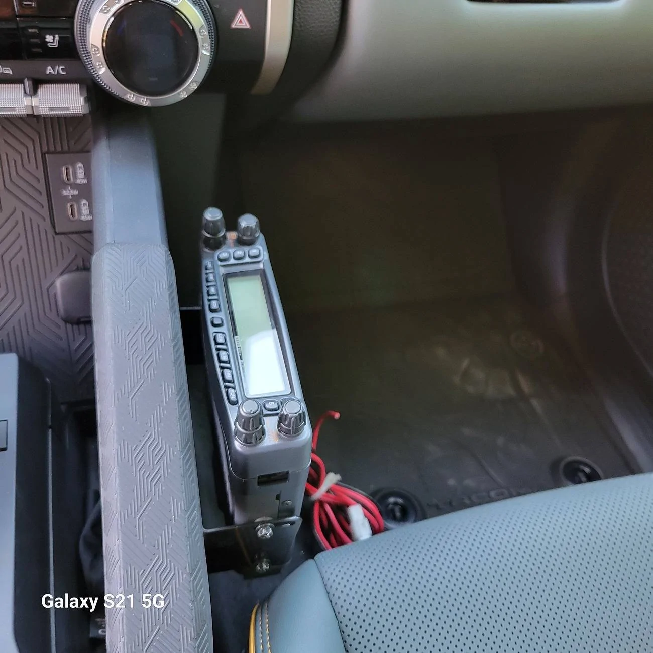

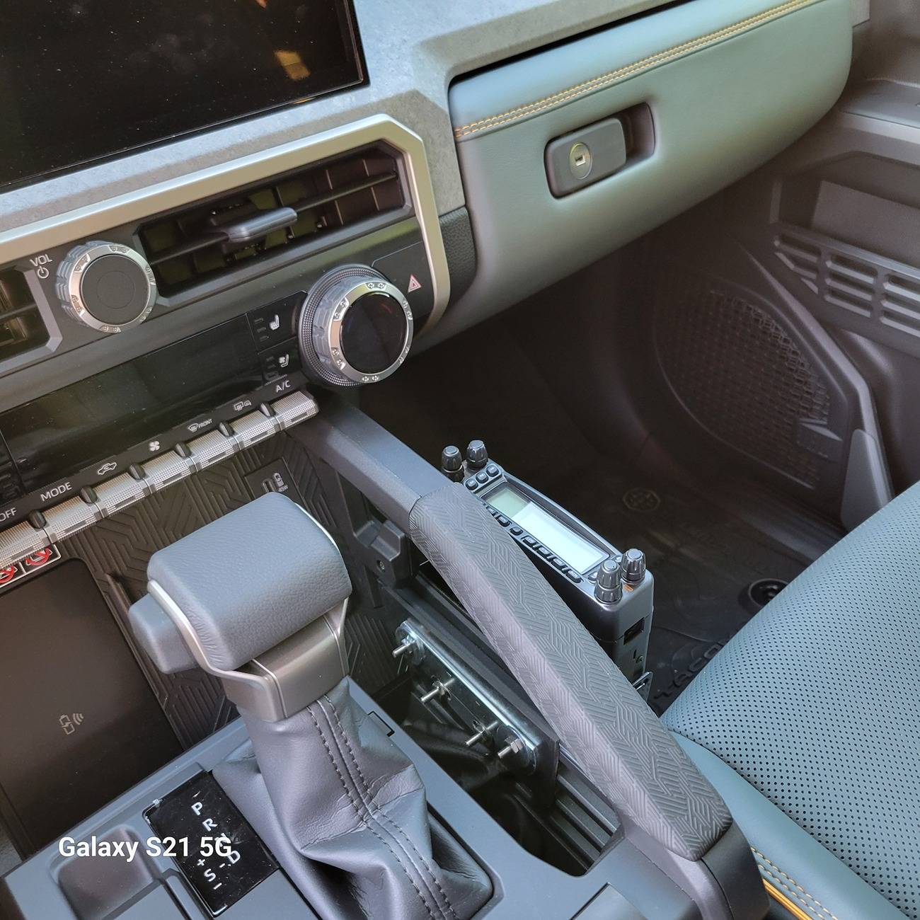

Thanks, very aware of the Commifornia law on this. I'd had it mounted to a little side window in the Prius. My first mount in the Trailhunter was something I put together on the PS molle panel, but was unable to move the seat forward enough for the wife. Still searching for the right solution. The ram mount is hopefully a temporary solution.
Molle panel mount:

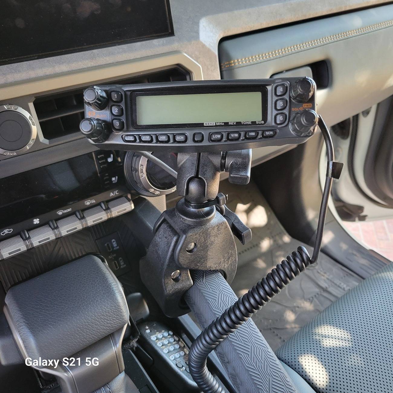

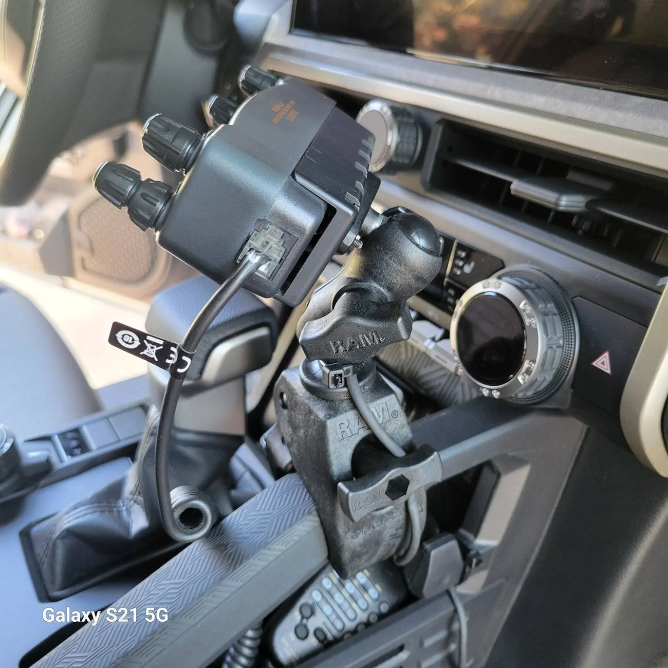

Hopefully a final mounting option. Iterations one and two are posted above. This solution uses a medium Ram clamp mount on the PS center console grab bar and a short arm. I still need a good solution for a mic clip. An adhesive sticky mount on the back of the clamp is one solution. I think the hard rubber on the clamp is thick enough for the small screws that I have with a standard metal clip.

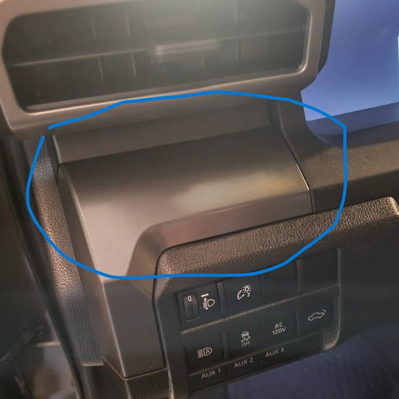

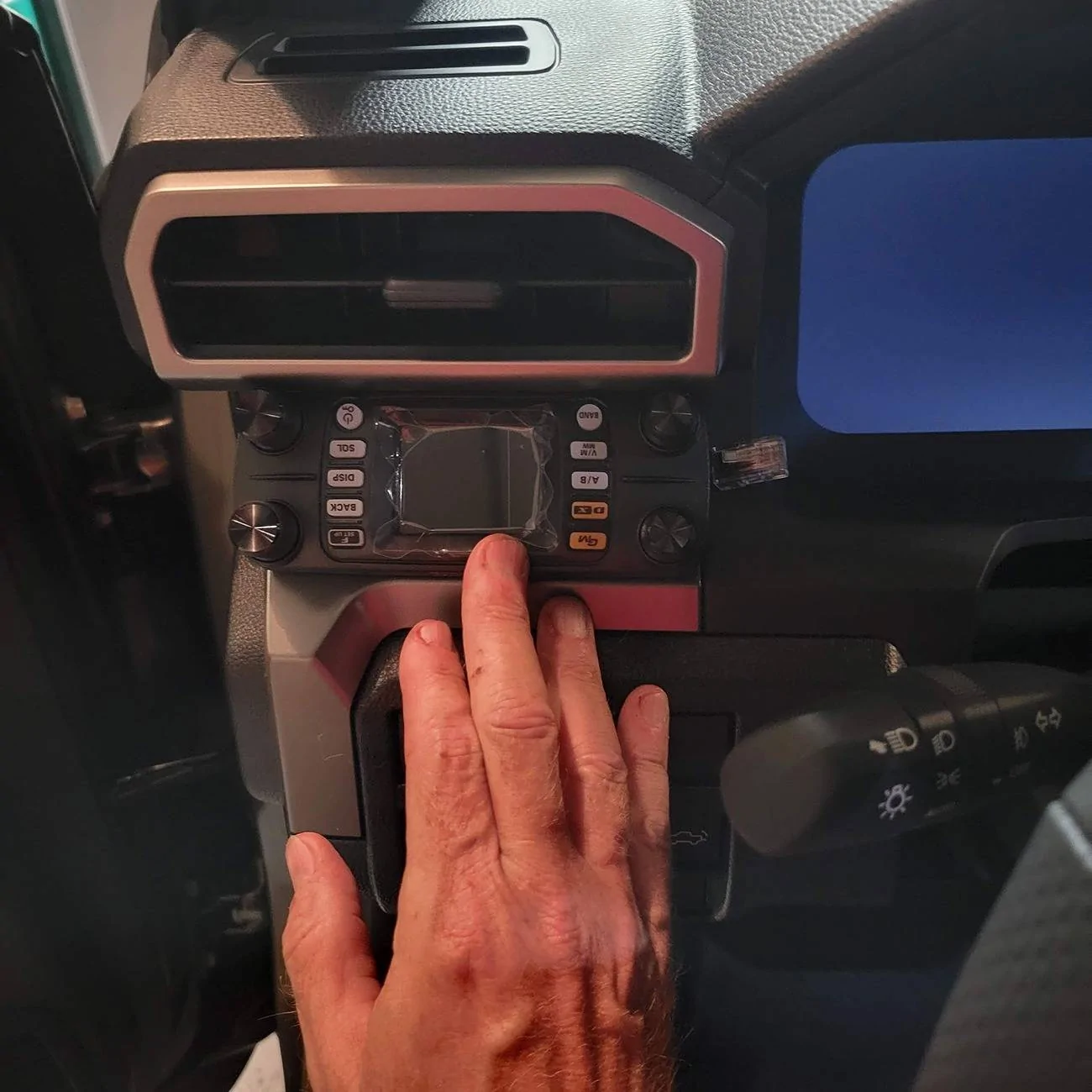

Dropped by Ham Radio Outlet (HRO) Today
2024 Tacoma HAM and GMRS Radio Installs in 4th gen Tacoma -- Post Your Setups 20240805_192018
This looks like a good place for the faceplate. Yes I know the picture is upside down
2024 Tacoma HAM and GMRS Radio Installs in 4th gen Tacoma -- Post Your Setups 20240805_192212
Working on the antenna bracket and then were to install main unit and speaker. Also, where to put the Mic holder
@brentbba how did you install your main unit under the seat? Did you remove the seat to do it?

Faceplate looks good there! Tape or velcro to hold it in place? I didn't remove the seat. Moved it all thecway forward, used a little left over velcro to hold it in place. I ran the wires out the side down under the plastic runner at the door. I could clean it up a little by poking a hole in the carpet to conceal the 3" of exposed wire, but it doesn't bother me.

I was thinking of taking the trim off and driving a mounting screw through it and also routing the wire from the head unit through there. That is a more permanent install, but also the HAM has gone with the last few vehicles I have sold.
