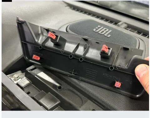

What is this panel above your screen- and is there a version for the 14" screens?
That photo is a 3G. We are actually launching a dash mount that goes behind the 14" screen soon here. I'm going to try and use it to mount my radio faceplate. Ill post her when I figure it out.

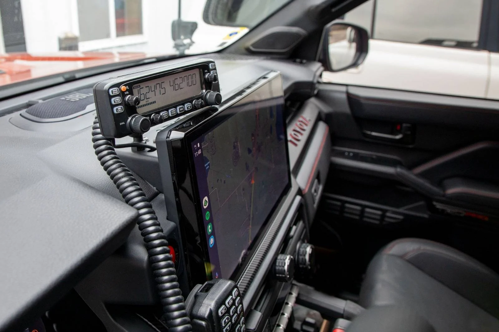

The top of the radio faceplate is even with the front of my hood, so no blind spot issues.
Our install doc:
https://gembadocs.com/stdop/pdf/d12311b9a-e09544d3aecb-1726498595

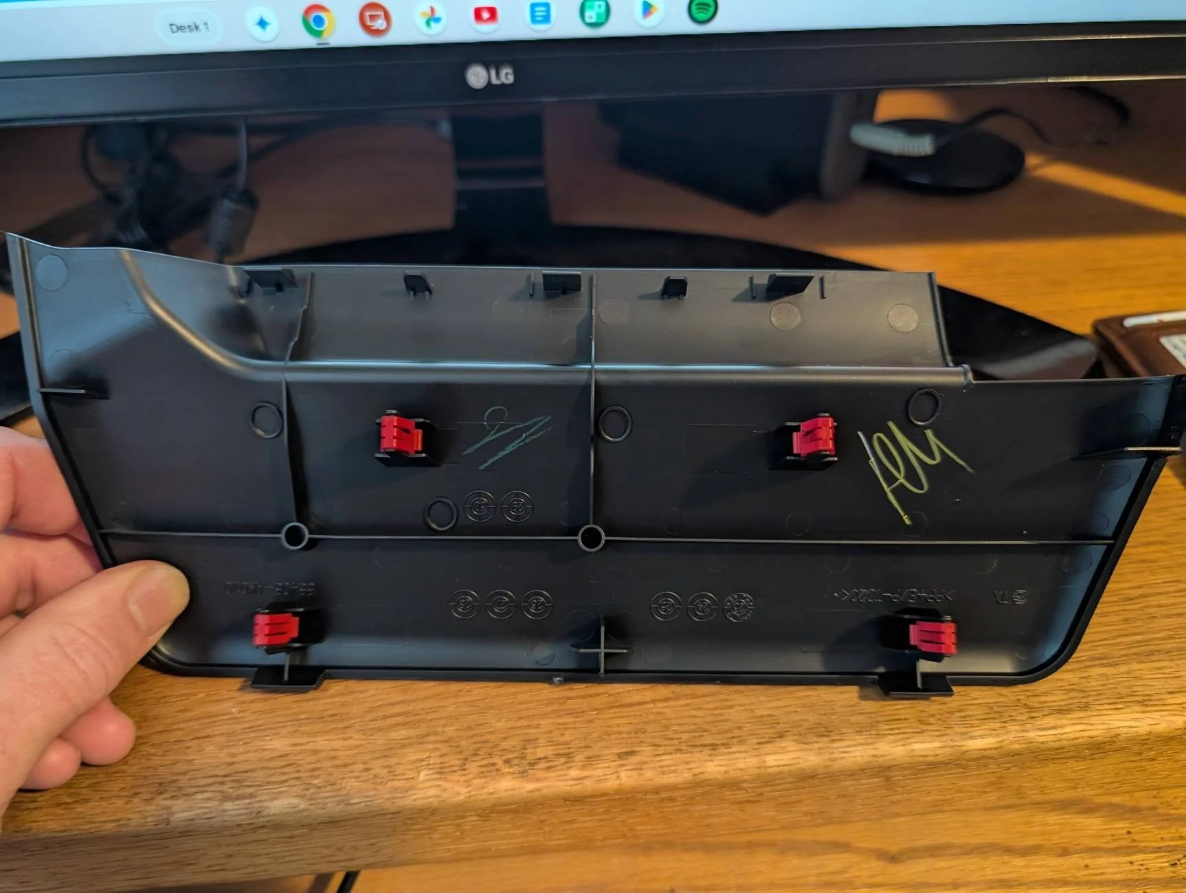

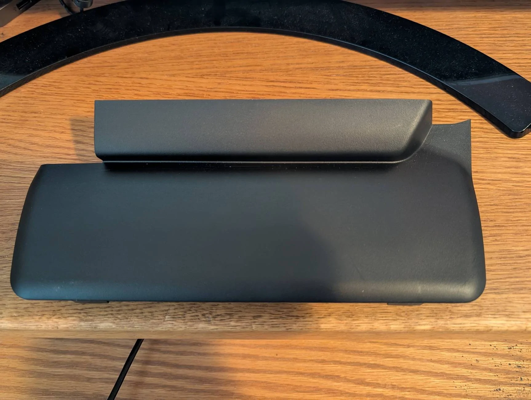

Here is a picture of my plastic.
2024 Tacoma HAM and GMRS Radio Installs in 4th gen Tacoma -- Post Your Setups PXL_20241218_213215543
2024 Tacoma HAM and GMRS Radio Installs in 4th gen Tacoma -- Post Your Setups PXL_20241218_213728911.MP

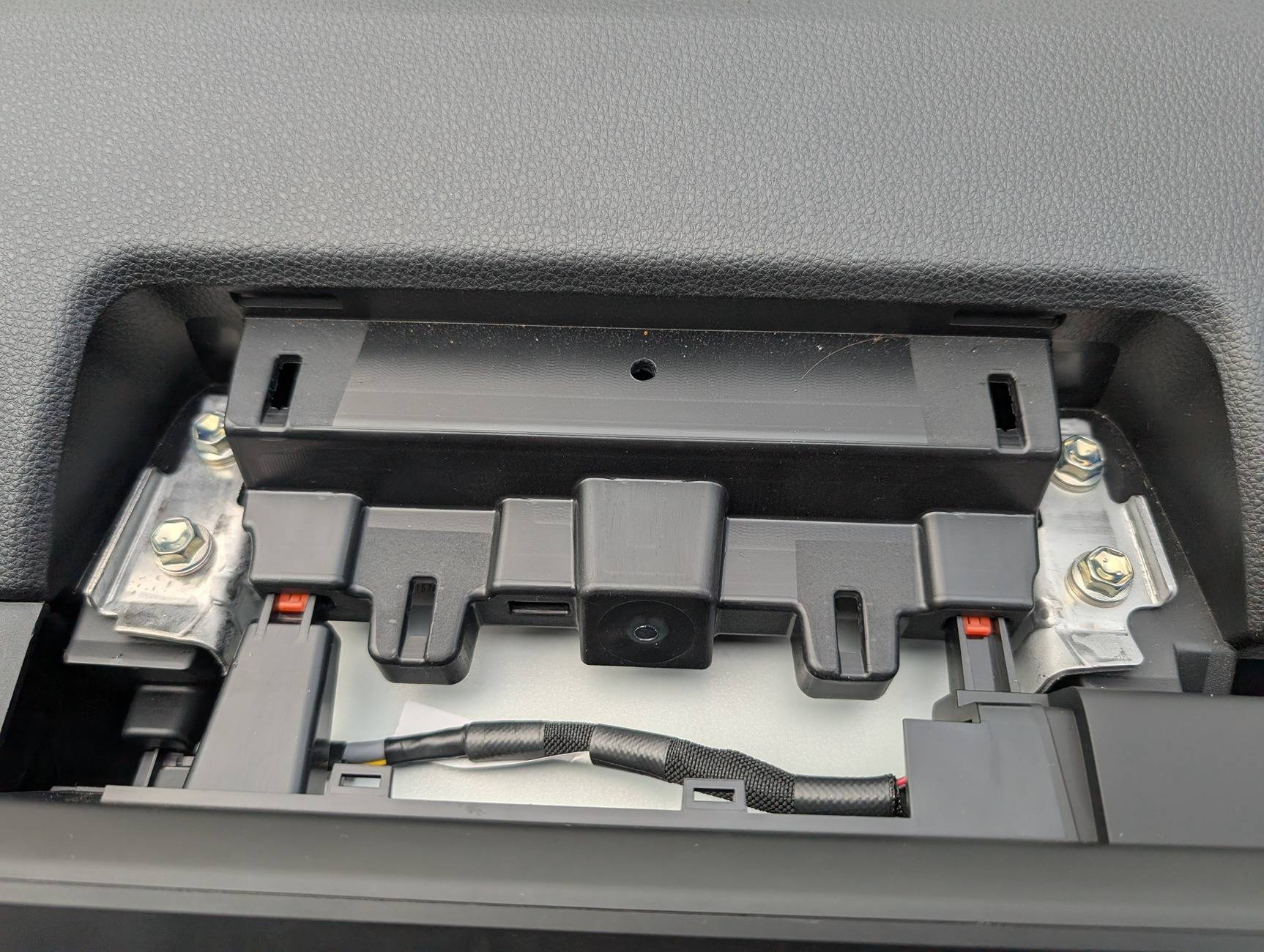

...and what it looks like w/o the plastic.
2024 Tacoma HAM and GMRS Radio Installs in 4th gen Tacoma -- Post Your Setups PXL_20241218_213841186
2024 Tacoma HAM and GMRS Radio Installs in 4th gen Tacoma -- Post Your Setups PXL_20241218_213902451
So, it appears to me the bolts are in the same location and the plate may fit but there might be a gap between the plate and the screen. Hard to say though w/o just trying it.

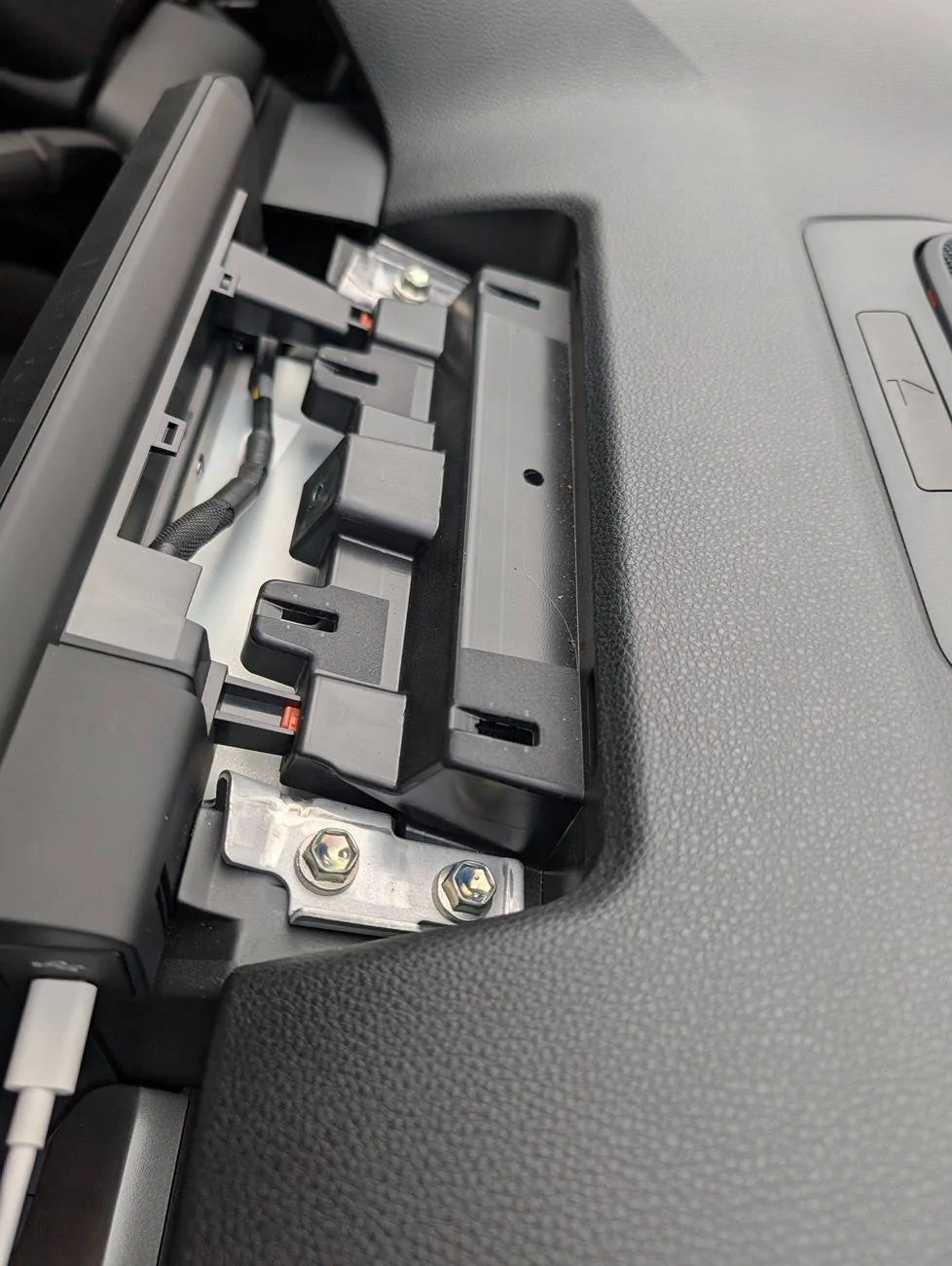

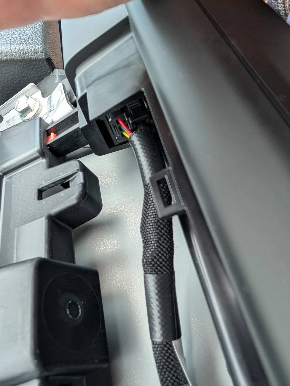

Also, a thought. It appears to me that the USB charging/data port on the side of the display is most likely fed through the connector shown in the picture below. Rather than providing some generic extension cables with the kit, it would be a much more complete kit if you made a pigtail that plugged in between and used that port. True, it might confuse AA or Carplay if someone plugged in more than one device so testing is needed but if I were going to power USB devices, that's where I'd try to pull the power from initially.

You guys will have to forgive my ignorance. Are you suggesting that with the proper connector/pigtail I could power a radio from that connection/port that is shown in one of your picture underneath that plastic part you took off? Or am I still going to have to try and find a way to get a power cable to the battery through the dash somehow?
edit: not a problem as I’ll still have to find a way to get the antenna cable under the dash and through the firewall. I’ll likely be mounting the whole radio body up behind the screen.

Right. The connector I showed in the picture is likely the USB C on the right side of the screen. I was referring to being able to power the USB adapters that Victory includes in the kit. You wouldn't be able to power your radio with that. Since you're bringing the antenna in through the firewall definitely bring power in at the same time (or pull it from somewhere else in the cab). I've pulled a couple of wires through the firewall and it's actually pretty easy on these trucks.
