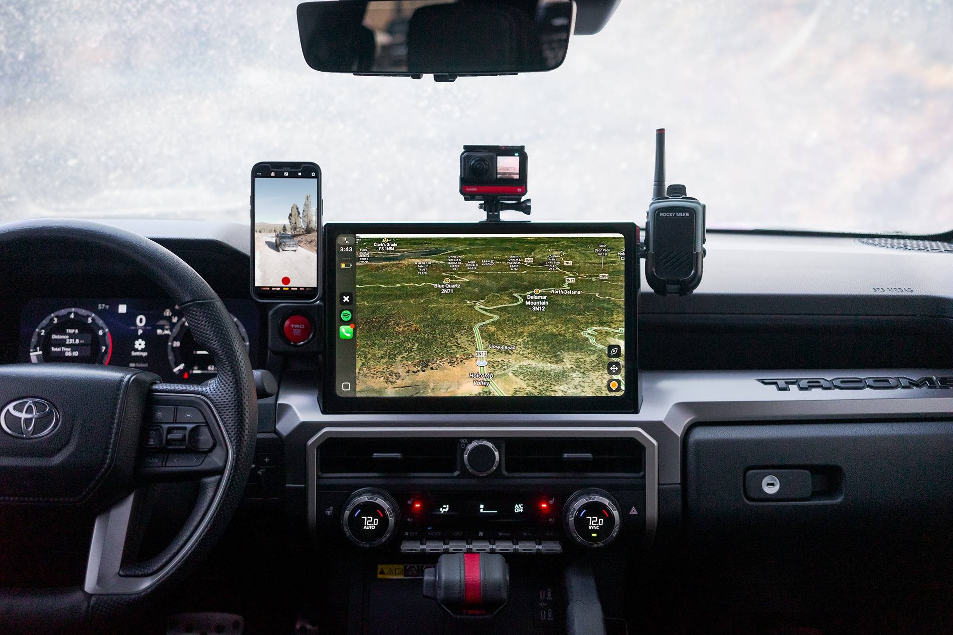

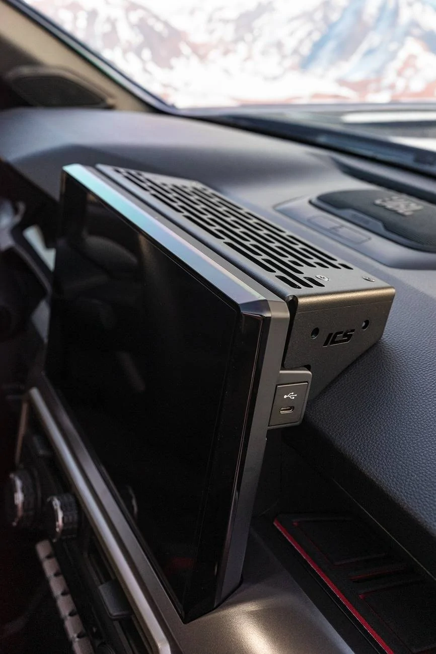

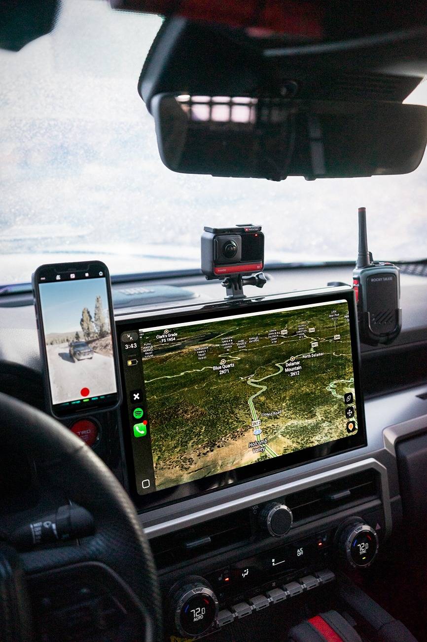

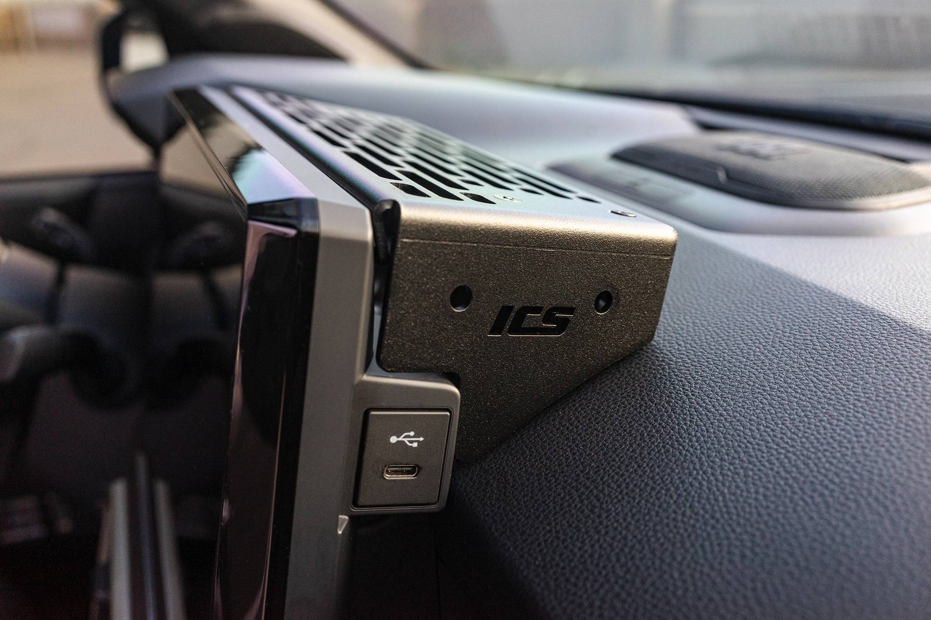

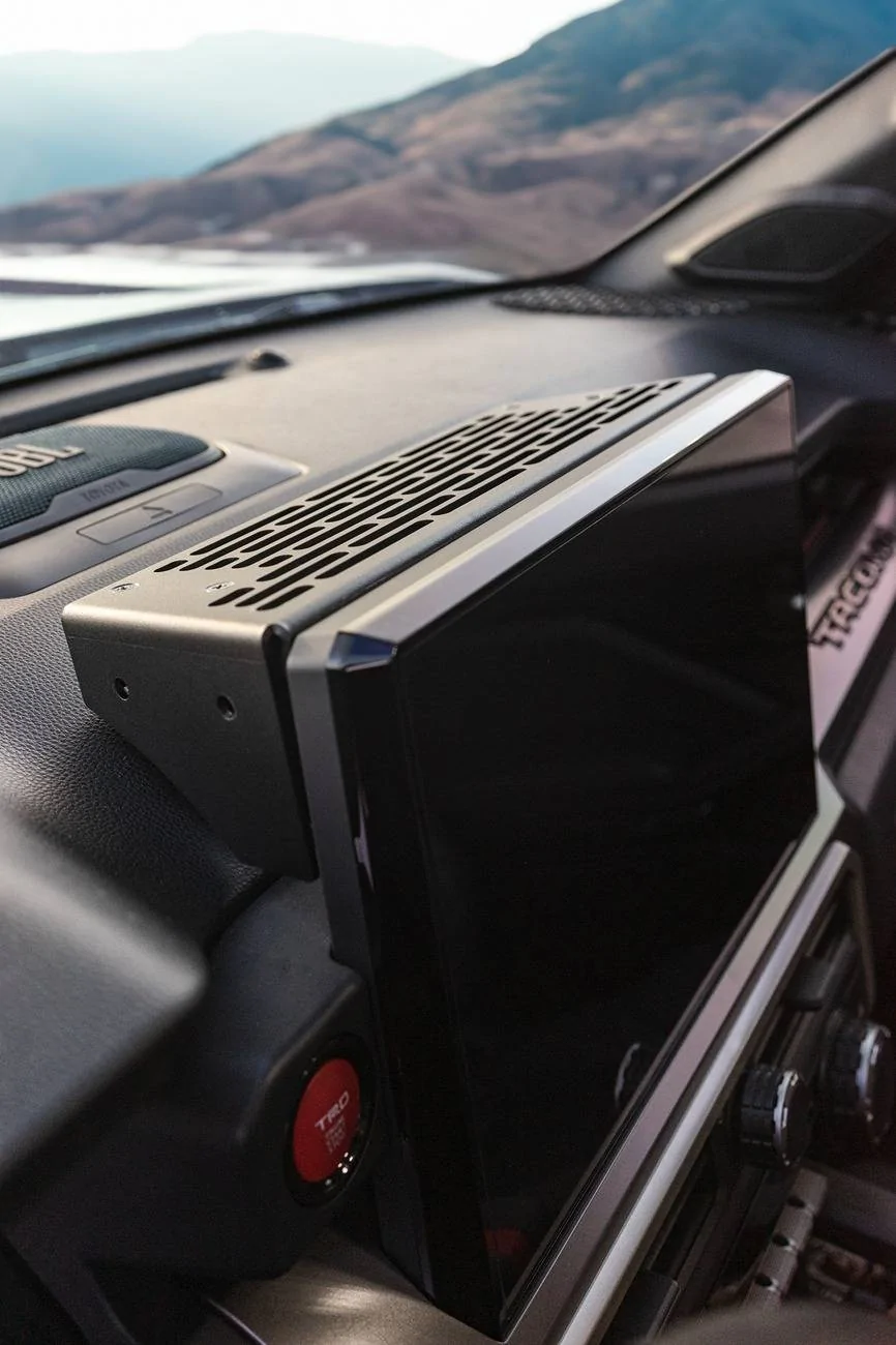

i've been running the ICS Fab dash mount for the last few months and it's been really solid. only have need for a handheld GMRS but it has enough space to mount radio boxes and more.
the 2 hole amps ball mounts with 3" arms on either side are the best mounting points to keep a phone/radio/mic tucked in without obstructing view, rather than mounting ontop of the already big screen.
