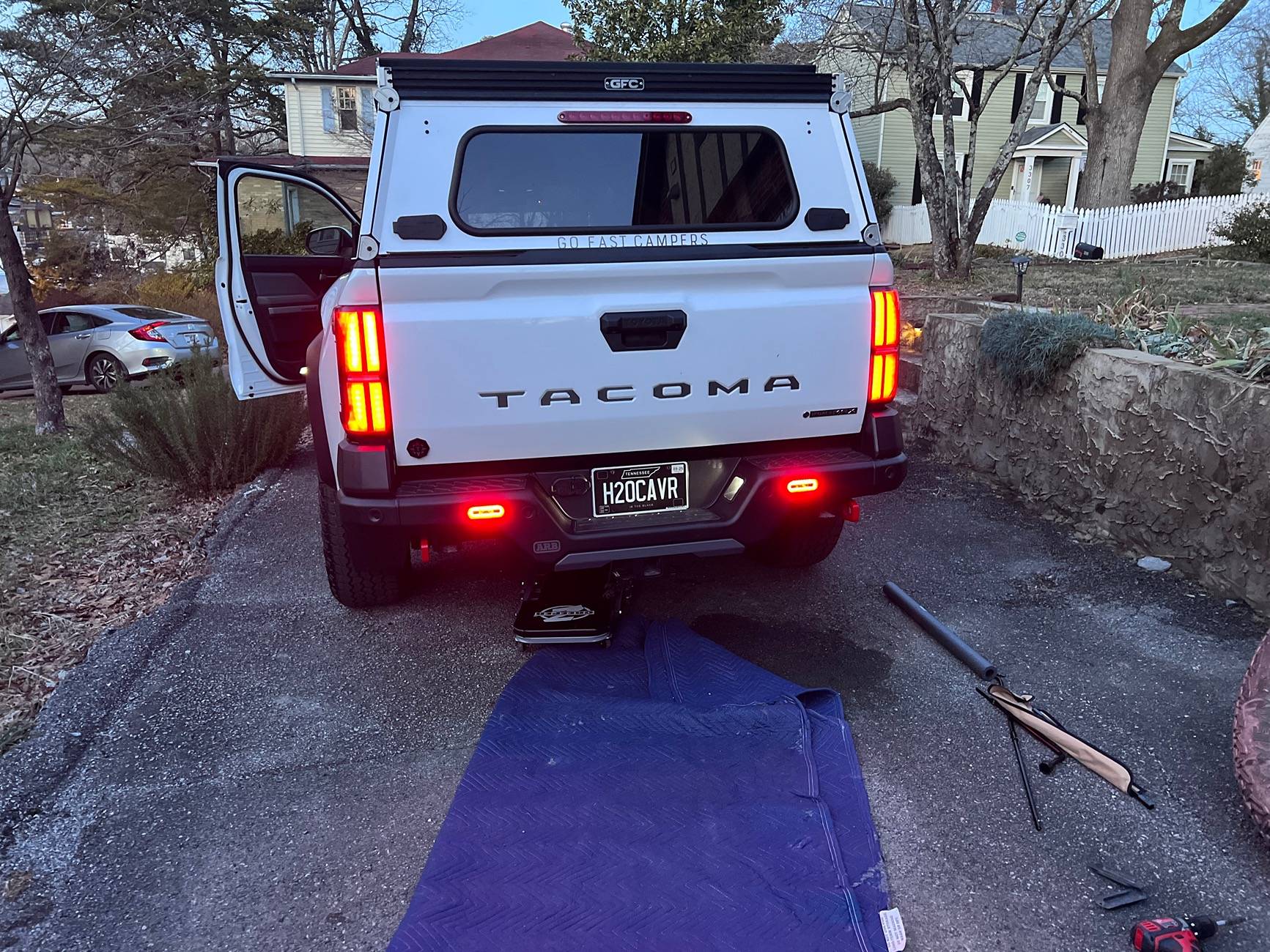

I just installed these lights on my truck.
I used a 6" long 1/4" extension with the T20 bit to remove the screws. On the passenger side, I removed the speaker to access the screw on the bumper cap.
Removing the park aid sensors helped with access to the screws.
The harness (short) is plug and play. The connectors at the lights had to be crimped and the splice connectors heat shrunk.
I find that the lights are too bright with the park lights on. I'll rewire for them to come on with the brake lights.

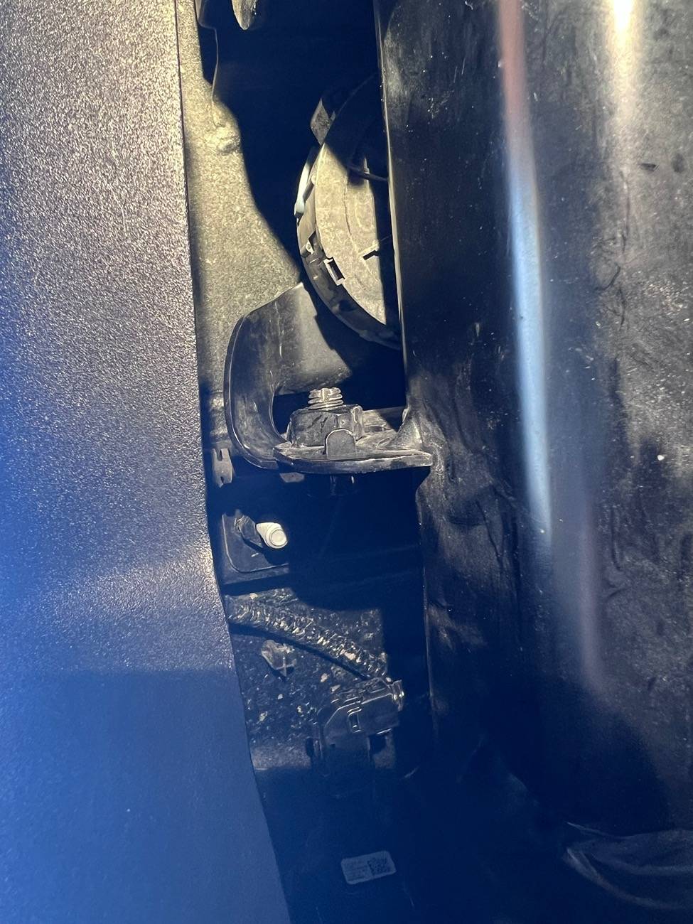

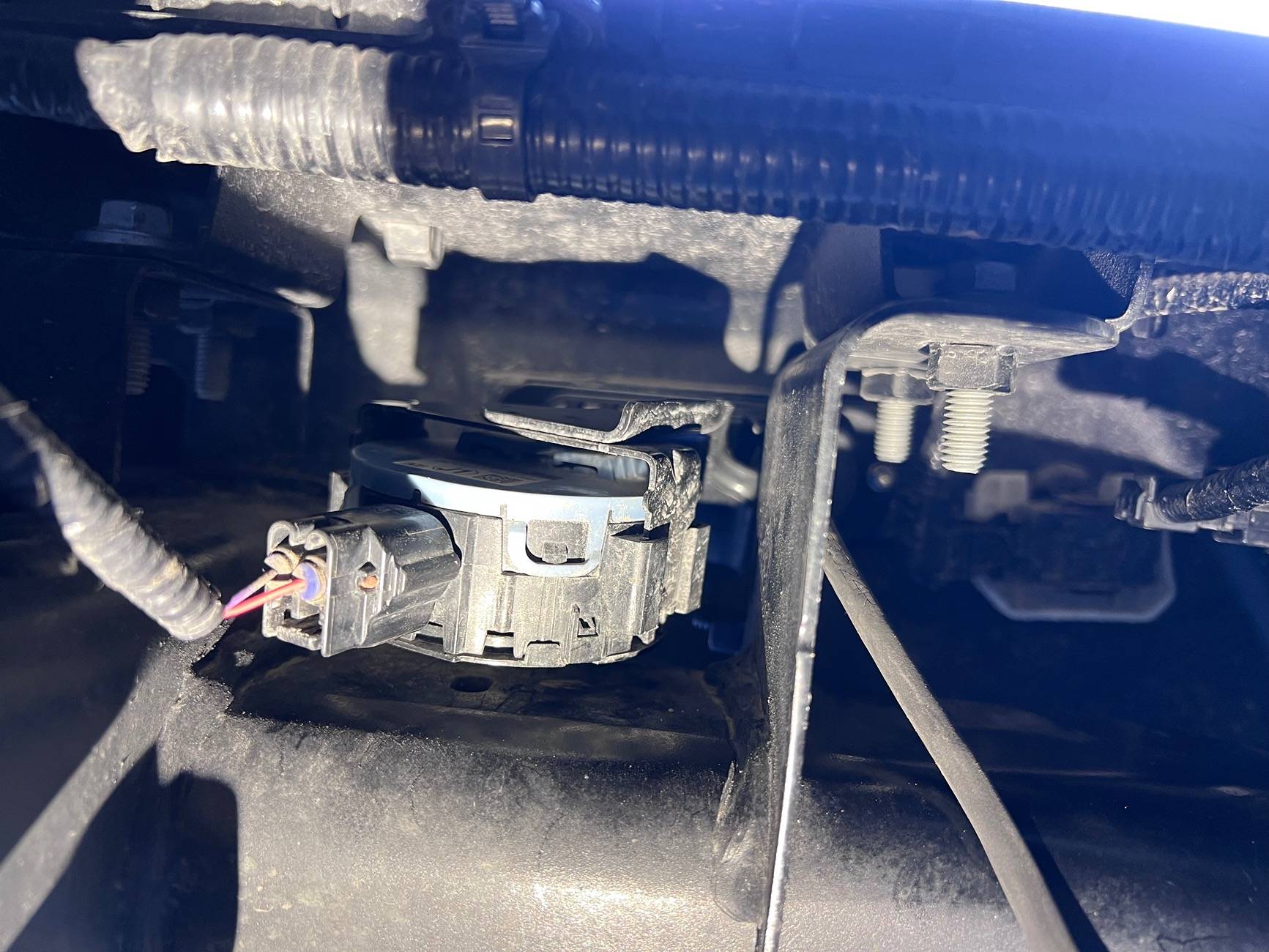

Anyway, for those with a hybrid- there is a little speaker pick that blocks access to the passenger side light. It is easily removed, I clip the two wire connector and then it’s one 10mm bolt accessible on the bumper side of the mounting bracket.
2024 Tacoma HOW TO: Rigid SR-L Series Lights for ARB Rear Bumper Installation IMG_1819
View rearward, you can just barely see the light hiding behind the speaker puck.
2024 Tacoma HOW TO: Rigid SR-L Series Lights for ARB Rear Bumper Installation IMG_1817
Looking directly up, bumper to the left, here is the one bolt that lets you remove the speaker.

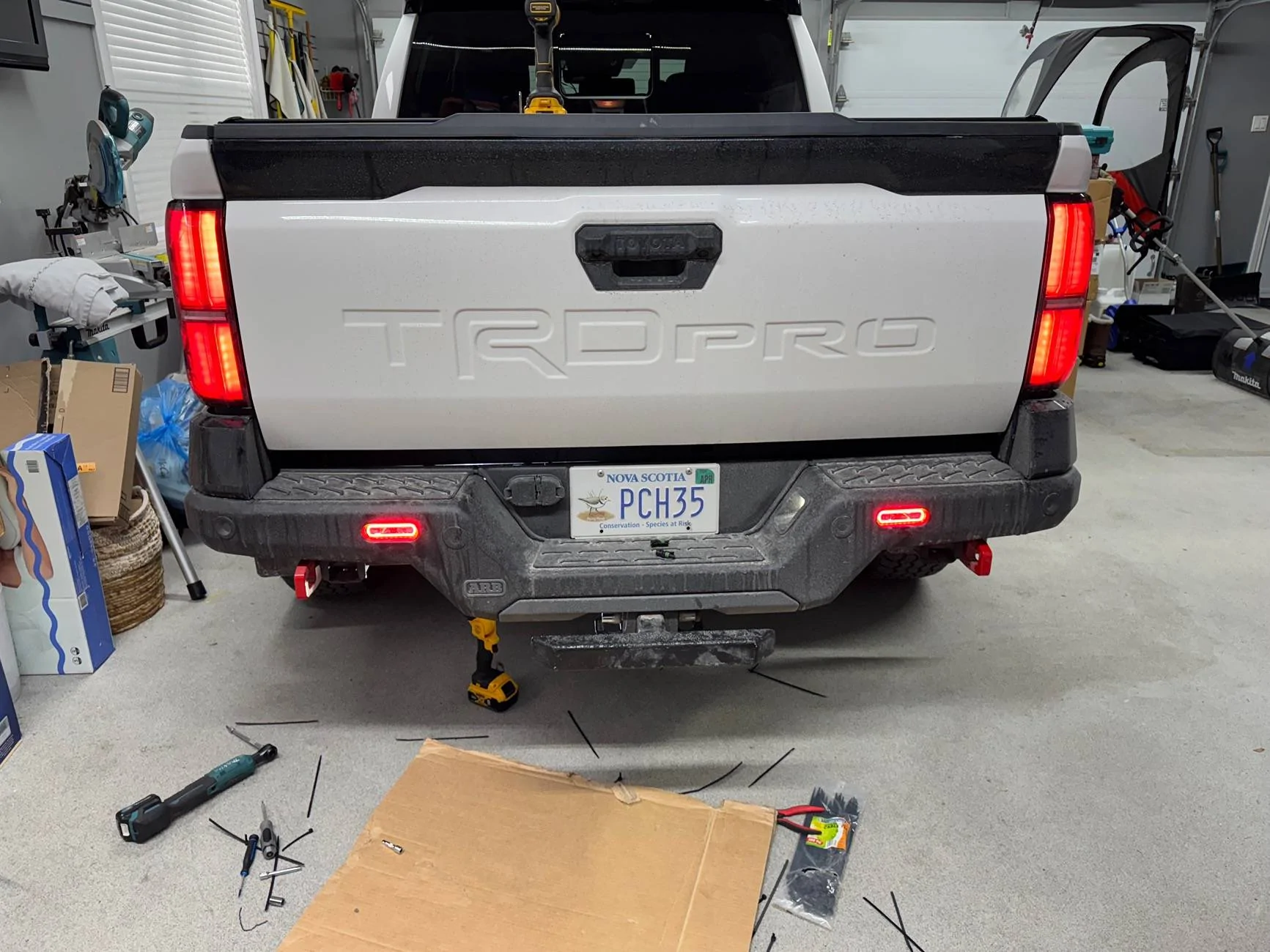

Can someone explain step 7 to me like I'm 5 years old, what do I need to plug in, in the engine bay for power to get sent to the rear? my trucks a 2025 and the wiring is slightly different due to having an additional AUX button
2024 Tacoma HOW TO: Rigid SR-L Series Lights for ARB Rear Bumper Installation IMG_5052
