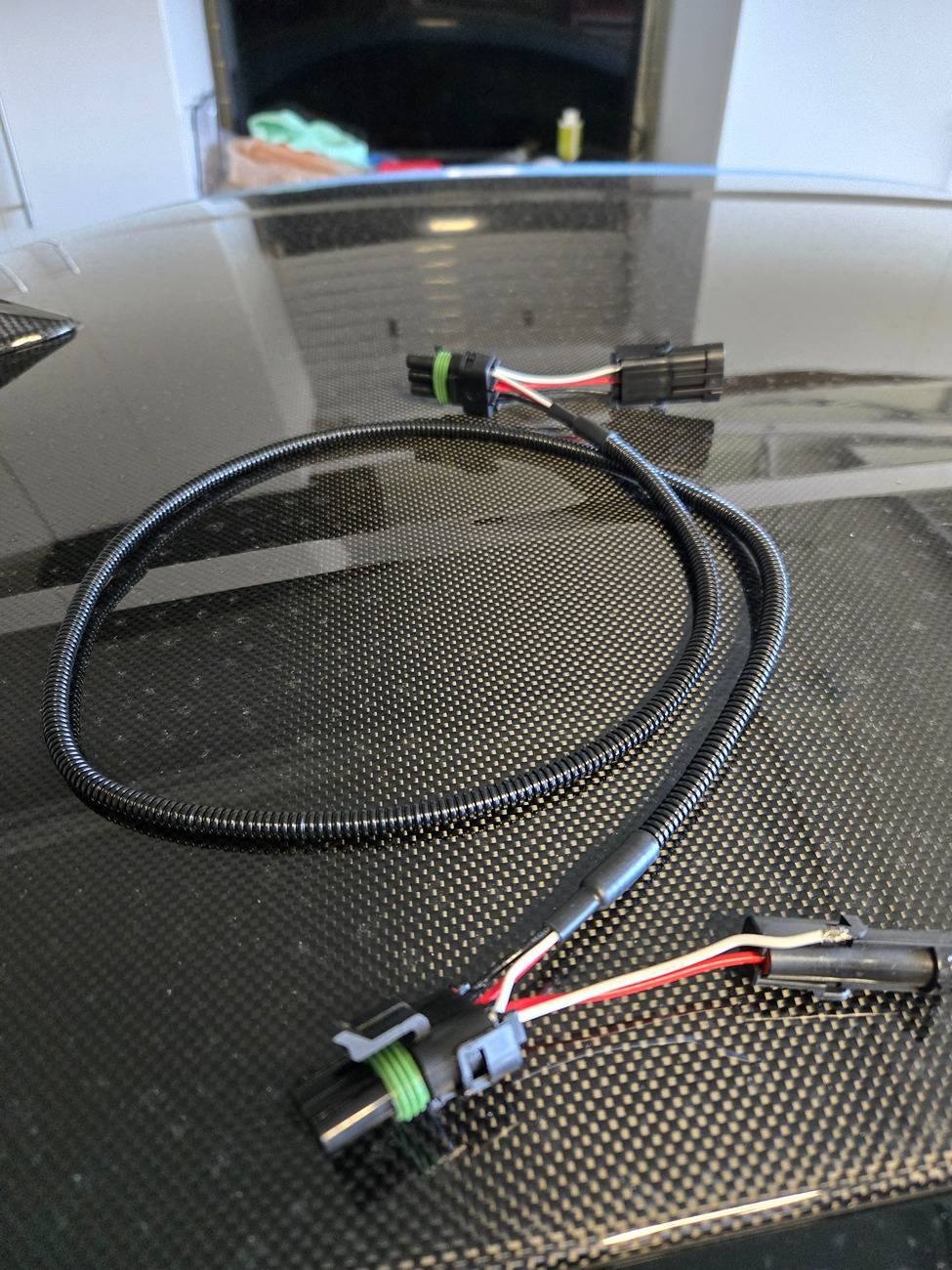

For those who are not aware. Here is what is different, and the same.
Originally Toyota only had access to ONE switch back there. One wire was power and the other a ground.
In 25, both the Trail Hunter and the TRD Pro can come with the ARB Bumper and the Plug for the switch.

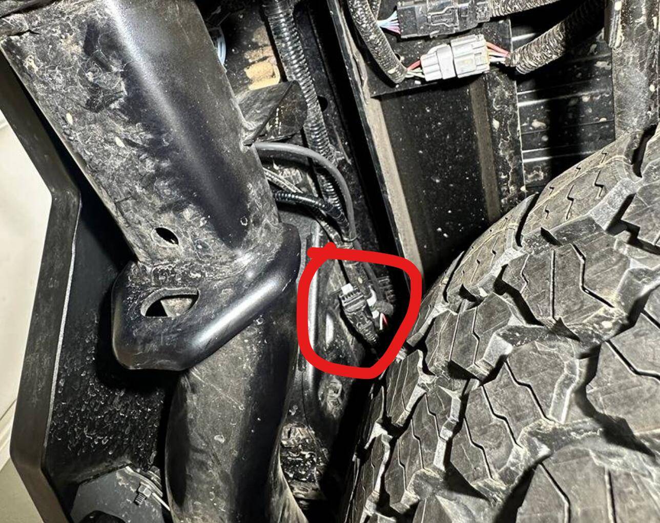

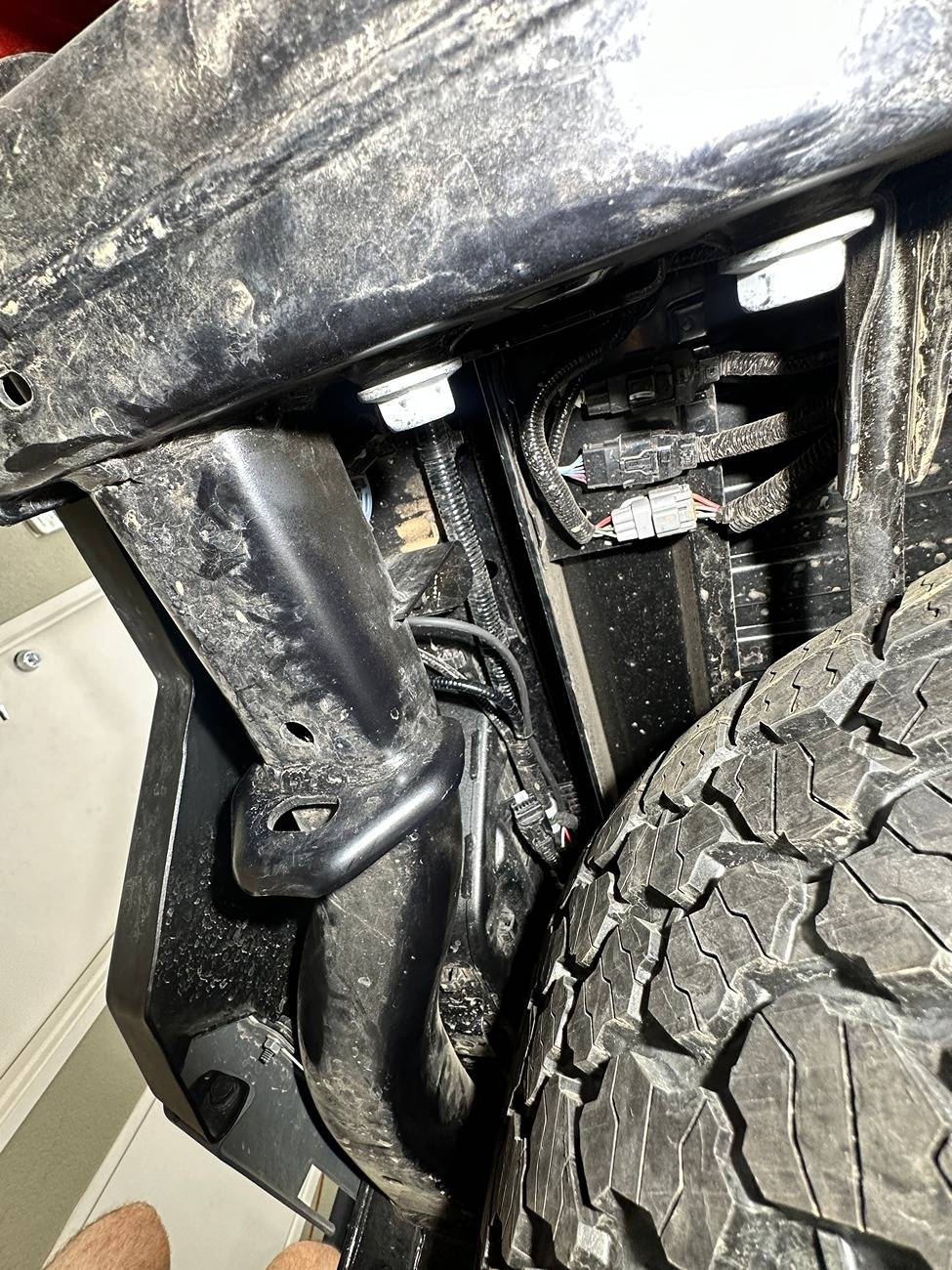

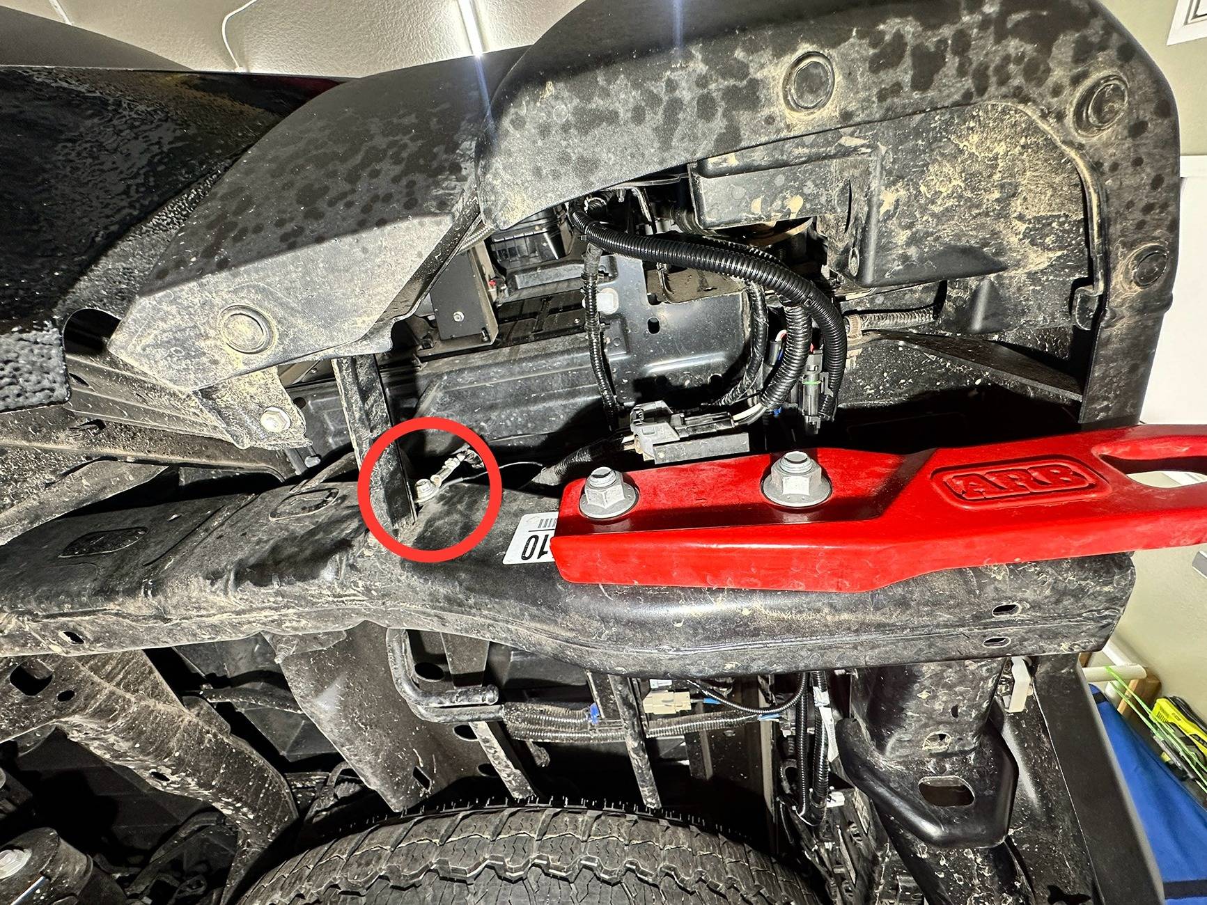

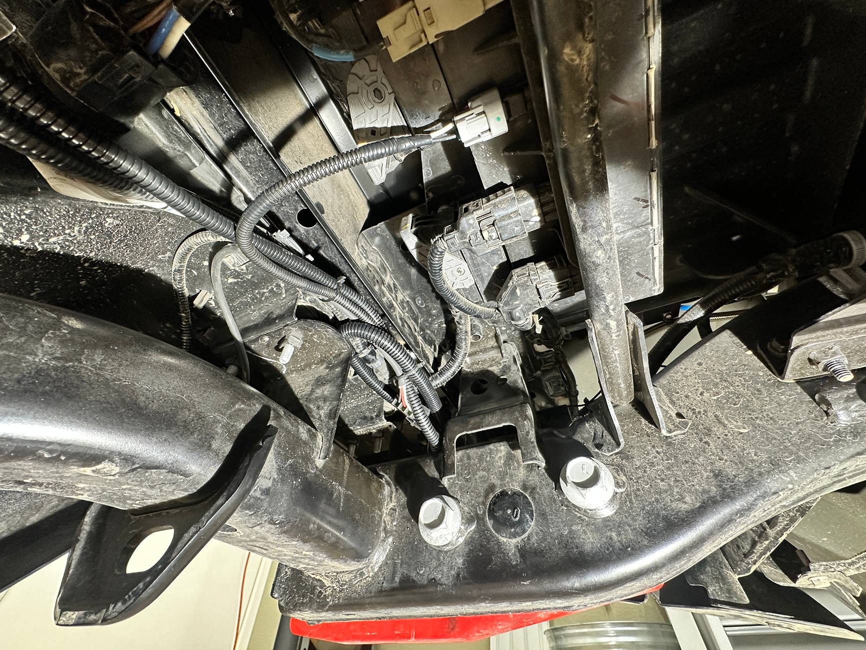

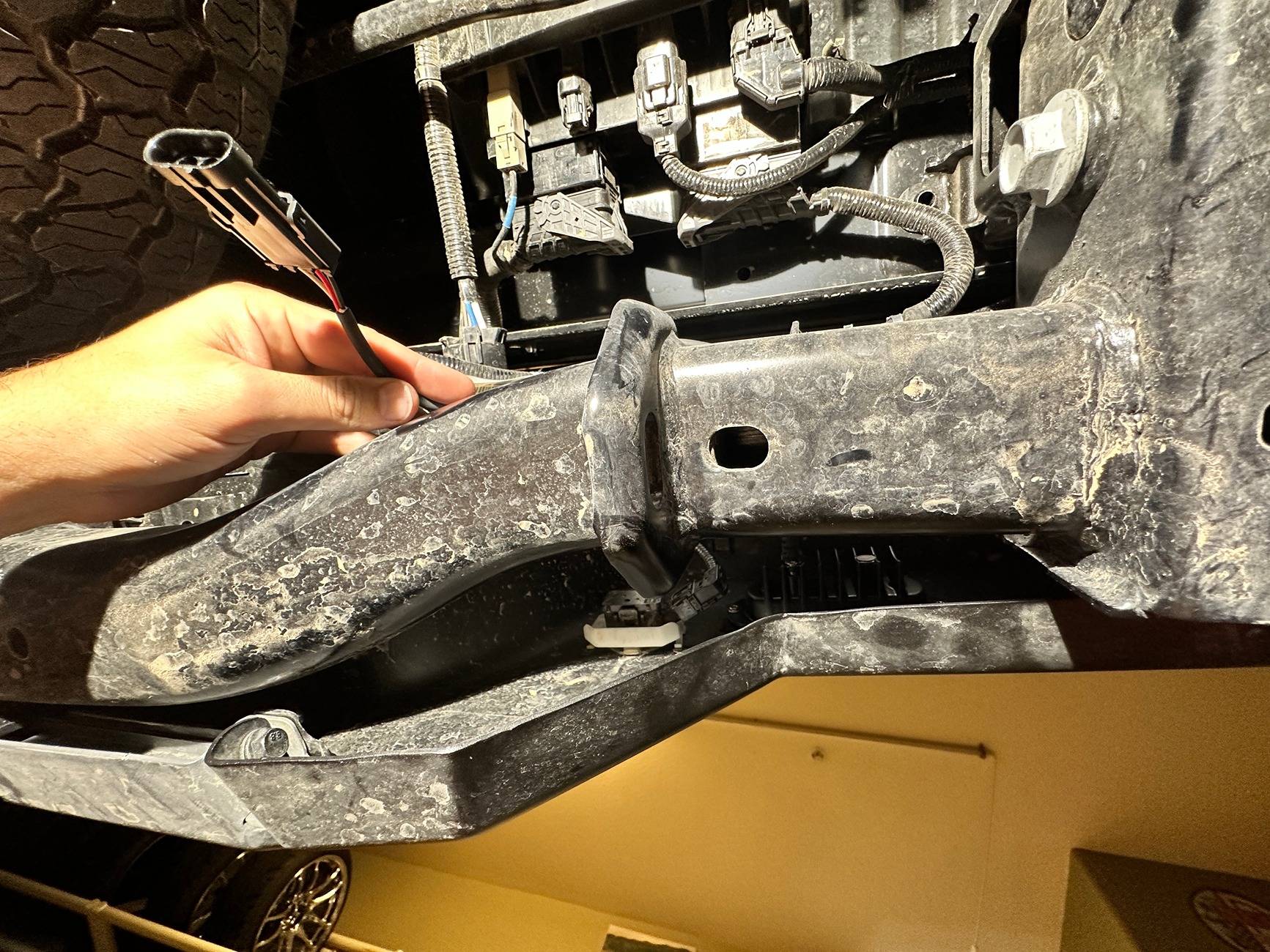

Taking the photo (Zoomed IN) that @wolfpackwest posted in the beginning of this thread with his install. We started out with him simply using his Toyota Provided pig tail And then adding a crimp on connector to it that could then plug into out short rear harness. Again, notice in the photo.
2024 Tacoma HOW TO: Rigid SR-L Series Lights for ARB Rear Bumper Installation Picture1

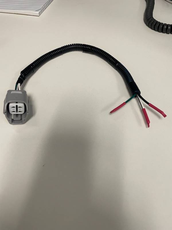

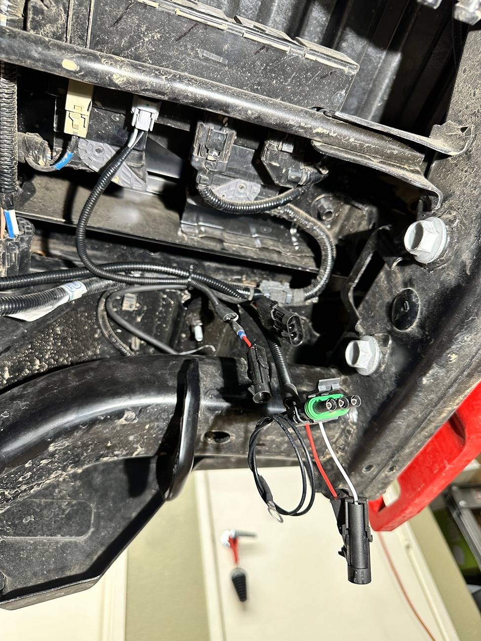

After many on here like the solution and wanted to replicate it. We simply produced a new "Complete" pig tail harness that took those 2 pieces and made one. See the photo below. This is still current for all 24 models-
2024 Tacoma HOW TO: Rigid SR-L Series Lights for ARB Rear Bumper Installation Picture2

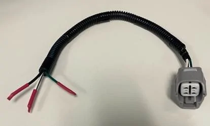

Now... This is the NEW pig tail Toyota Provides-
2024 Tacoma HOW TO: Rigid SR-L Series Lights for ARB Rear Bumper Installation IMG_1450 (002)
As you see. It is just like the original one. However, it is the 4 pin version. So. For those of you who don't want to wait a short time.. I am guessing 3-4 weeks? You can simply take your existing Toyota Pig tail and put a connector on it (we can provide it) just like this post and install shows. We just made it even EASIER with the all one piece version and we will have the same again.
Below is a photo indicating which color wire is which.

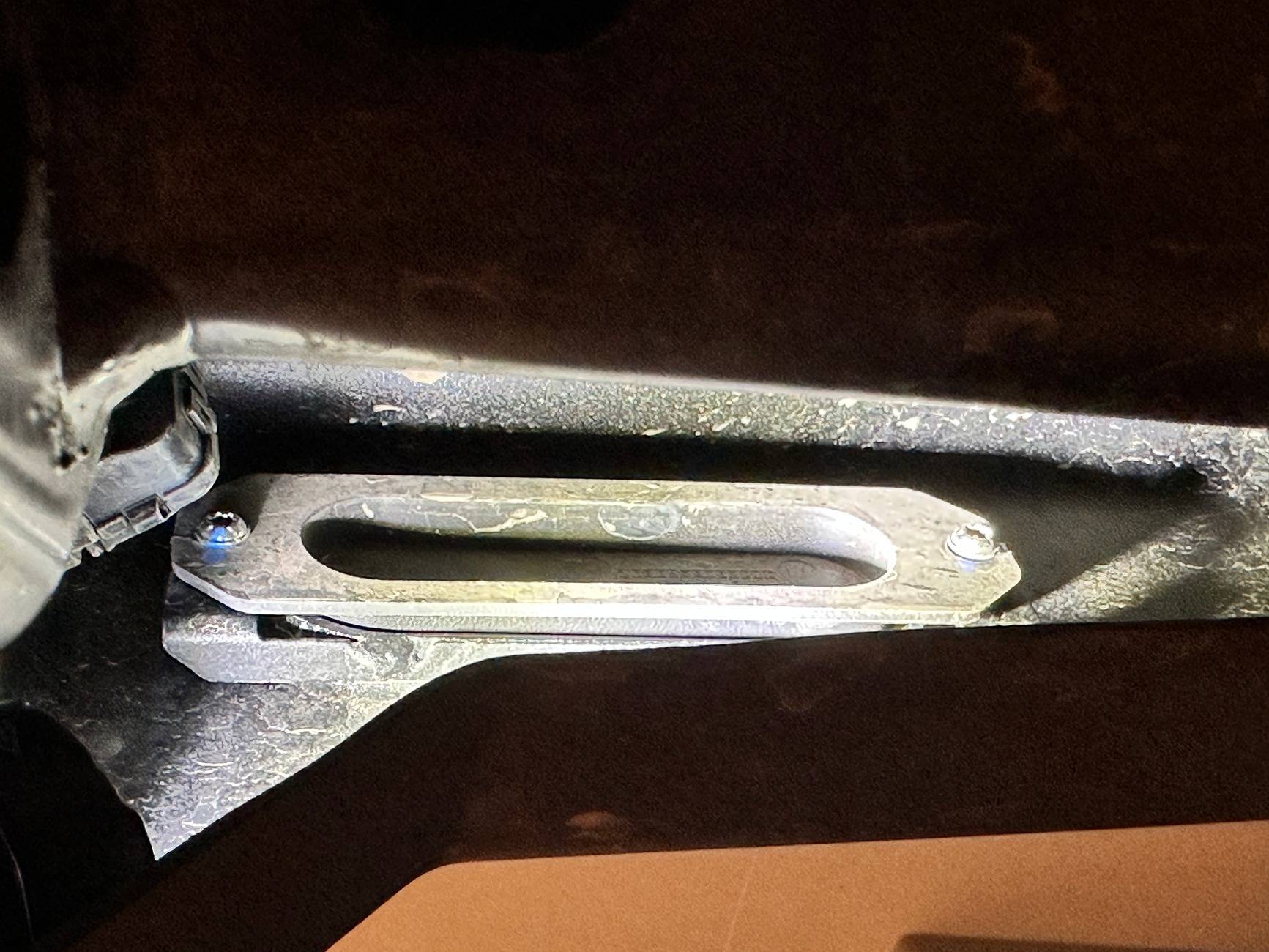

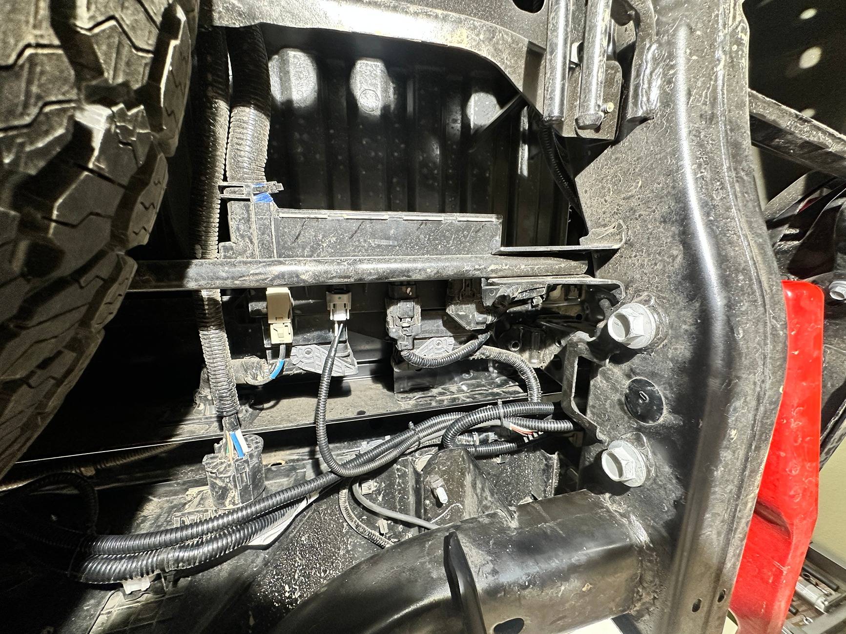

Here are also a couple more photos of it under the truck-
2024 Tacoma HOW TO: Rigid SR-L Series Lights for ARB Rear Bumper Installation 3
2024 Tacoma HOW TO: Rigid SR-L Series Lights for ARB Rear Bumper Installation 2
2024 Tacoma HOW TO: Rigid SR-L Series Lights for ARB Rear Bumper Installation 1

I thought I would try to clarify and shorten my explanation-
For the 25 Models (ONLY)
This is the connector Toyota provides you with all of them.

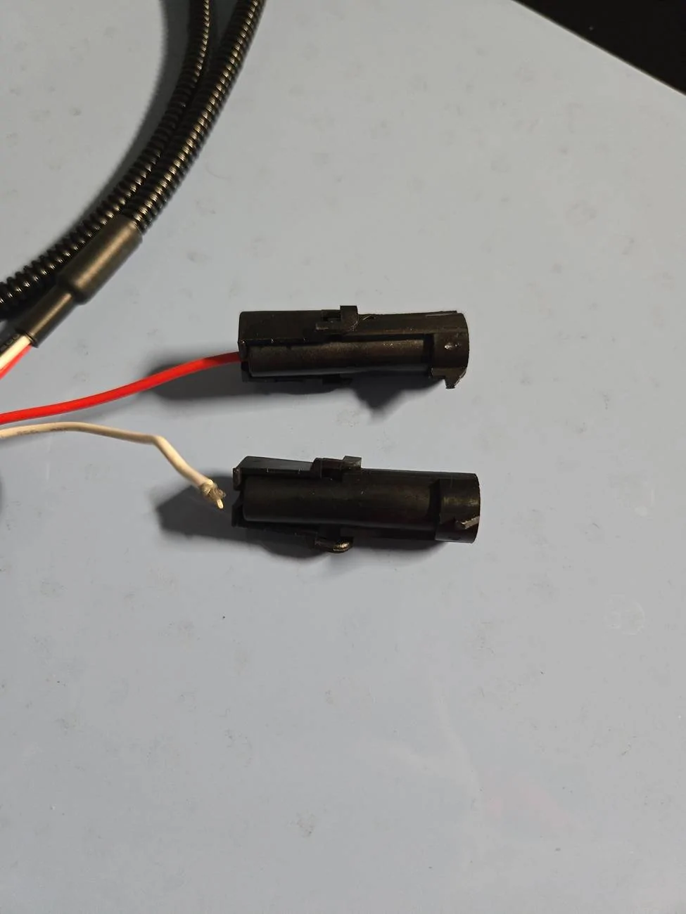

2024 Tacoma HOW TO: Rigid SR-L Series Lights for ARB Rear Bumper Installation 1742435779505-ct

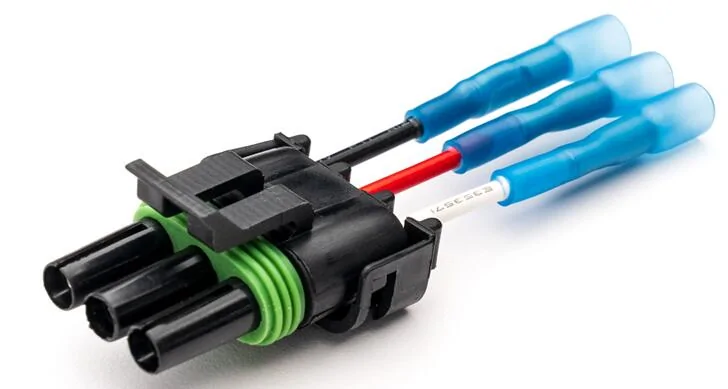

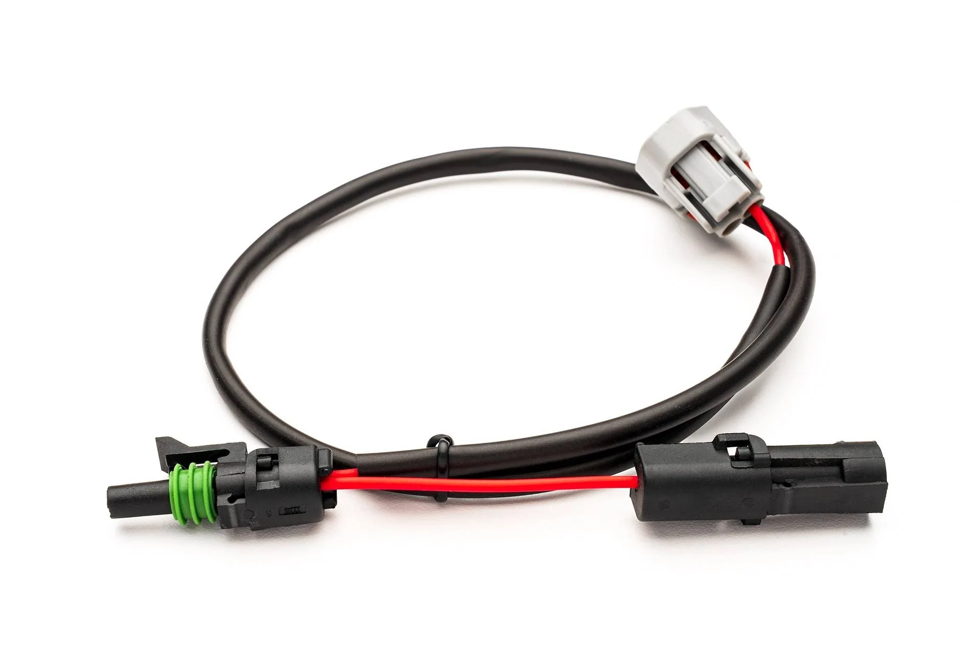

This is a crimp on connector we have now.
2024 Tacoma HOW TO: Rigid SR-L Series Lights for ARB Rear Bumper Installation 1742435855192-kv
You can right now, simply take your connector pig tail and crimp on our connector there, and that is what we will be producing. So it’s the same, except you just crimp the connector on.

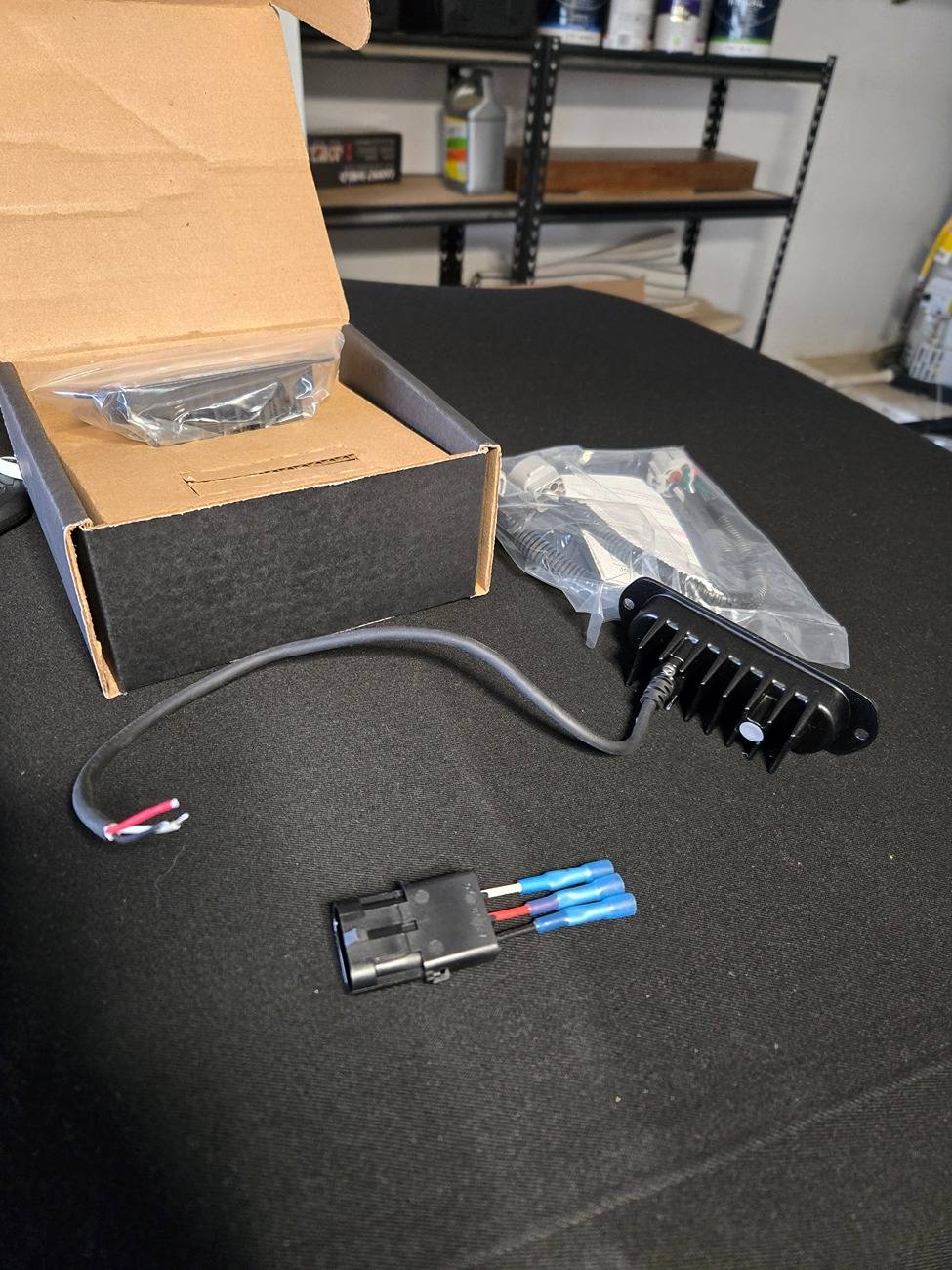

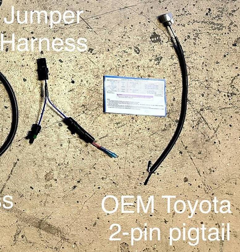

If you're like me, and wanted the vehicle-specific Rigid light kit for the ARB Bumper, but also wanted the feature of being able to manually fire the lights as well - then this thread is for you. You can also follow this along for the 'normal' install as well; you'd just forego the 'splitter' harness and wire the lights directly into the Taillight/Short harness.
A quick background, if you haven't been following the other thread where John from SPV has been chiming-in: the vehicle-specific kit from Rigid is just simply the SR-L series flush mount lights along with a harness for our trucks, but has been reported to have some issues with the harness they provide. Additionally, their harness was reported to only be firing the lights with the reverse light trigger, and wasn't wired to illuminate the backlight feature on the SR-L's.
My preference was to have the following capabilities:
1) The automatic trigger for reverse lights (spreader)
2) The automatic trigger for the backlights to come on with parking/taillights (red halo; this is how the Rigid harness SHOULD be, but didn't function)
3) The ability to manually fire the spreader lights using the pre-wired AUX buttons and pigtails supplied with the truck
After talking to John and Sidney at SPV, who are fantastic and wildly responsive by the way, they got me all setup with their harnesses to accomplish what I was looking for. John even FaceTimed with me, late on a Friday afternoon to walk me through and show me what I would need and how it would wire-up. They got my parts out to me via UPS 2-Day shipping, and everything installed seamlessly after I received my parts.

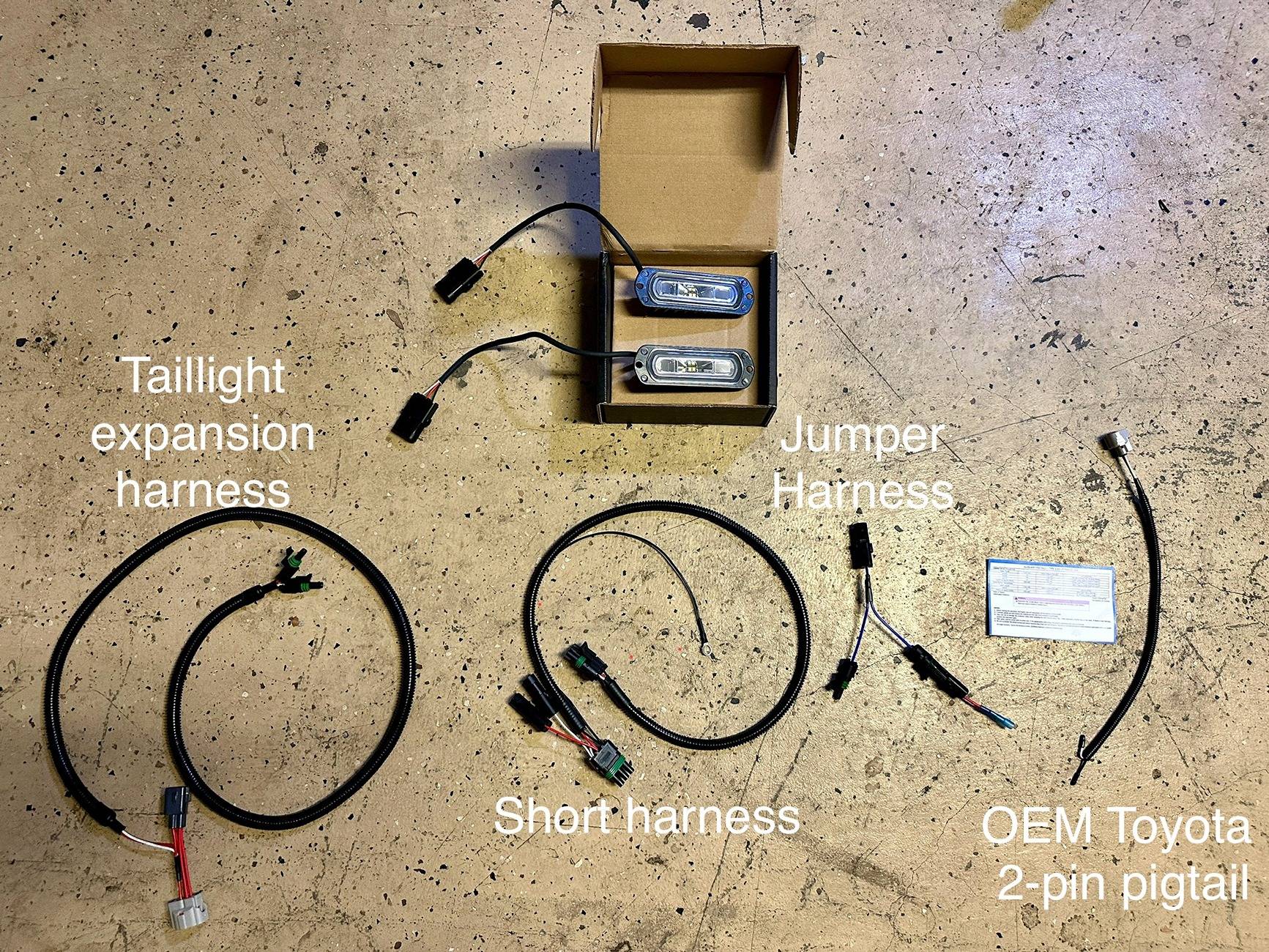

Here's a breakdown of my parts order:
1) Rigid SR-L Series Spreader Lights - Red Halo/Flush Mount - Part # 53222
2) SPV Parts Short Length Rear Harness w/Taillight adapter
3) SPV Parts 2-Way Splitter Harness
4) SPV Parts Single Pole Connector
Additionally, you'll need your OEM AUX pigtails; specifically the 4-pin to 2-pin jumper, as well as the 2-pin jumper. NOTE: So stupid, but on the OEM pigtails, the white/black (thick) wire is the ground. The black wire is 15A power. The green wire is 10A power. The blue wire is 5A power. The 2-pin jumper for the rear, ONLY has 15A power wiring; way overkill for these 2 lights, but whatever. So pay close attention to the wire colors when splicing-in. You'll see in the photo below, that I have the white/black wire bent back to remind me NOT to use it.
Here's a photo of all the pieces laid-out:
All-in-all, these parts ordered from SPV ended up being cheaper than the Rigid vehicle-specific kit. Just call up John at SPV to place your order if this is what you're looking for.

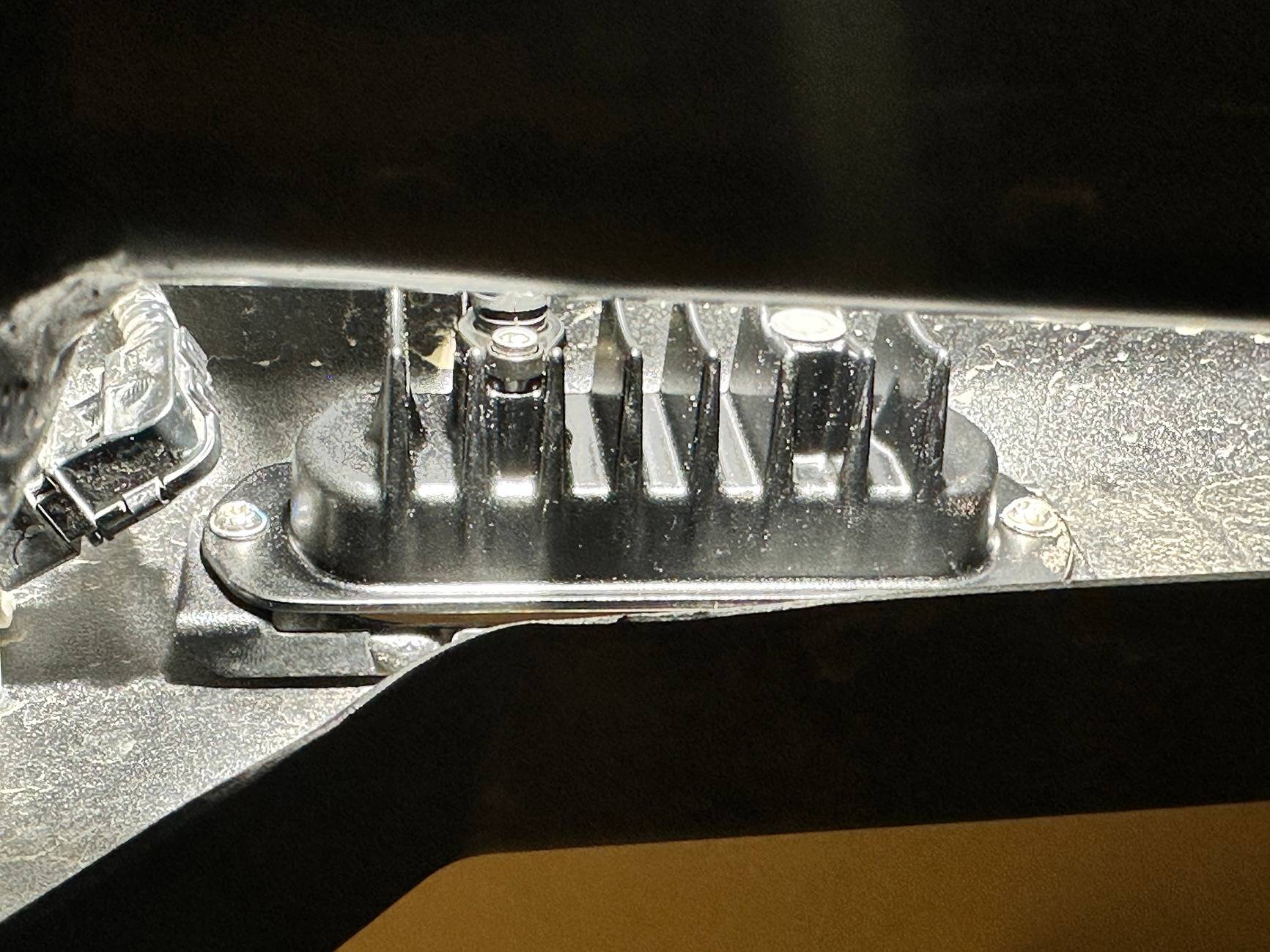

1) Locate and remove the T20 Torx screws holding the blanking plates into the ARB bumper. This was a bit of a pain to get a torx bit in there, but was able to knock it out using a 3/8" driver and ratchet, going over the frame. On the passenger side of the truck, there's some kind of mount there blocking your path; just slightly bend it up until you have enough clearance to fit the extension through. Hold onto the screws - you'll reuse them.
2) Install the SR-L's from behind, reusing the T20 Torx screws removed in previous step.

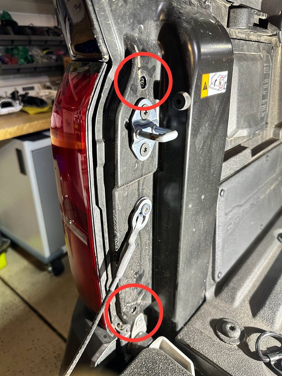

4) Remove the two 10mm bolts from inside the tailgate, securing the driver's side taillight to the fender. GENTLY pull the taillight away from the fender; there are two plastic pops holding it in. It will eventually pop out, semi-violently.

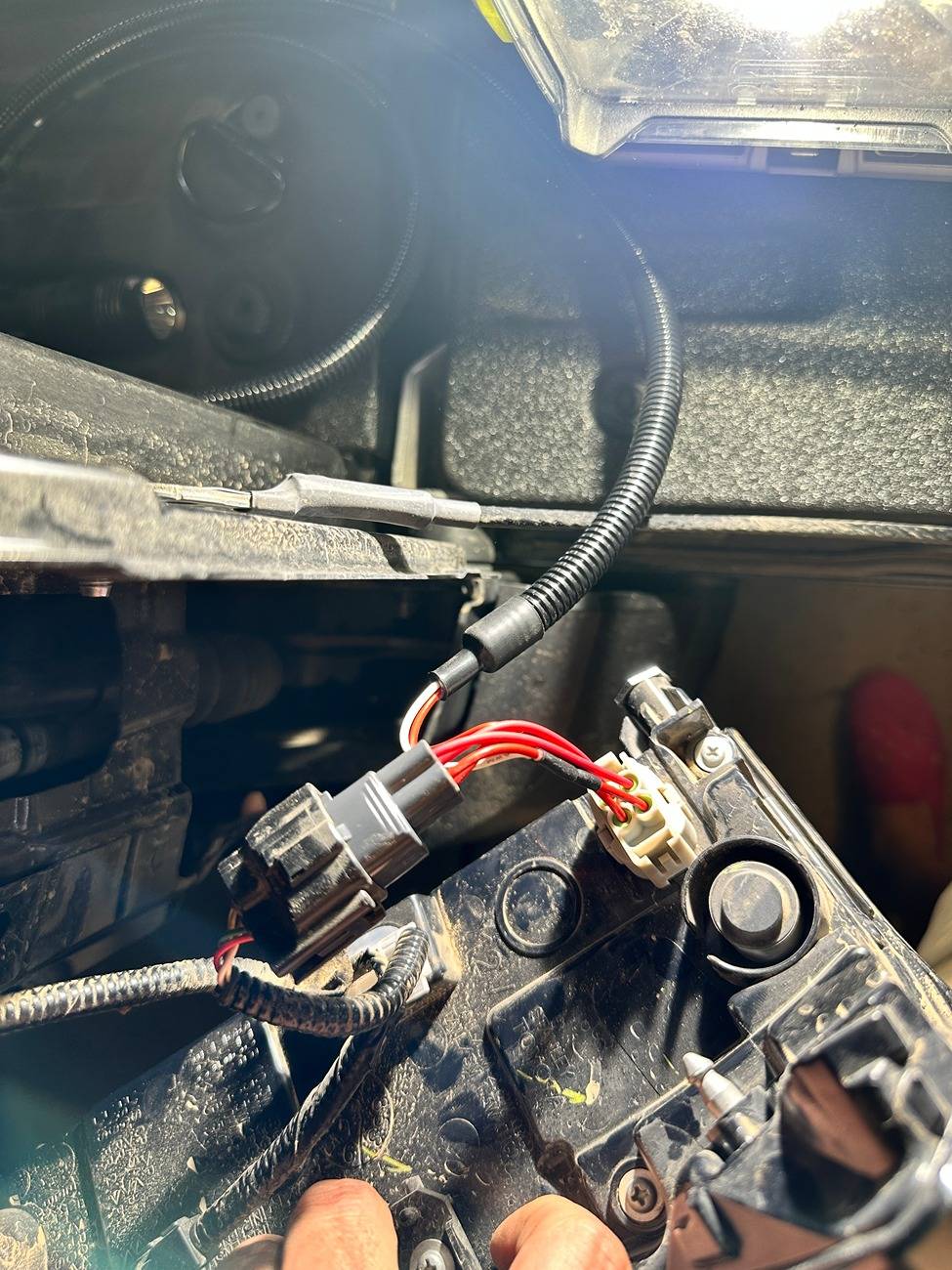

6) Plug in the taillight adapter harness between the OEM harness and the taillight. Route the wiring down through the crevice

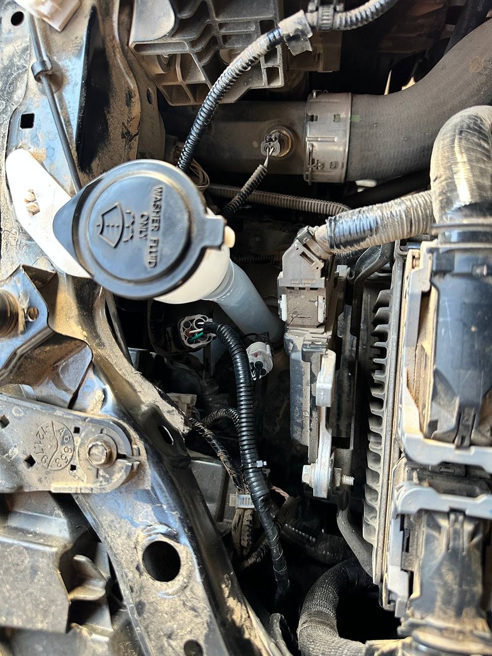

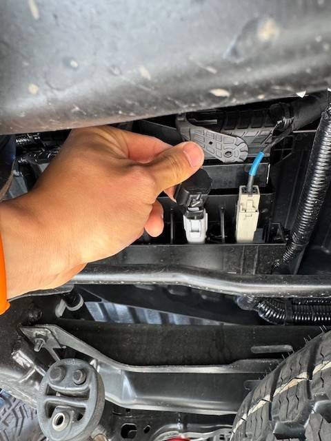

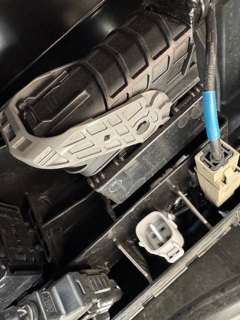

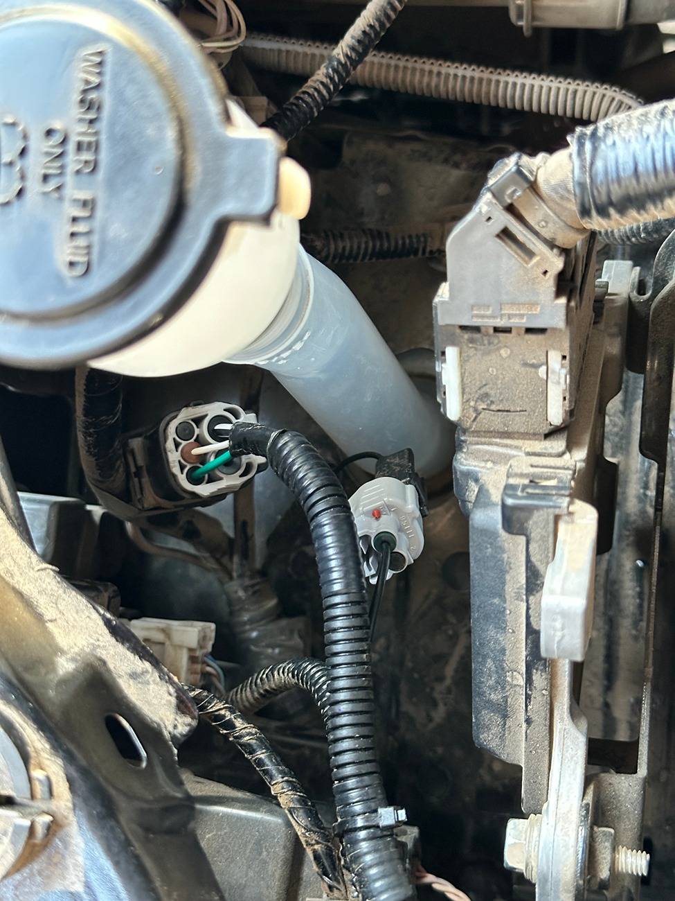

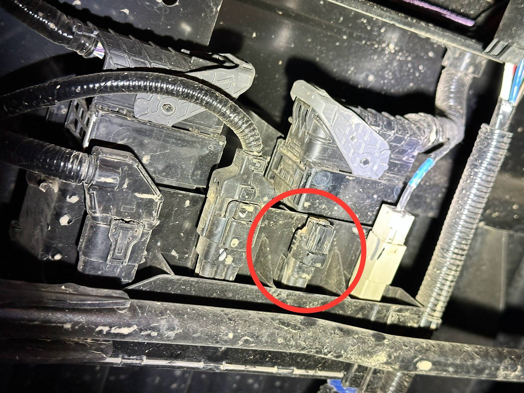

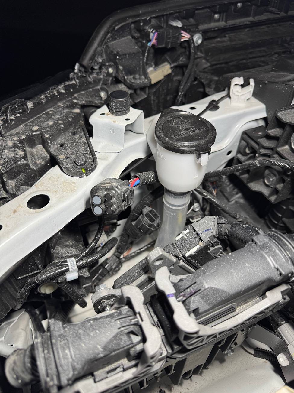

7) Head up to the engine bay, and remove the dummy plug connectors from the AUX connectors. Plug in your 4-pin to 2-Pin OEM pigtail between the two AUX connectors. This is how you get power to the rear AUX port under the truck. **Side Note:** You may notice I have some additional wiring going into my jumper harness here; this is because I have ditch lights for the front wired into here as well.

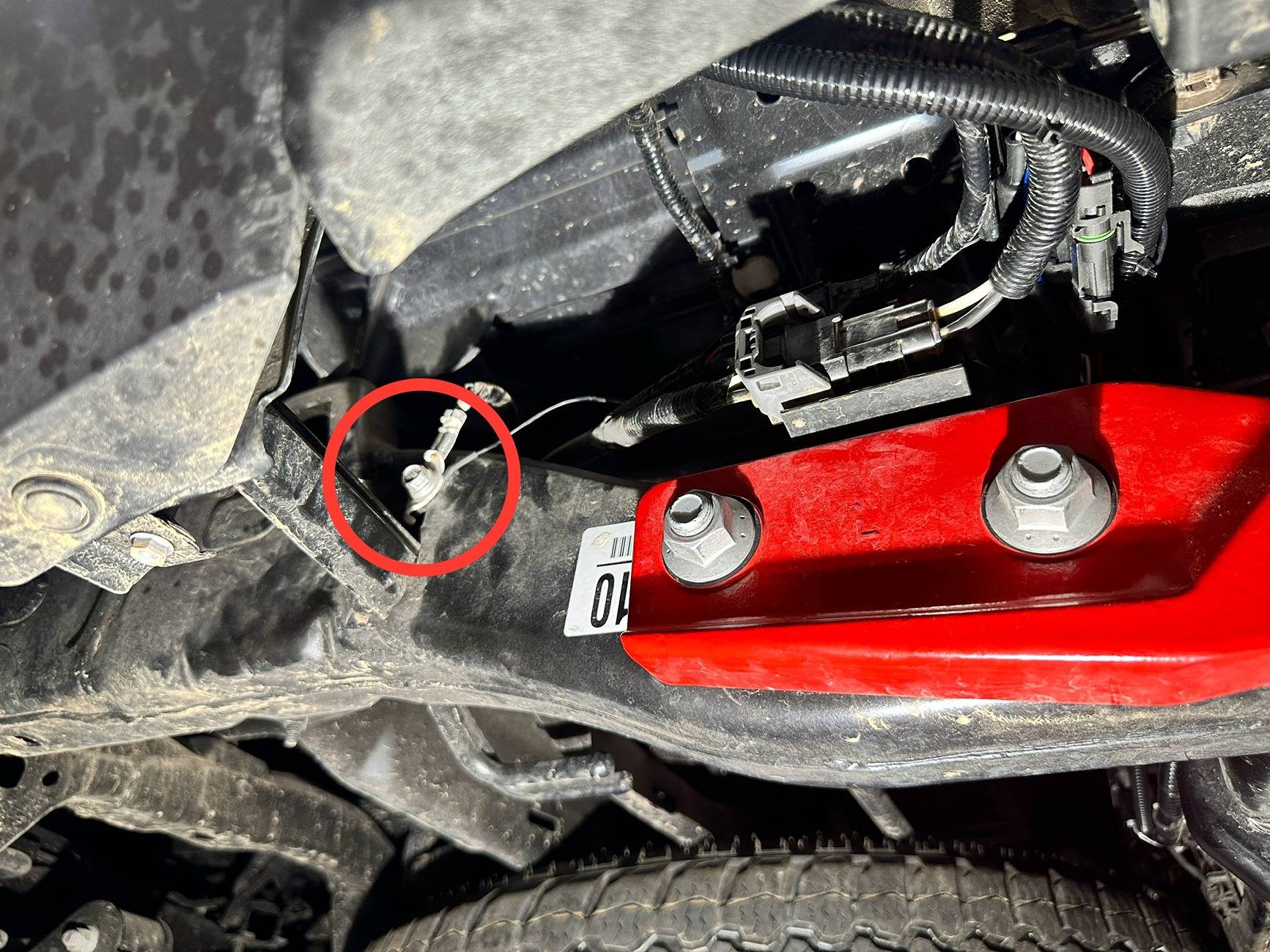

8) Head back to the rear of the truck, and remove the dummy plug connector from the rear AUX port. It can be found here:

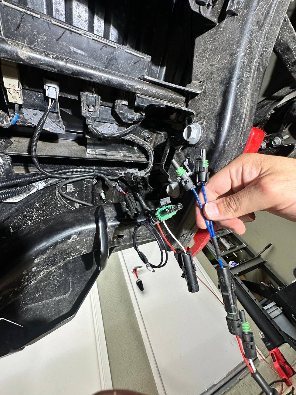

9) Crimp & heatshrink the BLACK wire from the OEM 2-pin pigtail onto the SPV single pole connector. I don't have a photo of this, but you get the idea from Step 10.
10) Plug the 2-pin pigtail into the AUX port, and begin routing all of your wiring.
11) Route the taillight adapter harness down to the Short Harness. This is pretty obvious, but white goes to white (the white wire is power for the halo backlight). The red wire from the taillight harness will plug into the SPV 2-way splitter, then one end of the splitter will go to the Short Harness; the other end of the splitter will plug into the single pole connector that you spliced into the OEM pigtail (the red wire is power for the reverse/spreader light). Additionally, plug the short harness connectors into the connectors running to the Rigid lights.
12) Run the ground wire to here. I tried several ground locations, that for whatever reason didn't work out. This one works perfect and is up and out of the way.

I installed everything and ran into an issue, the white wire came out of the weather protector. Is this something I can fix, or do I need a new harness?
2024 Tacoma HOW TO: Rigid SR-L Series Lights for ARB Rear Bumper Installation 20250403_193424
gasgasman
Dec 28, 2024
98
104
Pearland Texas
Tacoma Trail Hunter
The connectors are really poor quality.
You should be able to push it back in.
If the wire came out, you'll have to recrimp it.
SPV Parts
Sep 12, 2024
77
Greenwood IN
F-150 Raptor, Ranger Raptor
Well that certainly doesn't look right and we don't want you to repair it. This isn't a common issue.
If you email us at info @spvparts.com. I will send a replacement. I can't see your real name via the forum. If you prefer, you can also send a PM here with your real name/address.
It looks like the white wire is a little bent/twisted? were you trying to shove it in a cavity? or pull it through one?
And for clarity, so we know which harness. Is it the SHORT Rear harness there? It appears to be.
AnthemAVM
Michael
Mar 29, 2025
US
25 Trailhunter
John,
I did try to push the wire back in and that is why it got bent. This is the longer harness. I will send an email, as I also want to order the S1 vent lights.
Thanks
Michael
