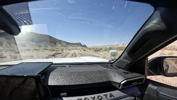

Months back I installed white Rigid pod (ditch) lights, mounting brackets, and wiring harness all from SPV. The white is a near identical color to my Ice Cap colored Trailhunter. The ditch lights are wired to AUX 2. My profile photo shows from the outside and here's a cab photo looking out to the right. It was a very simple install. Since the Trailhunter (Rigid) light bar spreads straight out and then to the sides, I aimed the pod lights to start where the light bar ends. It is about a 175 degree lighted pathway. NOTE: it is a very tight fit opening the hood with the light on the snorkel side, so be very careful when opening. I actually turn the pod light facing inward.
