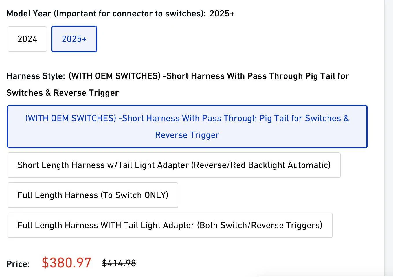

I'm sure this has been asked and answered ad nauseam but if I wanted to order these lights for my 2025 TRD Pro, I would order this:
2024 Tacoma HOW TO: Rigid SR-L Series Lights for ARB Rear Bumper Installation Screen Shot 2025-04-10 at 5.21.16 AM
Just wanting to make sure. This will trigger them with the reverse lights and I will be able to toggle them with the AUX switch also? And give me the red running lights when my lights are on? Am I correct on this? Once this is confirmed I will make a purchase of your remaining stock.

Hi John,

Hi John,
I must have missed some replies. Sorry.
You are right on how they work.
If you haven't purchased yet, we just sent our last one oh hand. However, they will be back. Just unfortunately delayed.

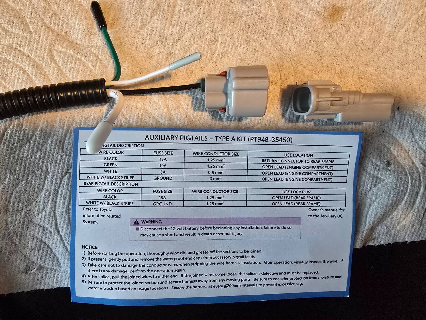

I have my SPC kit for my 2024 Tacoma Pro and saw on the Rigid site that these lights only use 1 amp, which I would assume would be 2 amps for both.
https://www.rigidindustries.com/sr-l-series-off-road-spreader-pod-red-halo-pair-53122.html
I am thinking of changing the rear connector pigtail in the engine compartment to use the white 5 amp wire (AUX3) instead of the original black 15 amp wire (AUX1) which would then free up to use AUX 1 (15 amp) & AUX2 (10 AMP) for other accessories up front in the engine bay or in the interior.
It seems like a waste to use up my 15 amp wire and fuse if not much power is needed. Any thoughts?
Would 5 amps be enough? If it needed a bit more I could use the green 10 amp wire instead.
