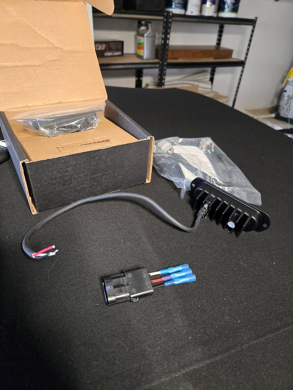

So I have a 2025,and trying to understand where the new adapter connect and what goes on the rigid lights?

Hopefully this helps you AND others, make sense of this...
But here is the breakdown...
This is the Rigid Kit- #20643
https://www.rigidindustries.com/2024-toyota-tacoma-arb-rear-bumper-kit.html
You will notice that it's priced at $399.99
It includes only 2 things... The flush mount lights... And the Rigid Crimp on harness with a 2 wire connector for the 2024 model ONLY...
Credit @rchrds for this photo and here are more on his post about the standard Rigid kit-
https://www.tacoma4g.com/forum/thre...-rigid-lights-with-spv-wires.8246/post-111768
As you see in the photo (and link) the Rigid kit comes with JUST a bare wire harness that crimps onto the lights and then a 2 wire plug. (Power and Ground) that plug into ONLY a 24 model. In 25, they changed the plug to a 4 pin connector. So for those of you with a 25, the Rigid kit wont work anyway..
2024 Tacoma New Rigid Lights for ARB Steel Rear Bumper 1754764553004-uk
So... in short, for $399... You get that harness and ONE set of flush mount lights....

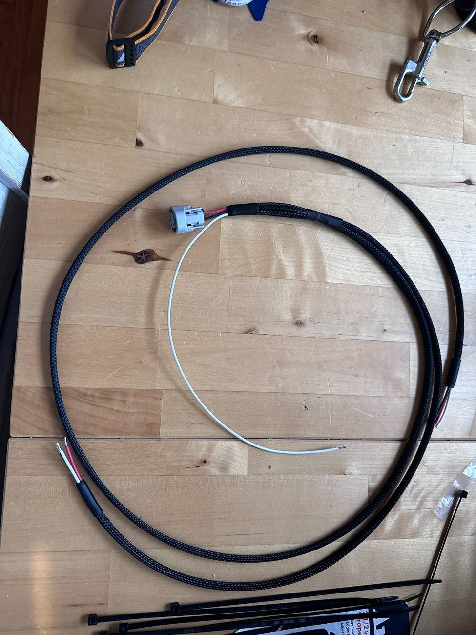

Here are our harness options separately...
https://specialtyperformanceparts.c...y-vehicles-see-details?variant=46735625617640
For the Tacoma, with our Tail light adapter... It includes 2 add on WEATHER PROOF connectors rather than crimping the lights to the harness and then they just plug into our harness and the tail light adapter.
The short rear harness with tail light adapter will power the red backlights with the tail/running lights automatically.
It also powers the white light when in reverse.
Its price separately is $74.99
So... If you add up $74.99 and $304.99.. individually its $380. That's $20 less than the Rigid Tacoma kit...

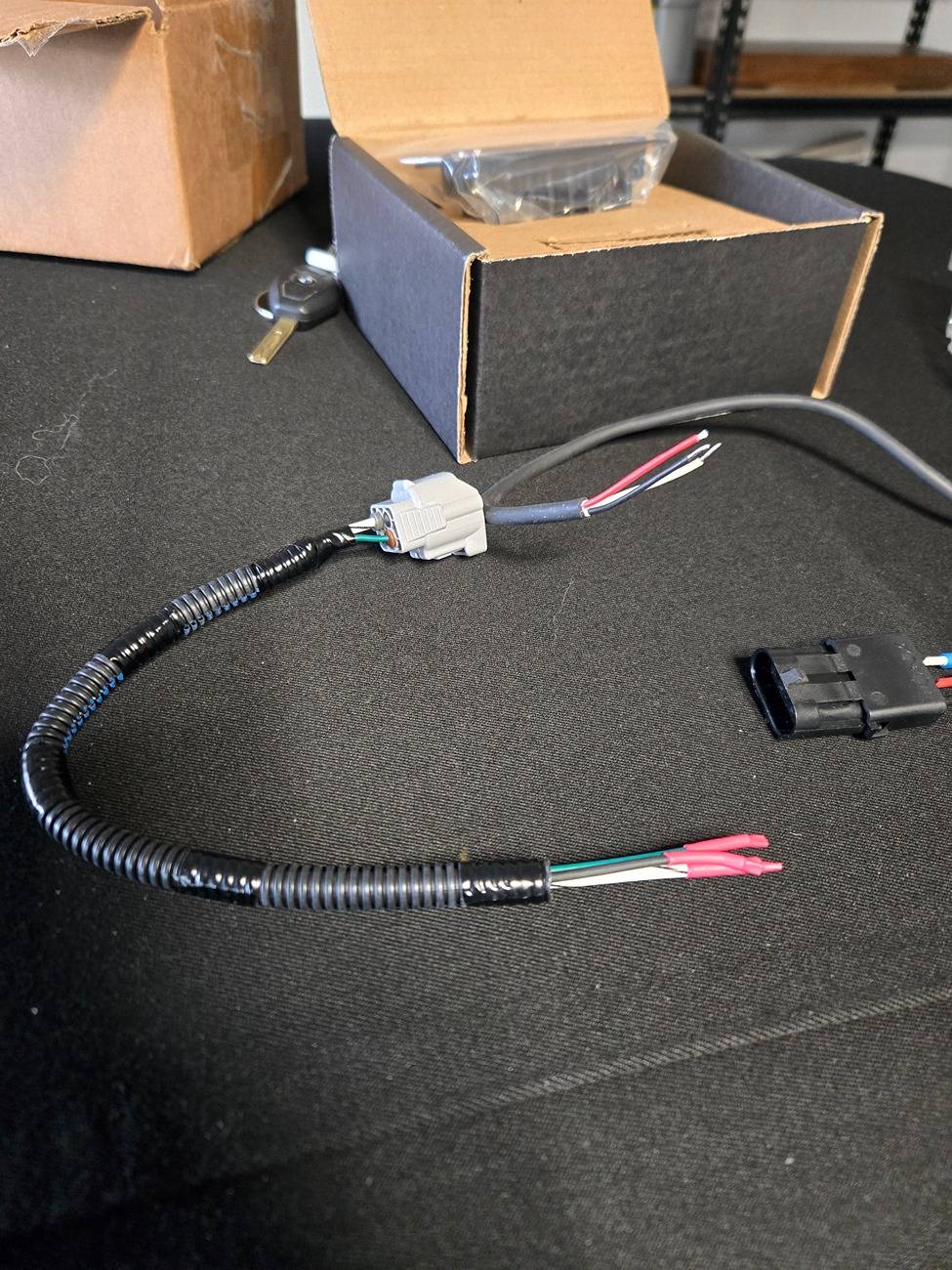

Awesome! That makes sense. Since I already ordered the 399 kit from rigid I’m outta luck there. I do have a 24 so at least I have that going for me. Which of these connector options is the correct one for the rigid?

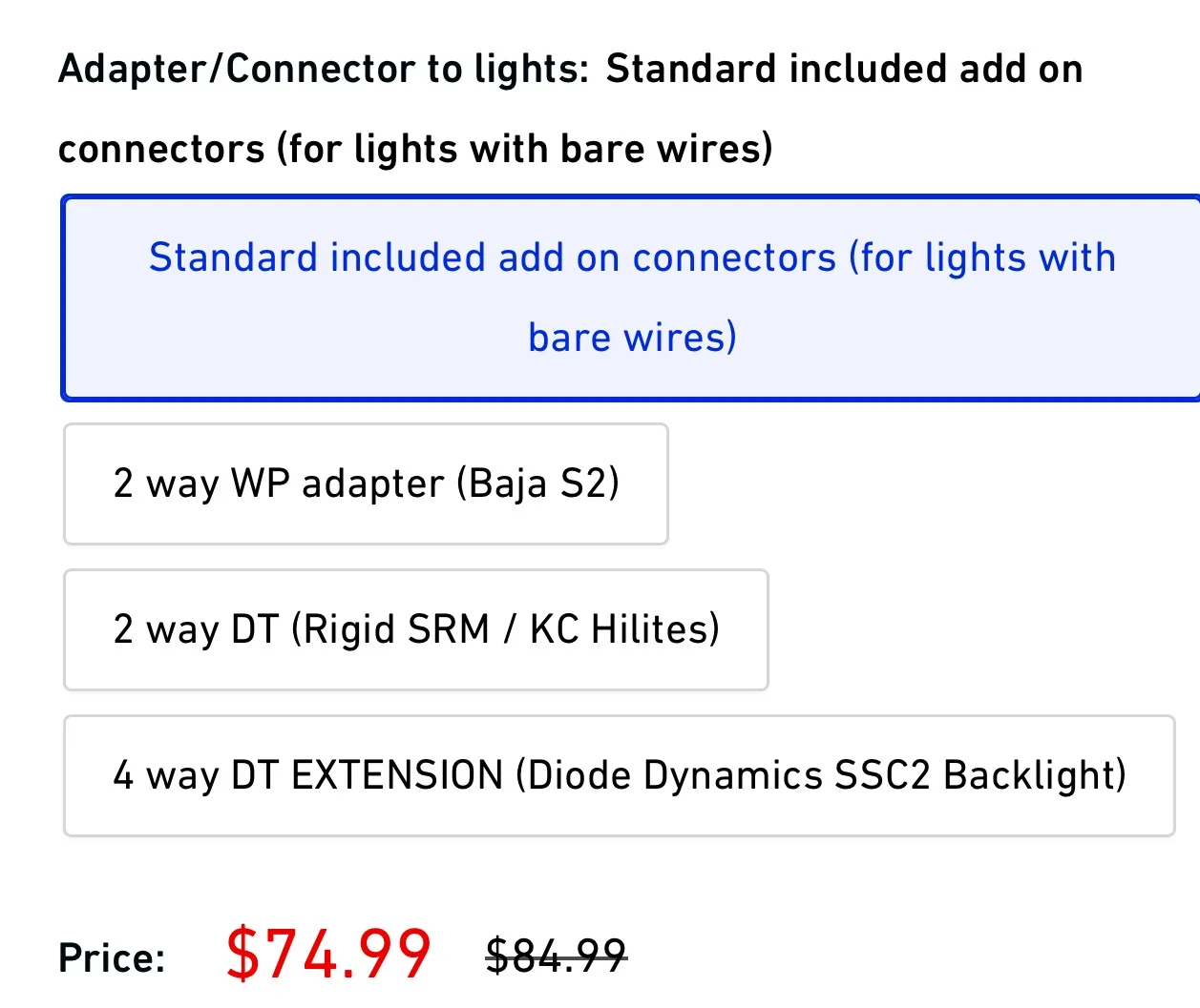

"Standard including Add on Connectors (For lights with bare wires)"
Since Rigid SRL's have bare wires. This allows you to add weatherproof connectors.
Thanks!
