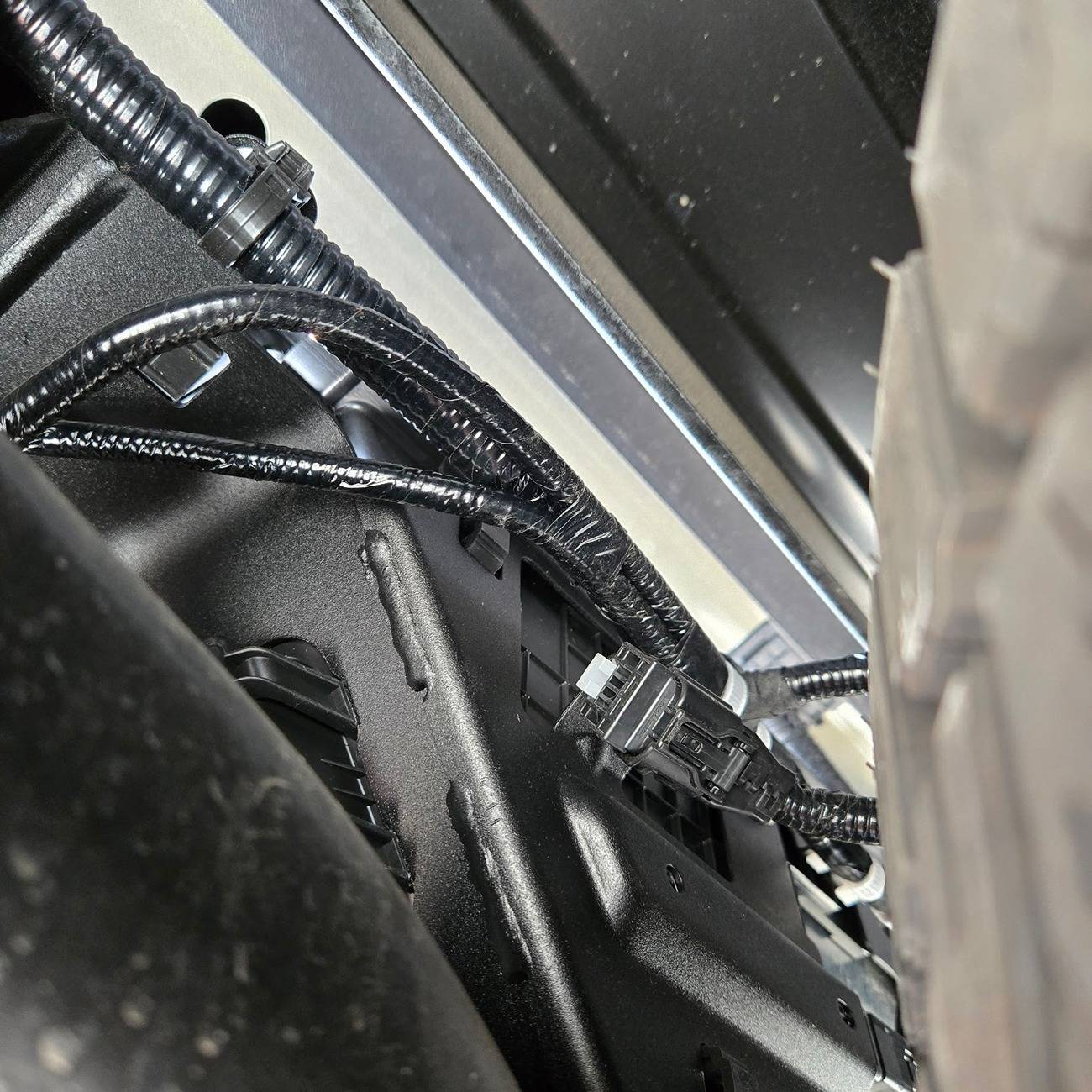

I installed an ARB rear bumper on my truck yesterday. There is one unused connector on the passenger side. Guessing it mates to an accessory like lights. Does the kit in this thread connect directly to this connector? If not, anyone know what it is for?

Is that just one of the 3 aux switches ?
No, that is on the truck driver side. This is part of the ARB bumper with the new harness (Rather than reuse stock).
Good thought as I wasn't descriptive enough

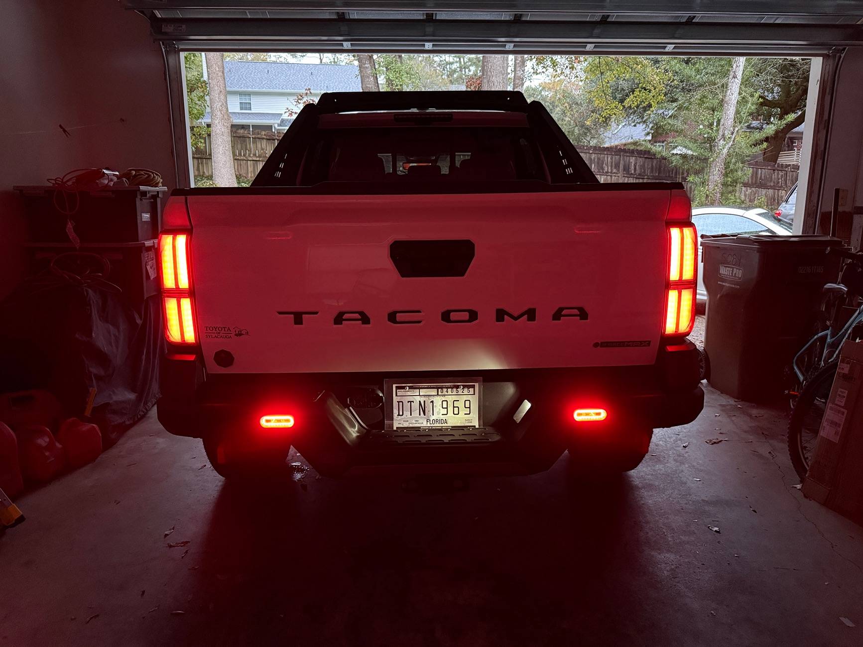

I bought my Rigid lights from SPV (ask for John). They have a plug and play option and mine are used as extra taillights at night-RED-and when in reverse, they are bright WHITE. The harness with adapter is plugged in the back of the left taillight, did not want to use rear AUX plug, and did not use Toyota pigtail. Talk to John he will send you what you need if you ask.
The passenger side in the bumper is very difficult to install especially if you have fat fingers like me. The two little screws that hold the blank plates in place are reused for the lights

Do you also think it’s much brighter than the taillights? Looks similar in this photo
In the dark of night on the road I think the Rigids are a little brighter and it is because the Rigid red is a shade darker than the Toyota red. I am going to buy some Lasfit bulbs and see what happens.

your tail lights are sealed LED
I'll try and crawl under my truck later this afternoon and see if I can see the plug you posted
