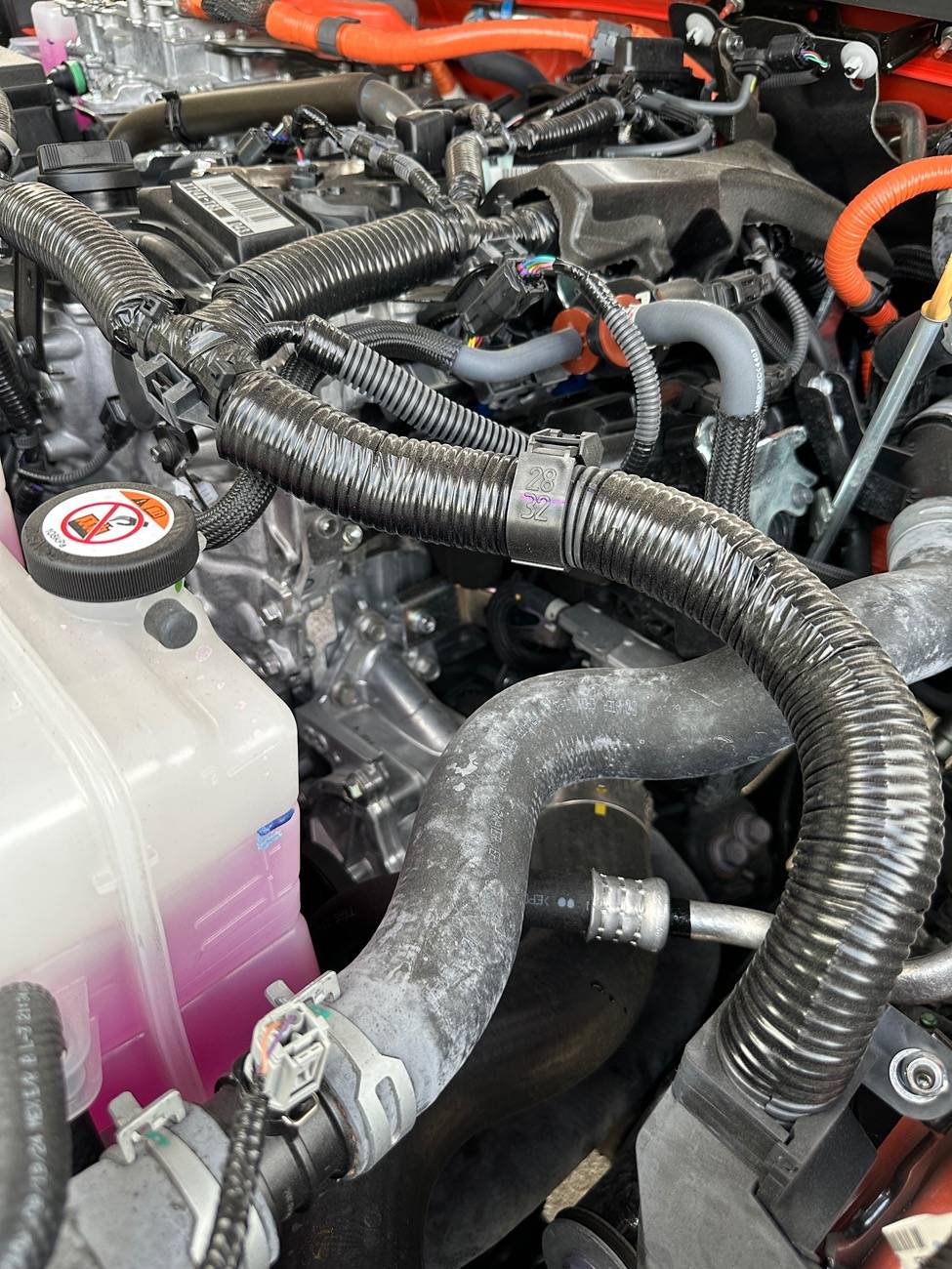

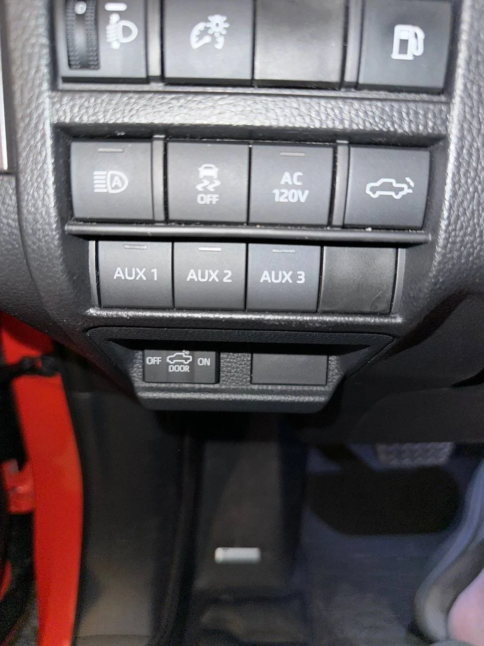

U.S.-spec, 2024 TRD Off-Road, premium package, iForceMax. Definitely have the factory aux switch package, definitely *do not* have an alternator.

Yes, but you don’t have that fourth aux switch

Ah, didn’t catch that the 25s are coming with the 4th switch. Turns out reading IS fundamental…. ;P
