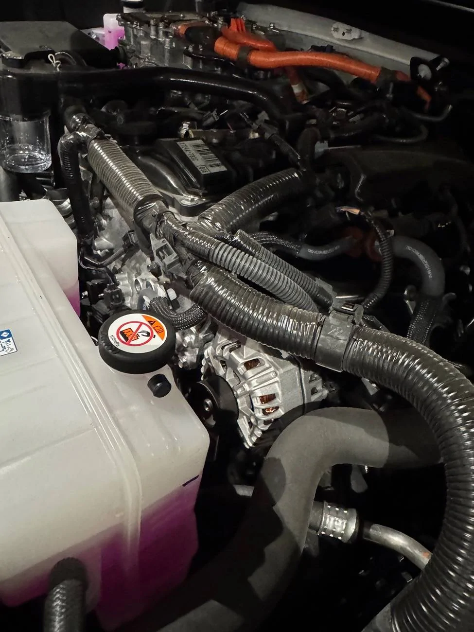

Looks to me like an alternator on my Hybrid, tought they had an electric motor generator only?
Pics or it didn't happen.
Are yours the same?
Thanks
