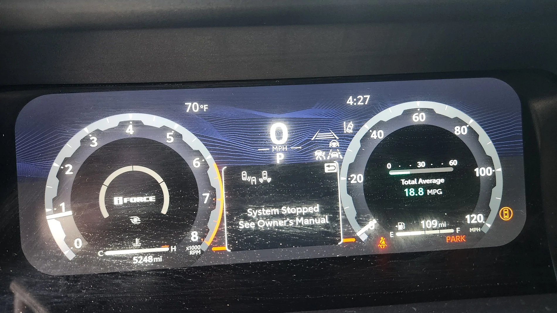

Hello
So glad to find this thread as I'm going through it to.
I had an ADD bumper installed on my 2025 tacoma with the performance package. It has the BSM sensors aka blind side sensors.
I had mine professionally installed.
I drove it home and it was ok for a day then I got the same sensor errors you did.

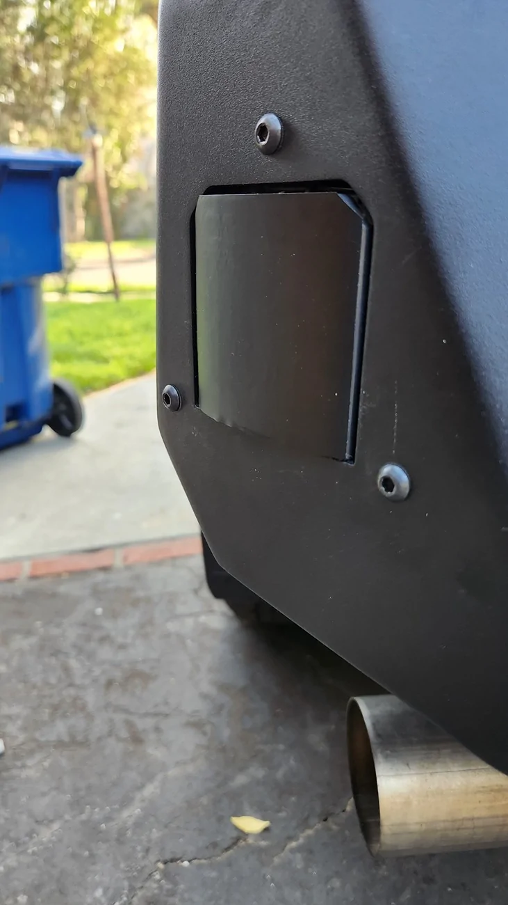

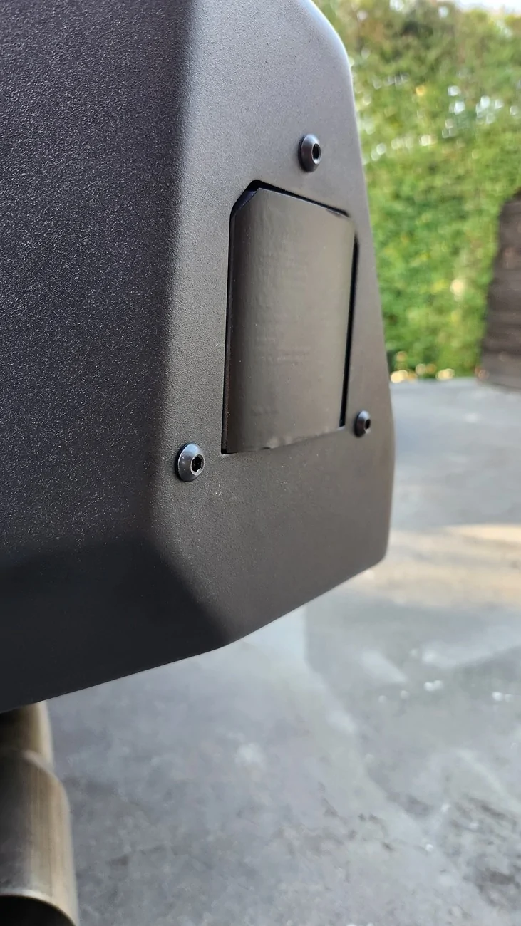

After going back and forth with ADD having me disconnect wiring and battery over and over. Shaving down posts to get the sensor to stick out more. Nothing worked.

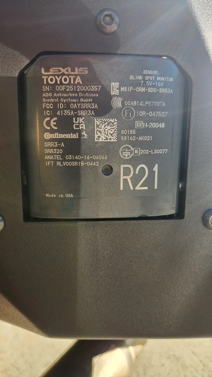

I took it to a calibration shop and they said the sensors were off angle by 6° plus and minus each side.
After that I took it to toyota and yes paid 1300.00 to fix the issue.
First round I took the truck home and it only lasted a day.
The errors came back and I brought it back to toyota.
This time they had to take the bumper off and shim the sensor to get the angle within the 3° tolerance. That's tight!
FYI yes the sensor are left and right and need to stay in that orientation as they are calibrated in that position.

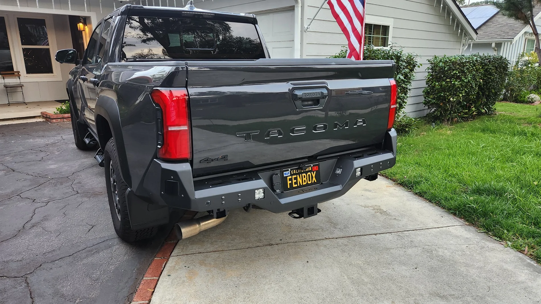

In my pic you can see my ADD front bumper. I like it, but i had a pro install it with baja lights
I had no problems with the front bumper, but later I'll want a wench. I hope there's no issues.
