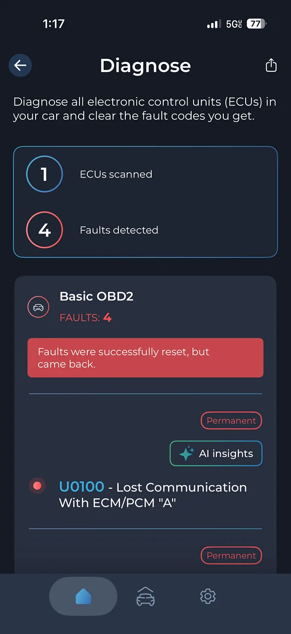

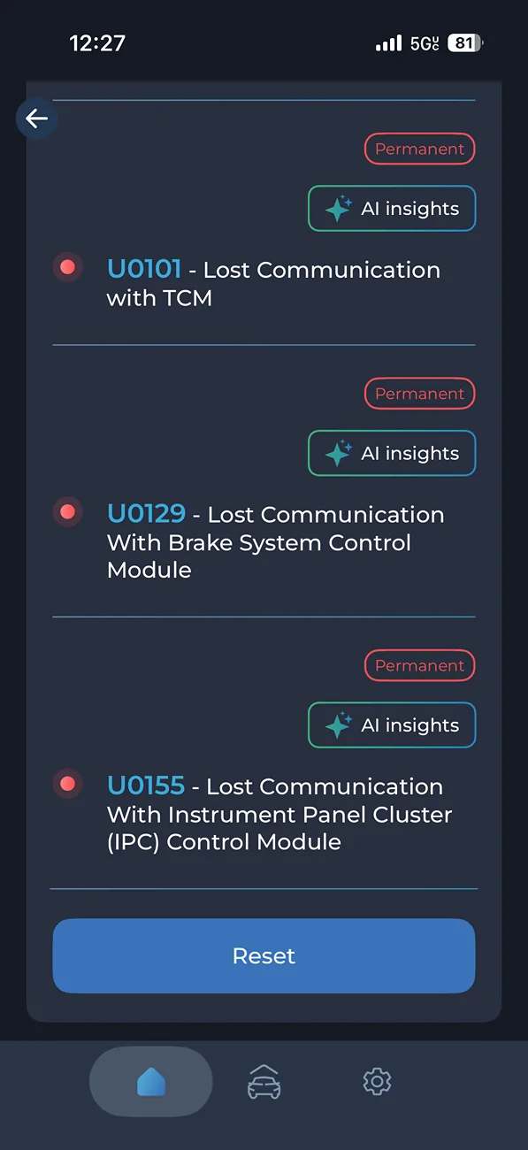

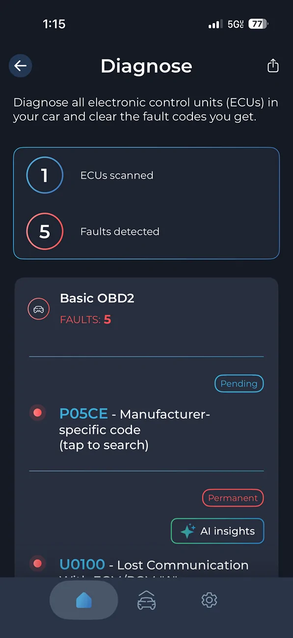

Just completed the recall for the 12.3 dash 25TA08 notice.
Dealer had my truck for 3 hours.
After I got home I plugged in my Carista and had four codes (the Fix consisted of four software updates, hmm)
Called the dealer today and their response is to drive it awhile and if they don’t go away by Friday to give them a call to schedule it in for service.
I rest the codes through Carista and each time they reset but reappeared.
Here’s some screenshots;

Just quickly glancing over that, looks like they may not have unplugged the battery when disconnecting stuff?
Idk, but that shouldn't happen
I thought their reply just drive awhile was BS, I unplugged the battery for bit today to see if that would change anything but it didn’t. So, down to the basement to find my old OBD reader and it did not detect any problems. I opened a report with Carista to see what their comment might be.
