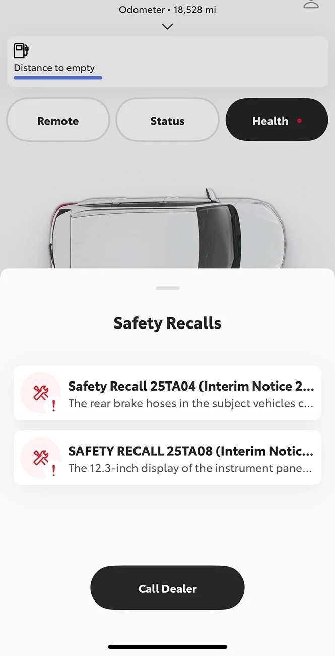

Anybody else?
Starting to stack up the recalls lol.
I received this recall toward the end of last week. I just had the brake and blind spot recalls repaired. I contacted the dealer and they didn’t have a remedy or solution. I see on your picture there is a remedy drop down. Is there a remedy now?
Nope, just an empty drop down. I'd imagine this one will be a while in the making, unless it's some easy OTA or dealer SW update.

Can’t imagine this will be more than a software update. They’re definitely not ripping my dash apart to fix something I see as a non-issue.
If your instrument dash goes blank then it’s a huge issue because now you won’t know how fast you’re going or any other important info during operation. lol.

Looks like my VIN is affected too. Haven't had any issues... yet but hopefully it'll get remedied before it happens. On the plus side, the brake line fix is available (FINALLY) so I'll be getting that fixed this week!

Anybody else?
Yep, already did the Blind Spot Monitor reprogram and these two I will schedule with my 20k service coming due soon.
There's no fix for the screen issue that I'm aware of

So, is this recall involving the display that shows the speedometer or the display that shows the infotainment? Posters on this thread are referring to either/or?
12.3 inch tachometer/instrument panel. So the fully digital gauge that sits in front of the steering wheel.
