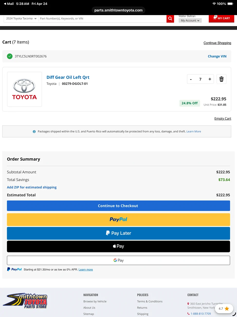

Check this place out for OEM diff oil. It is expensive but personally for me I’d use OEM.
