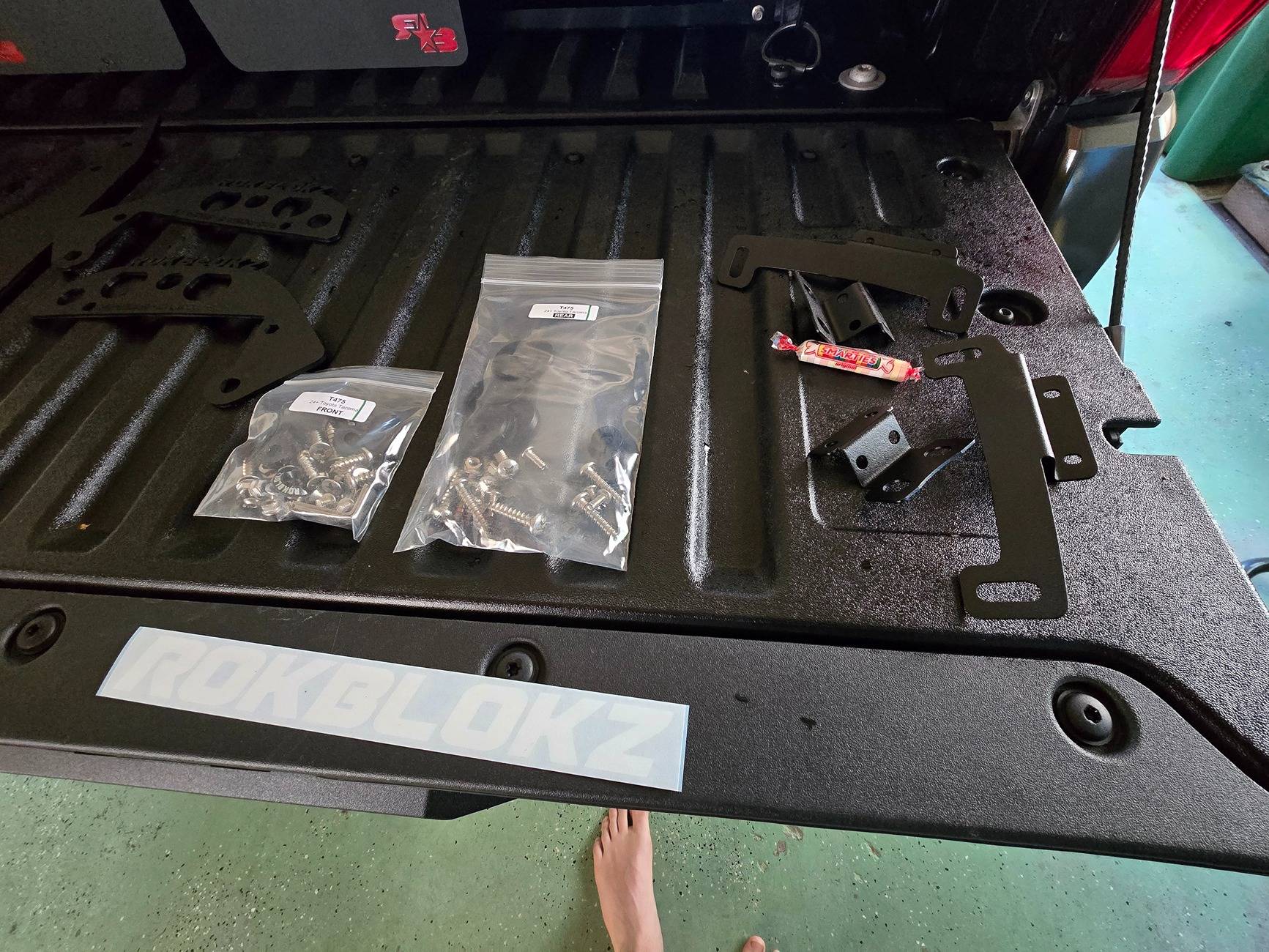

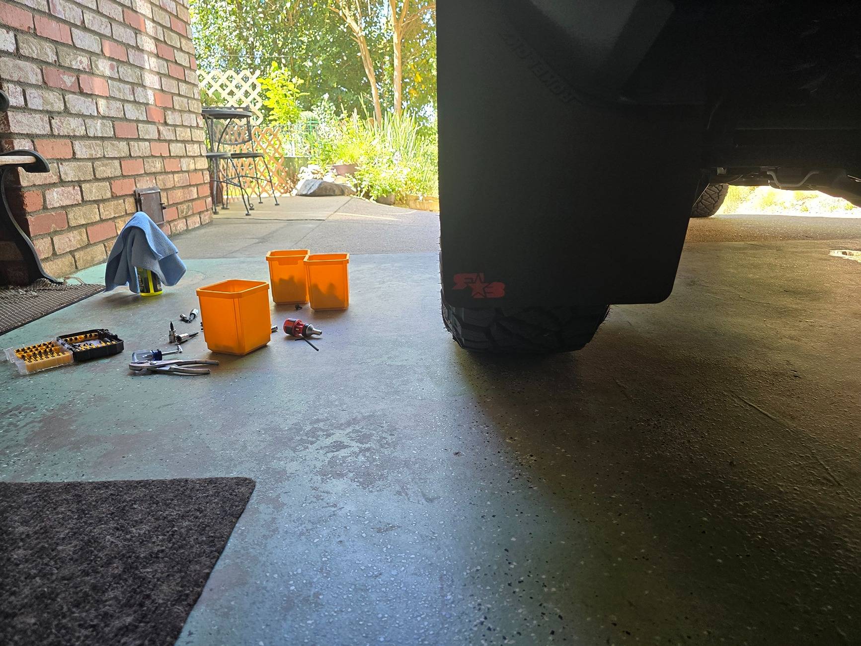

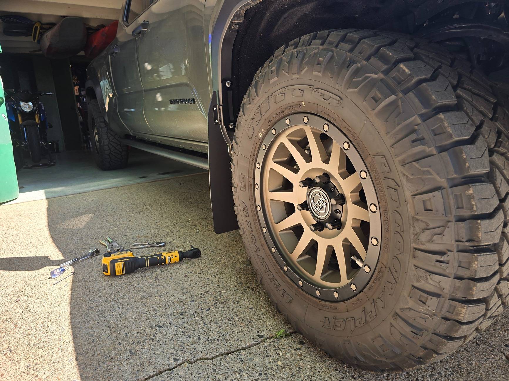

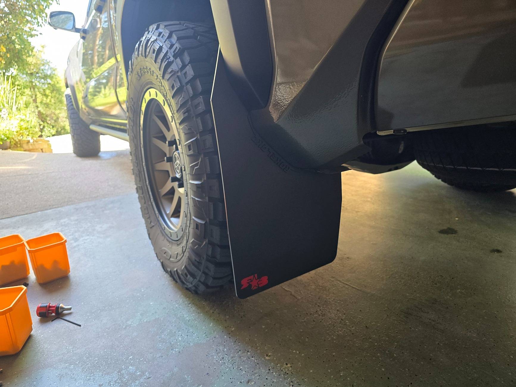

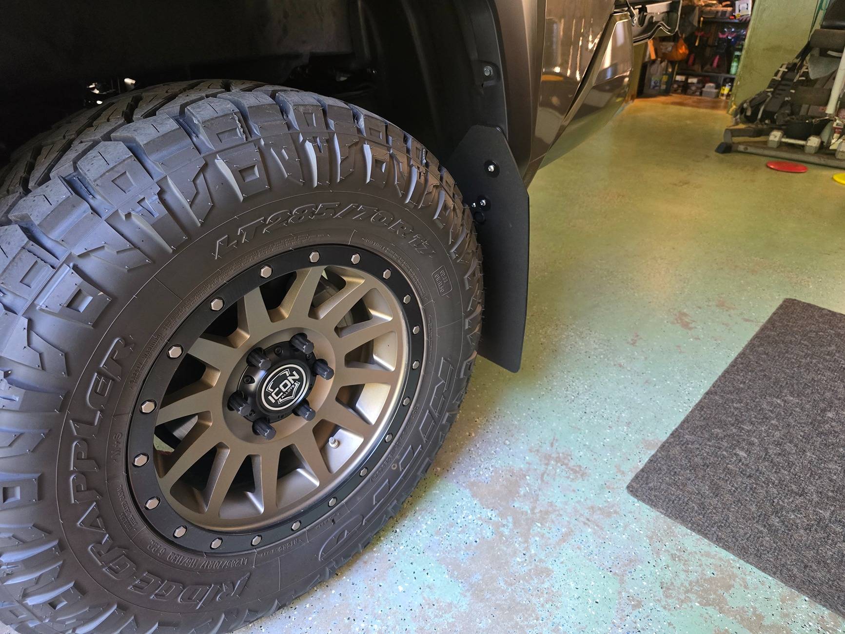

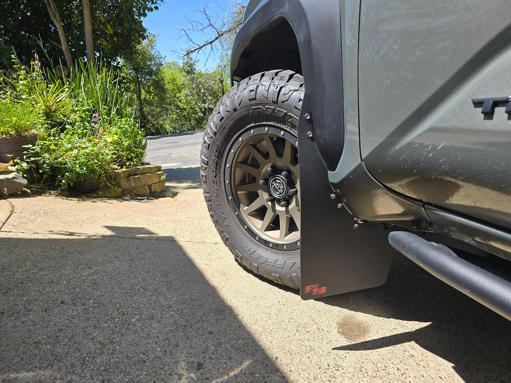

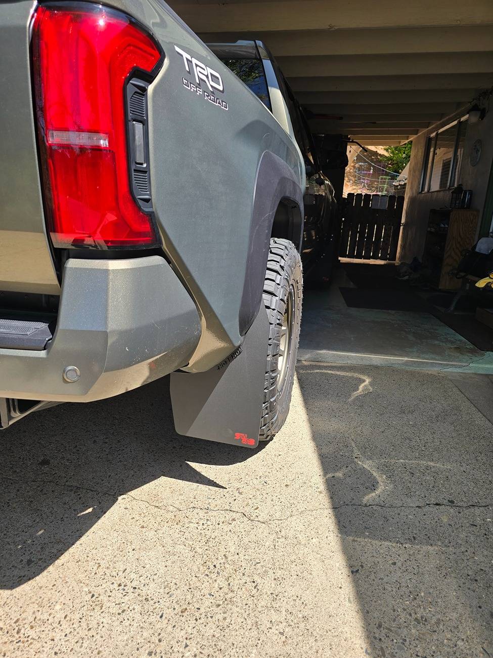

Installed the RokBlokz High Clearance XL Mudflaps to hopefully help with protecting the paint since these trucks seem to get scratched just looking at it ?.
Ordered them from RokBlokz, and they where delivered in less than a week which was sweet. Install is pretty straight forward, as they bolt up into existing mounting points, and takes about an hour or so. They look pretty good, and hopefully they hold up over time.

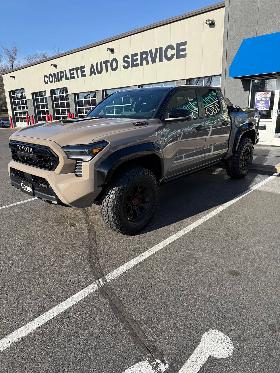

New Wildpeak R/T’s 285/75R18 on stock Pro Wheels (which I’m a fan of). Very similar to a 35 diameter.
Around an inch extra clearance all around, big fan of the look!!

Any rubbing at full lock? Potentially flexing?

Full lock reverse hitting the street gutter on my driveway just hardly touches the felt liner on the collision bracket.. I think I’m going to just pop the rivet clips and take the felt liner off and spray it with RP-342 for rust prevention. I am almost certain it will be fine at that point.
it’s so minimal and unique circumstance to occur that I’d say you could just leave it there honestly. Though I’m OCD (plus it’s so easy to remove that pad.
I must say, we’re essentially entirely encapsulating a 35” tire within the wheel well though.. which is crazy to think about how this works at all.
**Update, removed the felt liners in about 30 seconds and they now fully clear at full lock in reverse by about 2-3 credit card widths. No need for bracket removal.
