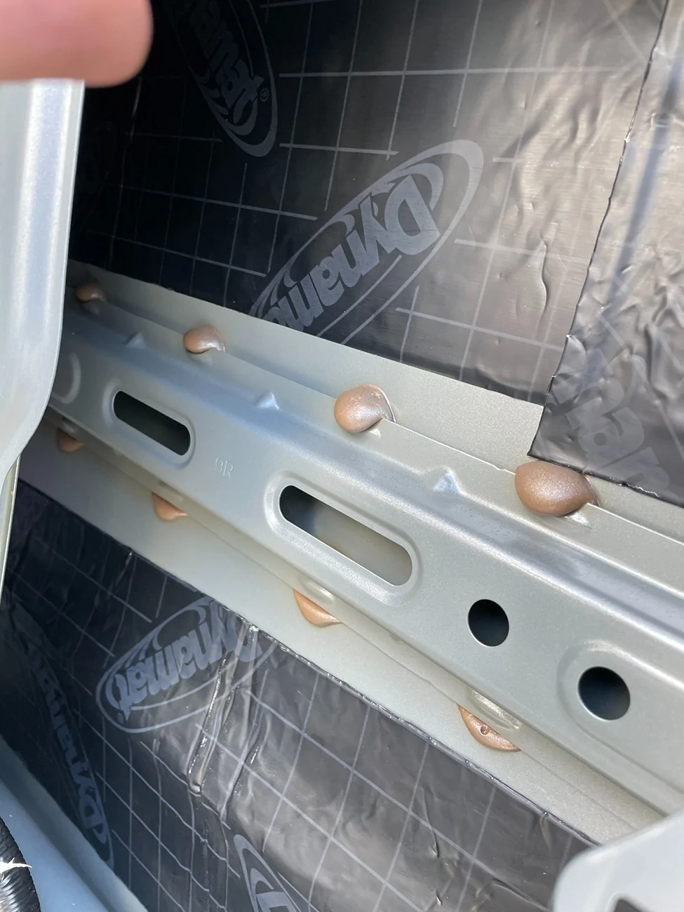

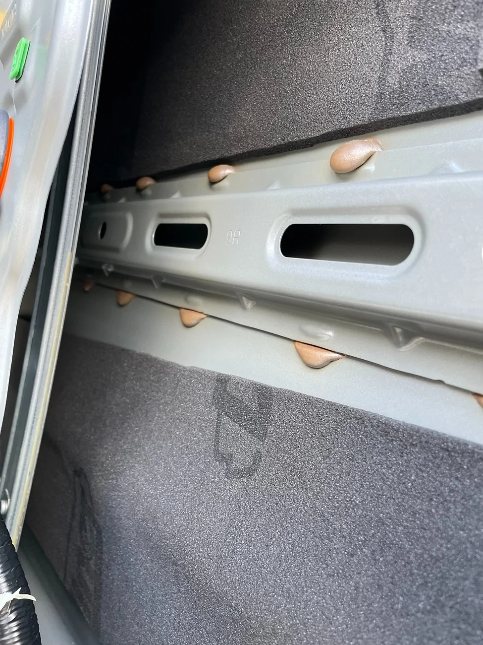

Today I had a chance to begin my sound deadening project and started with the roof because it is the most challenging part. The factory puts zero sound deadening in the roof because it will not reduce the wind noise unless you have a roof rack or lightbar up there. I have neither so you may ask why did I do this. Good question and there are 2 reasons. First, I live in Florida and we have a lot of heavy thunderstorms which makes it sound like a loud echo chamber. This is both annoying and distracting and may be a safety factor. Second, I also put a closed cell foam layer which is a thermal barrier. This is like adding insulation to your attic. It will make it cool down faster in the summer and warm up faster in the winter. The last picture shows the 2 clothes hangers in the rear. One has the cover already installed and the other does not. If you install the hanger into the roof and then try to install the cover you will likely pop the spring clip into the headliner. You will then need to undo the work you have already done to remove the headliner again and retrieve the spring clip. Ask me how I know. Never mind..... just a rhetorical question.

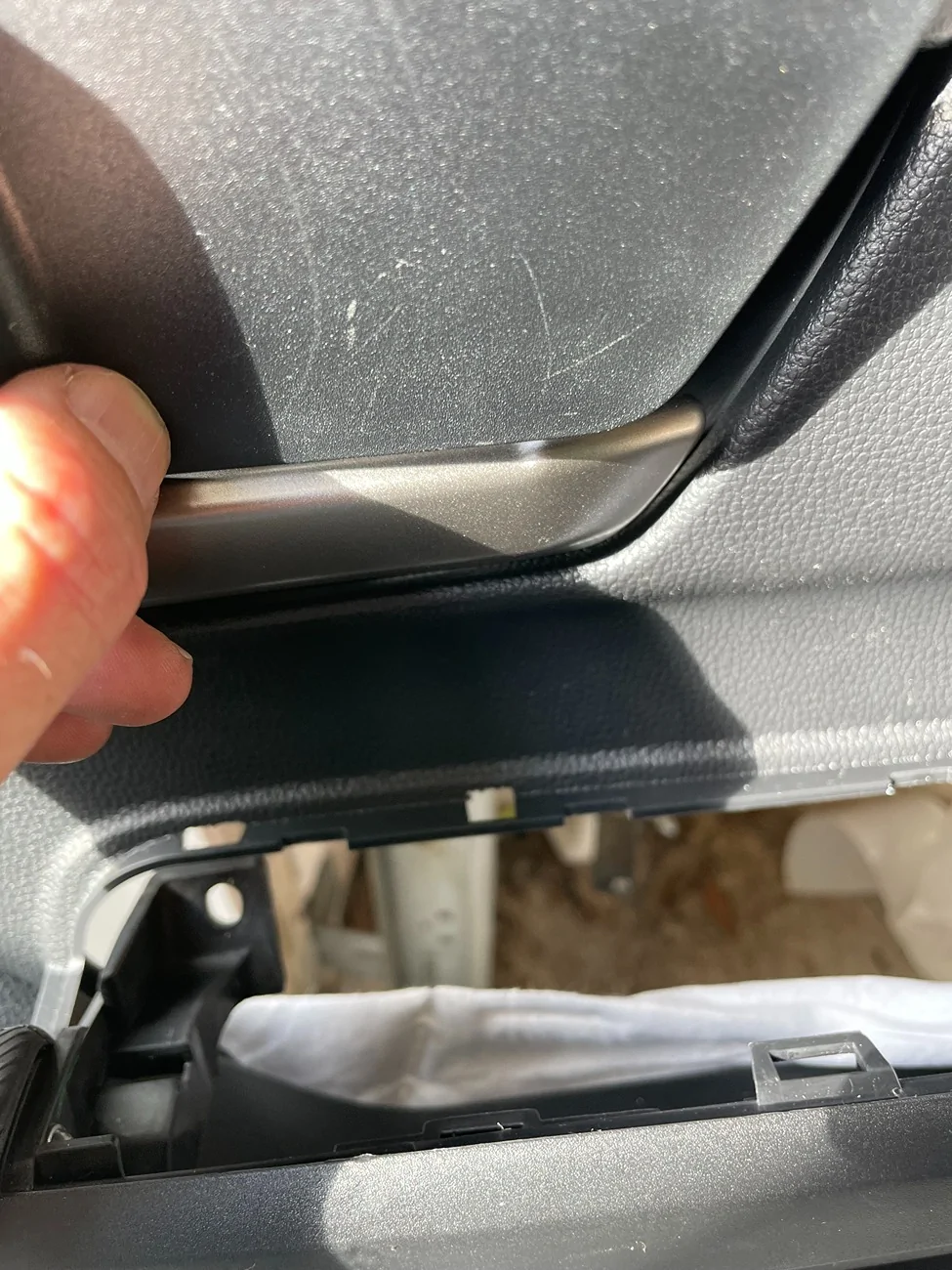

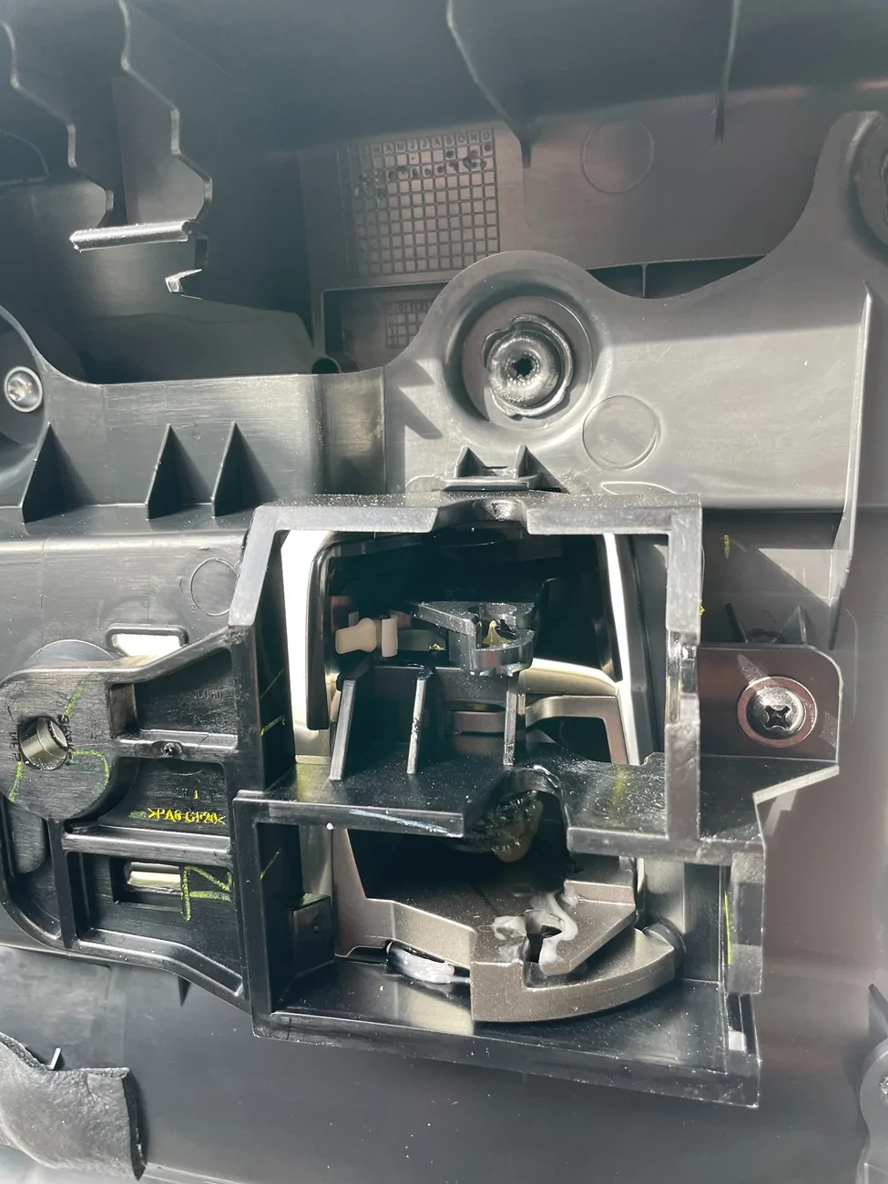

Today I had the opportunity to continue my sound deadening project. The factory does not include any sound deadening that even my 3rd gen truck had at least one strip in each door. I only had time to finish the front 2 doors with a layer of Dynamat and Dynaliner on the outer skins of each door. The last 2 pictures show the front and back of the door handles and locking mechanisms. I have done 5 of my own cars and trucks over the years and 2 friends vehicles but have never had such a hard time popping out the trim piece under the door handle. I wedged the trim tool over the lock and under the trim piece and had to use so much force that it knocked the locking button off the track. It was a challenge putting it back together. Using a hook tool works much better.
