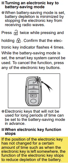

Unnecessary with current key fobs which automatically go to sleep when they haven't moved for a few minutes. If truly concerned, force the fob to sleep and it won't wake up until a button is pressed.
See your owners manual:
2024 Tacoma Y'all bother with Faraday Boxes for your keyfobs? 1771510742622-pi

No. Toyota fobs shut
I was about to post this same thing, and had an owner's manual screenshot ready. 😆
Current keys have motion detection and shut off at night. There's no need for any other preventative measures.

So putting it in battery saving mode is not really needed either?
I'd say it depends on the situation.
If I worked somewhere that there was risk of relay-attack and my fob's in my pocket I'd manually put it to sleep, since otherwise it'd keep waking up from movement.
Spare fob kept for months in a drawer that's opened regularly, I'd also manually put it to sleep just to save the battery.
At home on a key rack or side counter where it won't move until I'm heading out to the truck, I'd let it sleep automatically.
Looks like this auto-sleep feature is first documented in the 2024 owners manual, so I suspect it doesn't apply to 3rd gen models. I'm not taking any special care though being in the 'burbs with a very generic OR that nobody's taken any interest in the past nine years.

Can anyone confirm that the 2025 SR5 Tacoma has the automatic sleep feature for its fobs? When I search online I only find info about the manual locking of the key fob. Maybe that feature is only in the higher trim models?

It's mentioned in the 2025 owners manual - see above screen shots.
and with no caveats about just some trim levels, I'd expect it to apply to all.
