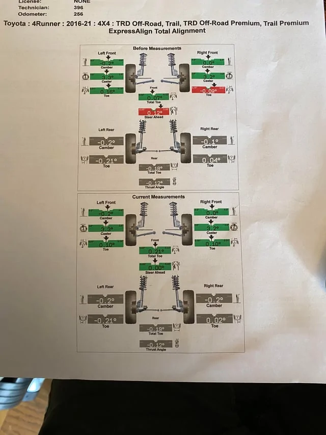

The original alignment was over a year ago (and about 22,000 miles) and I sadly don't think I got a printout. Here's what I got from the current alignment. It's certainly possible that the "before" specs aren't exactly how the Goodyear shop set it up b/c I routinely drive at speed down forest service and logging roads...
Toe in would explain your tire wear, why would they do that though and not just zero it out lol
Current spec is definitely better, they could have probably dialed the left toe back closer to 0.00
Your rear end specs look better than a lot of the 4 link charts I've seen on here.
Your heading on the print out reads 2020 - 2023 model Tacoma. Not 2024 - 2025 ???
Yup. Even after them updating their database the '24 specs weren't in it. The alignment guy said that's pretty common with Toyota in his experience. He claims it's often a year or two after gen changes before Toyota actually gets around to updating specs.
Not like the rear is adjustable without an aftermarket panhard bar anyways. The best any alignment shop can do is zero your front toe out.
Why the multi link guys have so much rear toe factory is uhhh a little weird...
But maybe it's just a Toyota 4 link thing, from 4Runner forum:
2024 Tacoma Your new truck probably needs an alignment 1000006758
4 link is never going to be as dead center as a leaf rear end, just more moving parts. The leafs also center the axle probably more accurately than the panhard bar.
