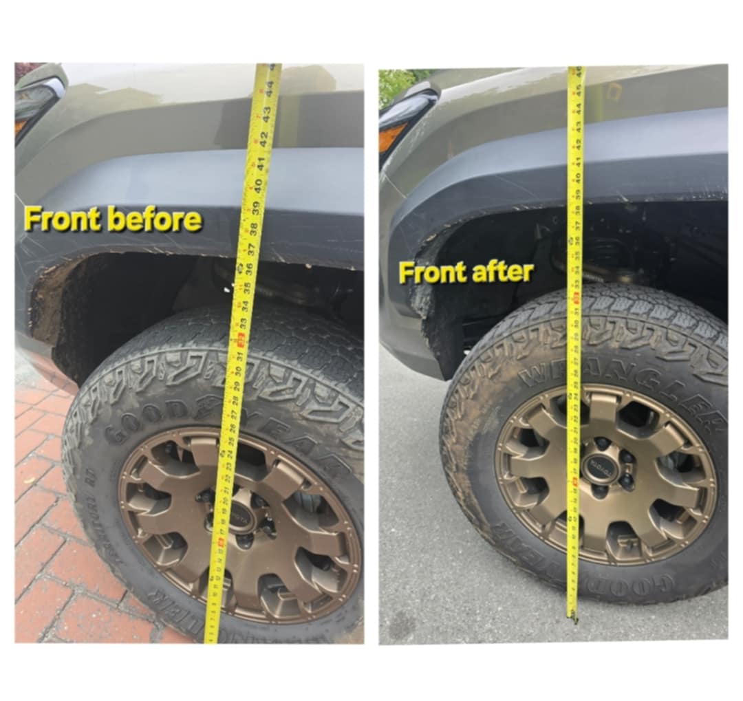

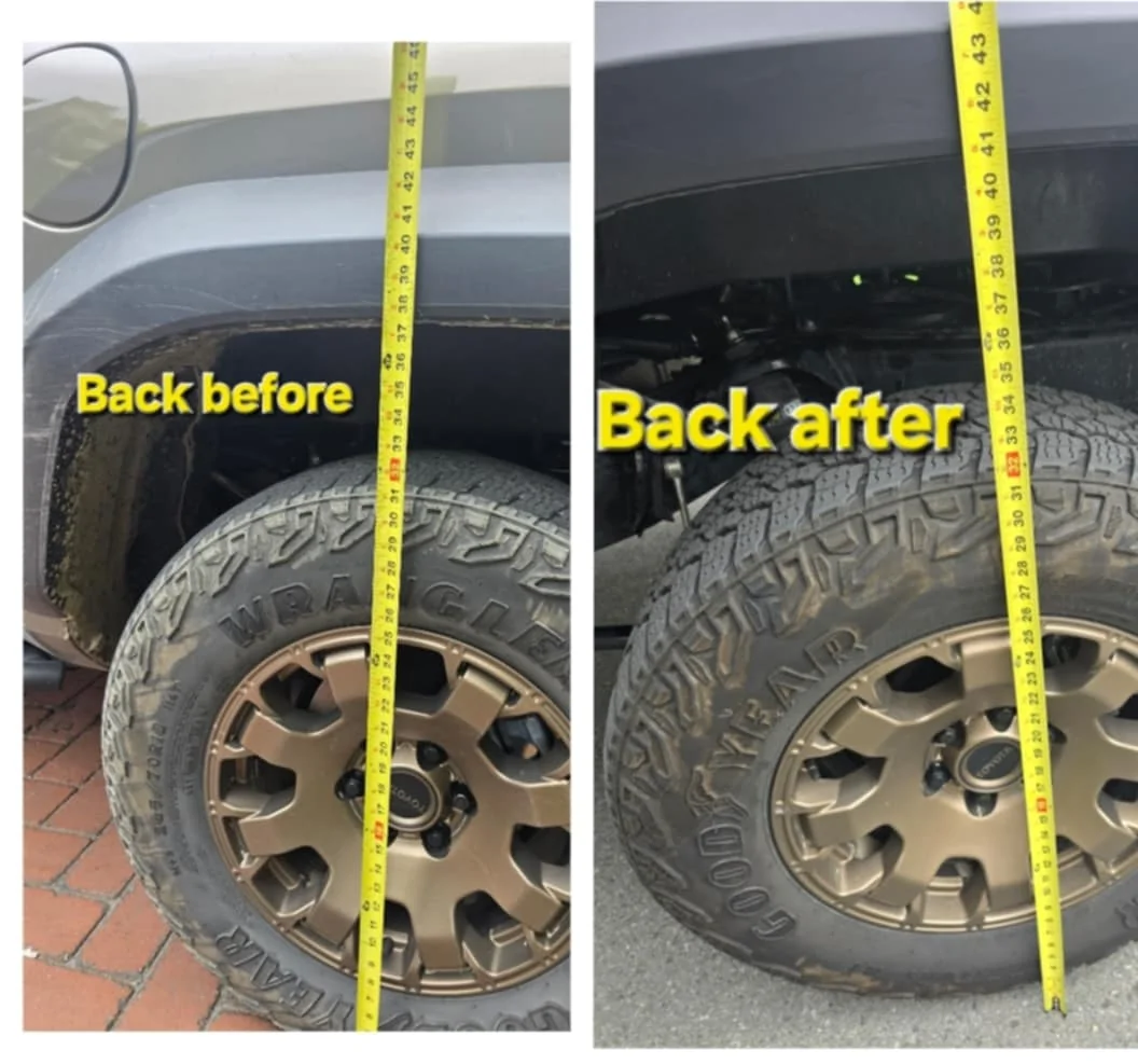

Changed coils on Trailhunter. Got 2 inches on the front and 3 on the back. And I can't believe how drives much much better - huge improvement. Even my mechanic was shock how trucks feels much better with stiffer coils.
2024 Tacoma Dobinsons Coil Springs installed on Trailhunter Taco befor
2024 Tacoma Dobinsons Coil Springs installed on Trailhunter Taco after
2024 Tacoma Dobinsons Coil Springs installed on Trailhunter Front befor
2024 Tacoma Dobinsons Coil Springs installed on Trailhunter Back befor
2024 Tacoma Dobinsons Coil Springs installed on Trailhunter Taco coils

I did my research and talked to them.

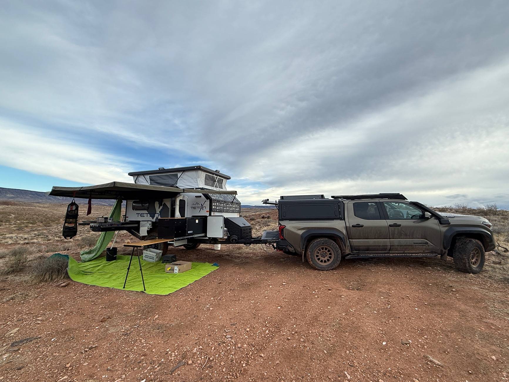

I need stiffer coils on back with AluCab canopy and camping gear and pulling 3500 pound trailer. These were the ones I was looking at. Hadn’t thought about changing out front coils too!
When you say drives much better, as in more responsive because the springs are stiffer? I can't imagine that it's more soft/supple over day to day bumpy roads
It's way more smoother drive. It's les bumpy to put it that way. Before if I go over bumps on the road you really feel them, now hardly anything. Truck feels tighter and better handling overall. It's not a small difference, it's really noticeable. My mechanic drove it before and after and he was shocked how much it improved.

If you end up doing this, or something like it, please post again. I carry and tow similar loads and would be interested in hearing about your experience. Thanks.
Yes. On the road now with new TetonX. Wanted to see how it did before changing. Now a summer project after we get home.
2024 Tacoma Dobinsons Coil Springs installed on Trailhunter IMG_1484
