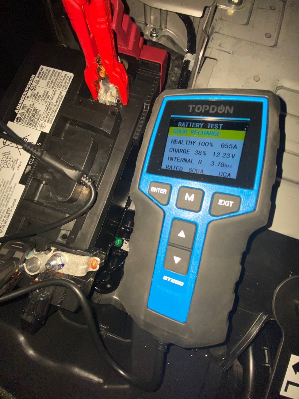

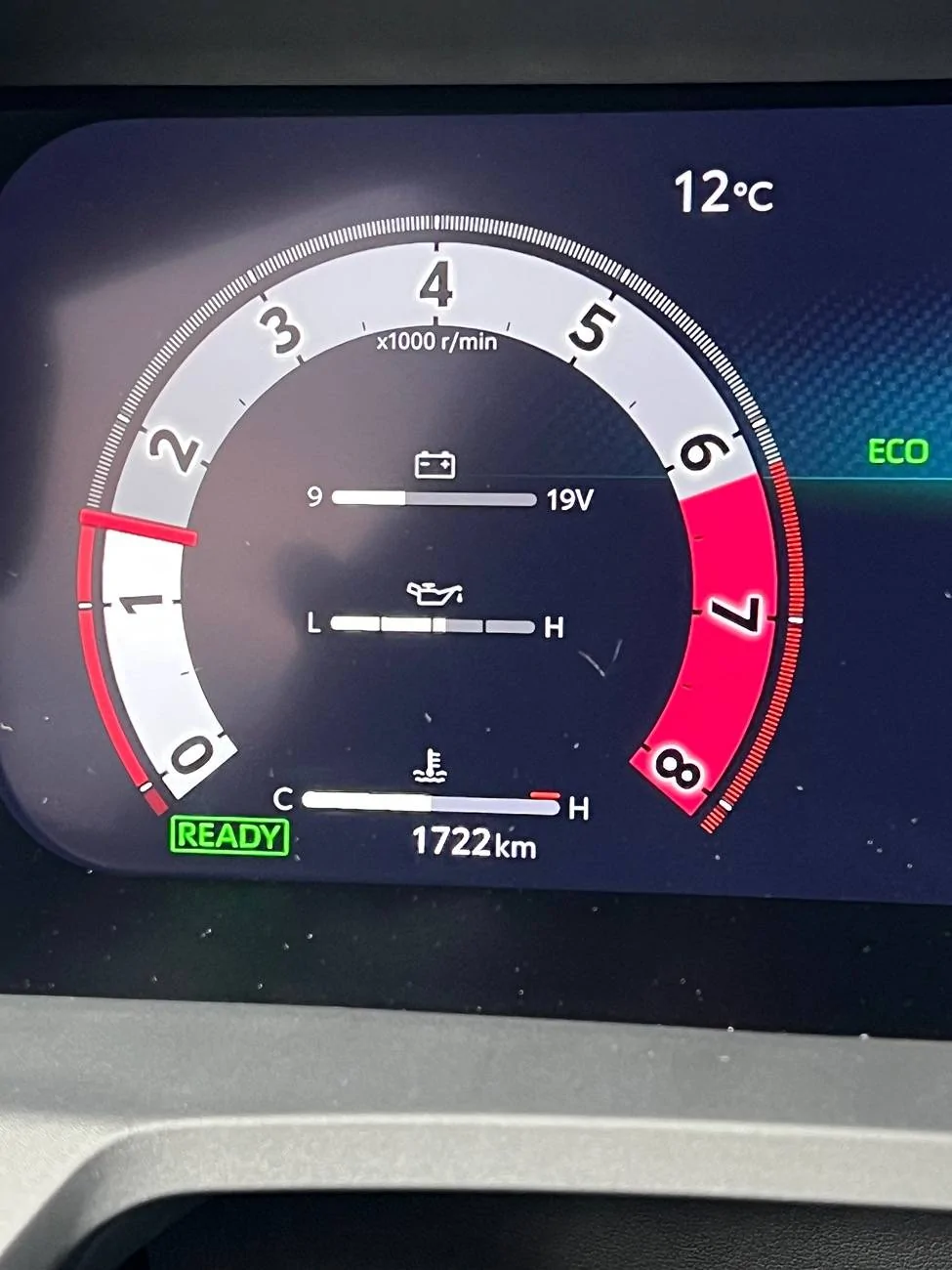

Here is the reading this morning after about an hour of mixed city/freeway driving. I was stopped a light and the engine was off, but it read the same when the engine was on. I assume that is below what it should normally be, and my multimeter pegs it at 12.18 vdc. I have not put my maintainer on my battery yet, but I will do that soon and see if the battery can be charged to a higher level.

@TacoFreak 12.18v is way too low, and sadly my gauge shows the same position after driving for a bit. And it has had the battery replaced when it was new on the lot. I very much think Toyota is aware of the issue, hence some models now appearing with alternators. A TSB is in the works, it has to be. A battery will not last long being maintained at such low voltage.

@MustardTiger Thanks for the feedback. I have my CTEK maintainer on it now. It labels a battery with that charge level as "bad" and is attempting to charge it. If it can't raise the charge level then the battery is already bad, and if it can then the truck is clearly not doing the job.
That is interesting about a battery failing when being maintained at such a low level. Dealers replace the bad batteries, but did they fail because the trucks can't keep them charged? That is what I think and that is why Toyota added alternators on some 2025 hybrids. Some people think it was just a bad batch of batteries, but I think this problem is actually caused by the truck.
@Tom Sellick's dealer told him that this was all normal, which is clearly a lie. The dishonesty and incompetence of some dealers is beyond belief. I think I have a good one but I guess I am about to find out.

But my truck does not keep my battery charged above 12.2 volts and in three hours my battery maintainer has raised it to 13.32 volts. That tells me that the battery might be fine and the truck is the problem. I will leave the maintainer on overnight and grab a reference screenshot tomorrow of the final voltage after external charging. Then I will drive it for a while and see where it settles. I will report back on what I find.
Same over here. My reading shows the same almost all of the time. Occasionally it will move up to ‘mid battery’ for a short period, then back down to the same as in your pic. Dealer said “this is normal.” ?
Battery appears ‘good’ but not being charged!
Strange. Our trucks keep their batteries at a level that pretty much everyone says is too low but there is no problem? I don't understand.
My maintainer charged the battery to 13.32 and it just continues to charge without the battery going any higher. The maintainer is getting hot and I took it off for now. It will be interesting to see where it is tomorrow.
I will call the dealer soon and get an appointment. My truck is due for the trailer blind spot monitor calibration anyway and they can check out the battery then too.

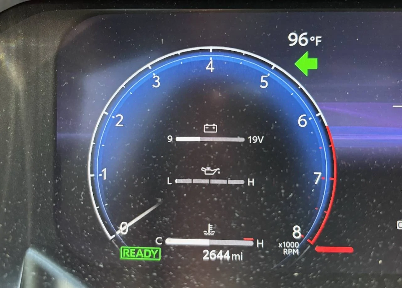

I have an OBD Link dongle that I can use to monitor various parameters. When I am in P, R, or N, I will see the voltage indicator above reading at the halfway point (5 segments) and voltage at the OBD port is 13.7 to 14.1. Once I select D, the voltage indicator shows the same as above (3 segments) and the reading at the OBD port is 12.7-12.9.
