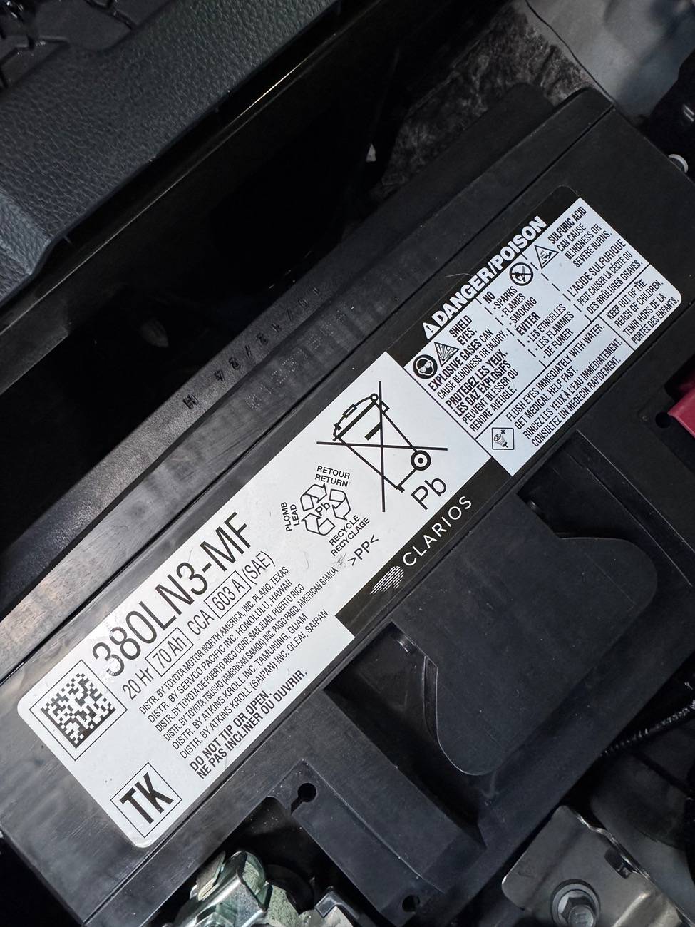

This is also the battery that is in my '24 OR hybrid. I carpool every other week and travel, so my truck sits for a few days and intermittently a week or so. Knocking on wood, I have yet to see an issue.
Same battery as my 25 pro
