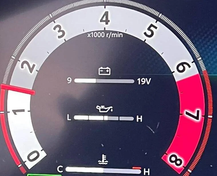

I have an OBD Link dongle that I can use to monitor various parameters. When I am in P, R, or N, I will see the voltage indicator above reading at the halfway point (5 segments) and voltage at the OBD port is 13.7 to 14.1. Once I select D, the voltage indicator shows the same as above (3 segments) and the reading at the OBD port is 12.7-12.9.

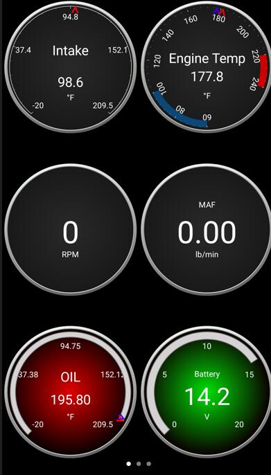

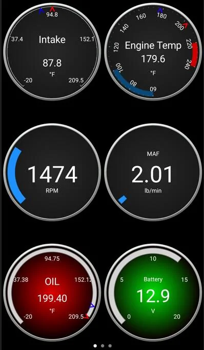

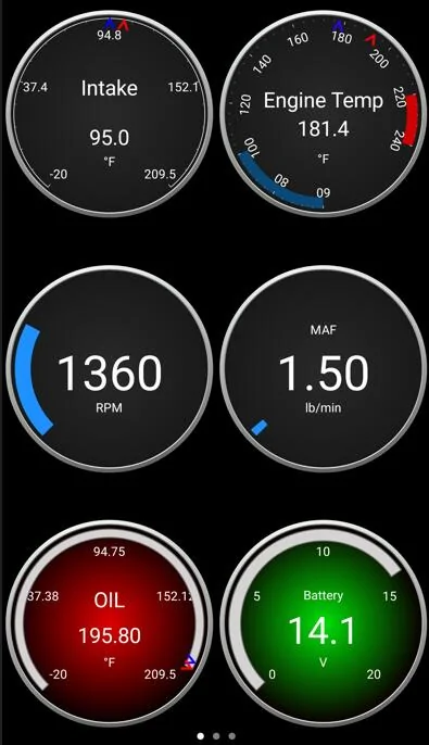

Following up on my previous post observations. Did some more driving around with the OBD dongle active. It appears the 12v charging system kicks in as needed. I noticed it seems to check/charge after starting up the Tacoma and will run for a short period, again reading about half on the voltage bar or 14.1v at the OBD port.
Truck turned on (after stopping at a store)..
While driving after restarting...
Then will stop charging until the trigger parameter is activated again or the truck is shut off and started back up. The voltage at the OBD port stayed at 12.9v during steady state cruise. This is also with AC and audio running.

@EVOTACO thank you for sharing !! My question is when the charging isn’t active, and it says 12.9v on the OBD…where is the dash gauge at?

The dash gauge is displaying the lower 3 segments at 12.9v, like what was shown previously. Visually there are no segment lines, but the gauge will move in segmented increments. They appear to be displayed in 1v increments (i.e. 12.0-12.9, 13.0-13.9 for each segment).
