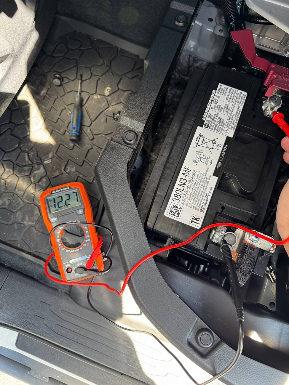

This is the longest I’ve gone not driving my truck so far, about 7pm to now 11am and my battery is showing 12.27
2,284
2,949
That does not seem right to me, but I have never had a vehicle that I had to check so often, so I don't really know how bad that is.
I have been checking mine pretty regularly, and it has been keeping it at around 12.5 volts. But after not driving it for 3-4 days this morning it is 12.1, which is way too low. I'll call soon and get a service appointment and I hope it is just the battery. But I have started to keep a jump pack in the glove box in case it goes completely dead, or the dealer tells me it is fine.

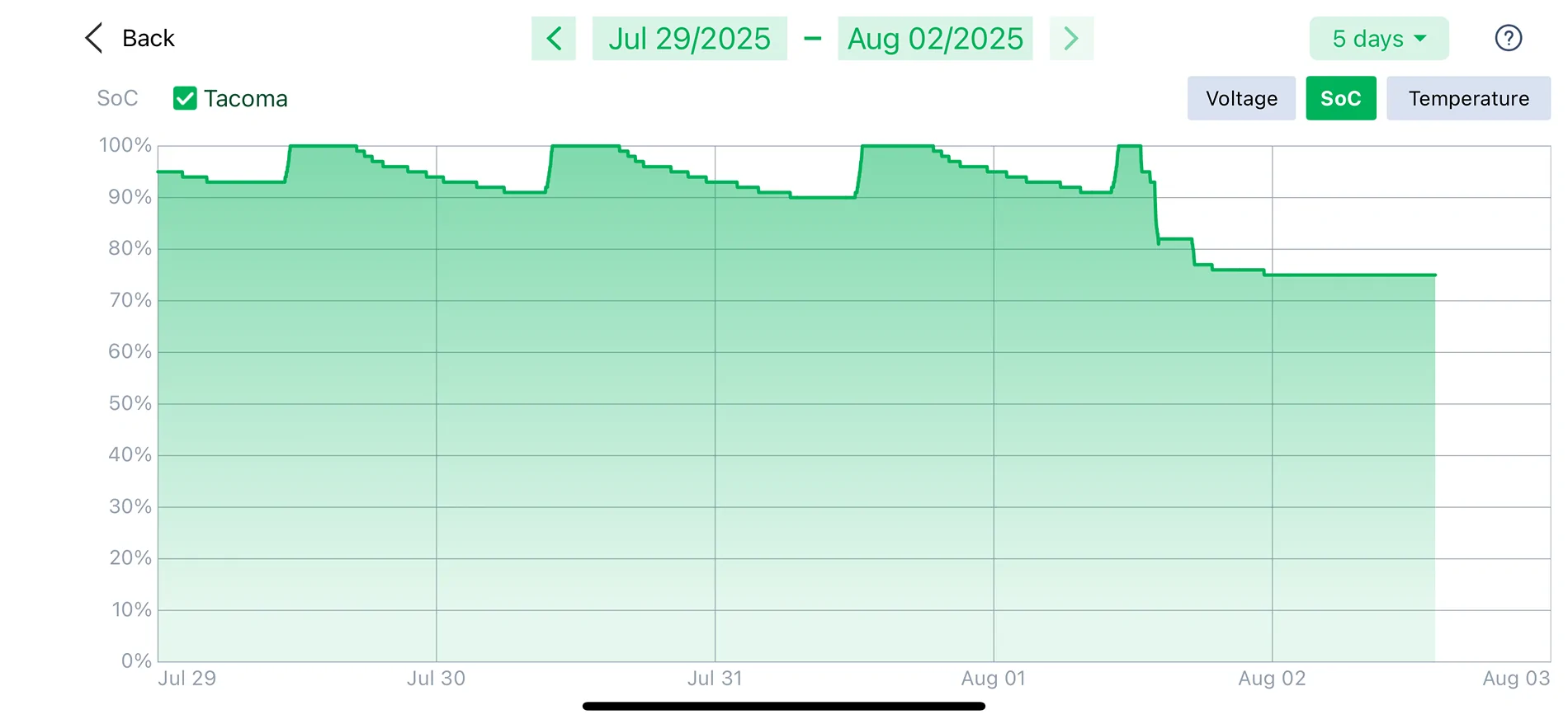

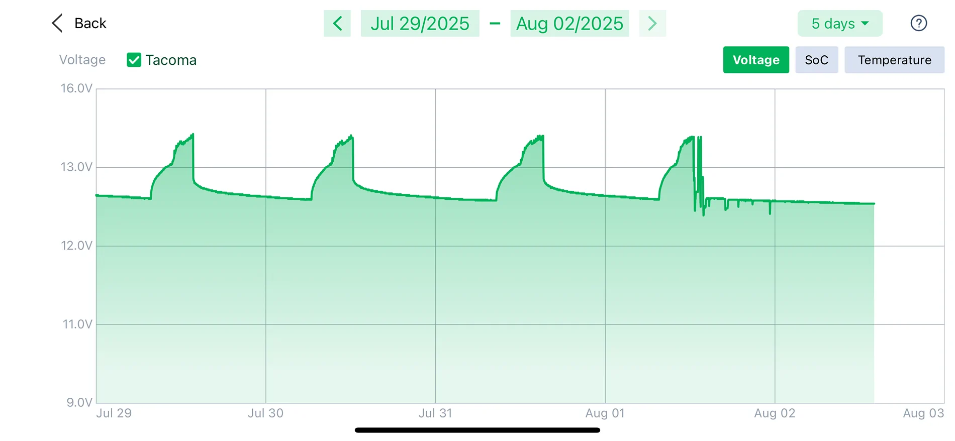

Not that I'm a battery expert, but likewise I've been concerned about not keeping my Taco on the NOCO charger, as I don't drive it very often. I bought a battery data logger to keep an eye on things.
I drove it for the first time since installing the logger on August 1st. so on the days prior you can see the state of charge goes from 90% to 100% while it's on the smart charger. After running the errands and parking it for the day, the SOC drops to 75%, and will continue to drop till I hook up the NOCO.
Maybe I'm crazy, but after driving approximately 40 mins with a few stops, I would have expected the SOC to be back up to 100% after getting back home. I've left the charger off to see what it does. I'll perhaps go for a drive tomorrow just to see what it does, but I don't have a lot of confidence in the charging system. The logger is an Ancel BM300 Pro.
