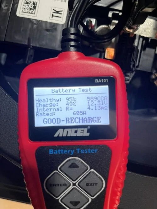

But I've noticed the low SOC, state of charge, as shown in a percentage on the conventional 12V battery. NOCO is a brand of smart charger. I was regularly seeing below 50% SOC shortly after driving it with a tester, as others in this post have reported. While I've not had any issues due to the low SOC, it's not good for the battery health long term. The picture below was approximately an hour after parking it from running errands a few weeks ago.

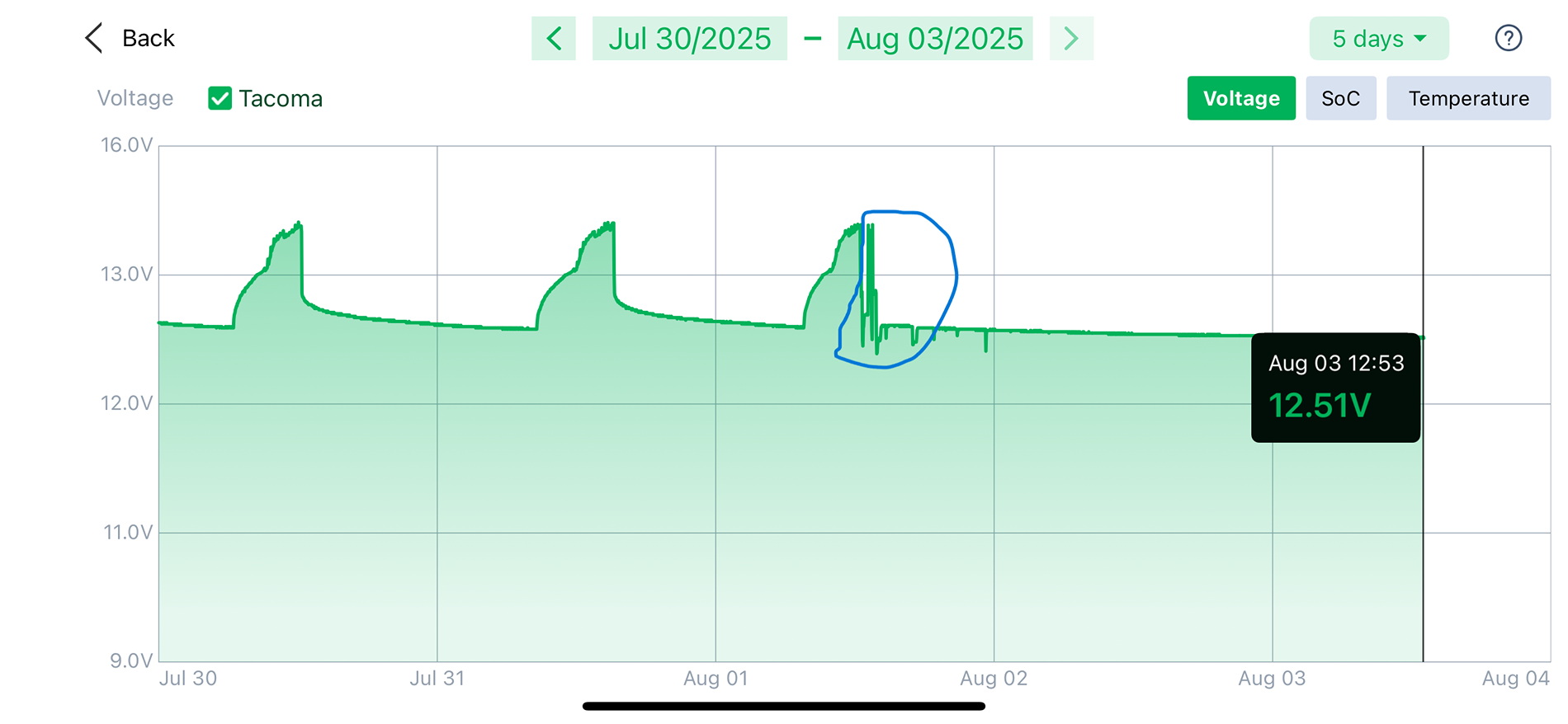

Not that I'm a battery expert, but likewise I've been concerned about not keeping my Taco on the NOCO charger, as I don't drive it very often. I bought a battery data logger to keep an eye on things.
I drove it for the first time since installing the logger on August 1st. so on the days prior you can see the state of charge goes from 90% to 100% while it's on the smart charger. After running the errands and parking it for the day, the SOC drops to 75%, and will continue to drop till I hook up the NOCO.
Maybe I'm crazy, but after driving approximately 40 mins with a few stops, I would have expected the SOC to be back up to 100% after getting back home. I've left the charger off to see what it does. I'll perhaps go for a drive tomorrow just to see what it does, but I don't have a lot of confidence in the charging system. The logger is an Ancel BM300 Pro.

What’s the voltage look like as you’re driving around? Is this your original battery or has it been replaced?
Ford did a recall not long ago due to a bunch of bad batteries, so the first answer is certainly a possibility.
Second answer begs the question of whether due to a defective charging system component, or due to a design flaw.
It's the original battery. I've circled the voltage of me driving.
