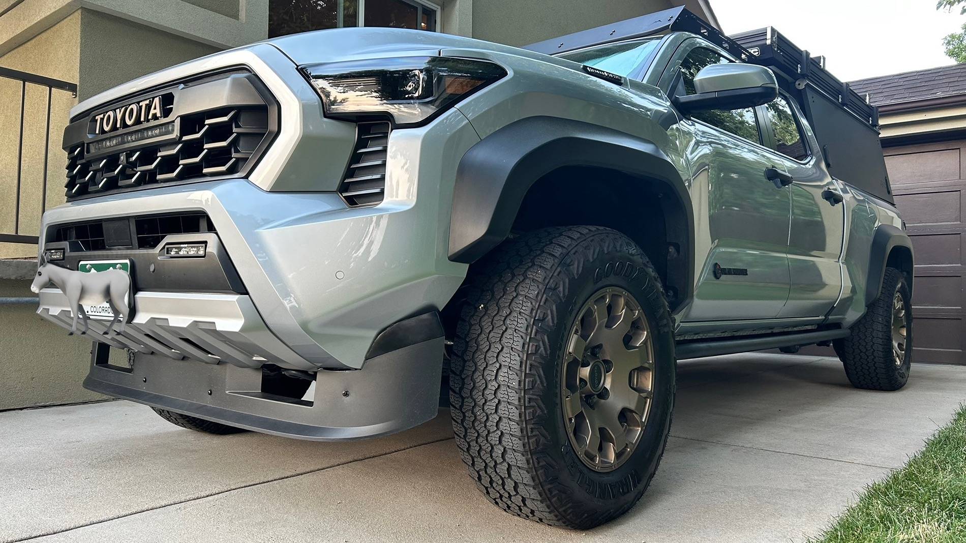

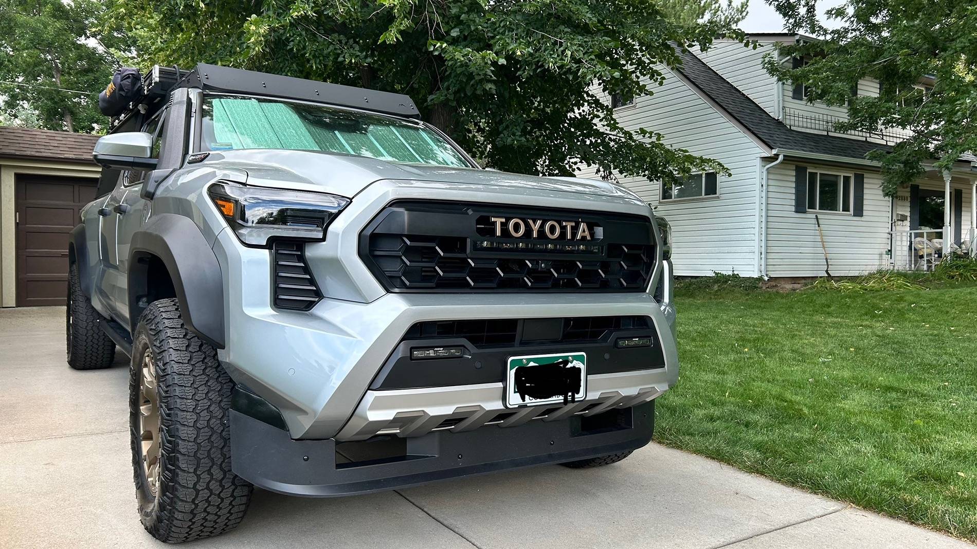

The goal is a 400mi tank on a stock Trailhunter. Got a Go Fast Camper + a Martin Off Road Roof Rack w/ a big ass spoiler. Currently getting 18.5mpg @ 7,300 mi. Nix the OE sport bar and the rear recovery points (swapping for SixthElement aluminum), added constant is ~350lbs with the kit.
Notes: Minimal cutting on the chin spoiler itself, had to get some aluminum angle brackets and utilize a few OE mount locations. The most time spent on this was shaping additive spoiler near the high mount cutout bumper. Did that with a type of urethane foam (DivinyCell), carbon fiber & resin, bonded them to most outer edges of the dam wings, EVA 1/16” stand-off cushion against the bumper). With the airdam clearance is 11” H w/stock Goodyear Wranglers. The mounting points do not interfere with skid plate mounts at all. All said & done 6 bolts, disconnects in ~5min when I want to get more into crawling on trail.
Just finished it yesterday and will drive it ~1k and then look at the numbers. Expecting ~20mpg+ highway at minimum driving speed limit adaptive cruise etc. If it underwhelms I spent $15 for the airdam on Fb market place & an afternoon modifying with random extra materials in my garage.

So the idea is to change the angle of the air dam to angle it moreso to the ground as well as to deflect wind from the tires?
The Trailhunter and Pro have more of a high clearance bumper than the other trucks. The fill in area that the OP added gives you an idea of the difference.

Wrong. fairing on the Martin OR rack literally brought it from 15mpg to 18.5mpg. Aero & rolling resistance.
Drove up to the high country today, ~40 mi trip, 17mpg up / 28 down. Just about at sticker print for the combined now. The airdam and the roof spoiler do work. Distance factor needs to be logged to really get a solid number tho.
Gonna toss up some pics once I have ~1k mi and a solid trip out to Moab in strong headwinds.

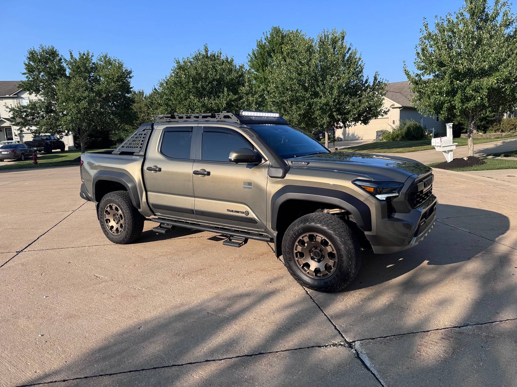

2024 Tacoma Modified Air Dam on a stock 2024 Tacoma Trailhunter 4th Gen IMG_0163

I might have missed something, but how did you get a trailhunter with an air down? Or did you add it afterwards? And I average 20.8 miles per gallon in my trailhunter.
Yea the OP explains everything. Bought it for $15, made modifications to it. Current trip reports are 23mpg w/the air dam, ~65mi logged w/it installed…
