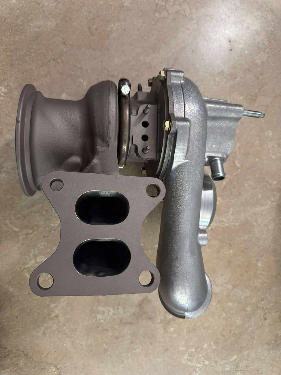

Got a package in the mail and was too excited not to share! We'll be posting more information and results from testing this on a variety of setups here very soon. This option will likely serve as the backbone to our upcoming "Stage 3" setup for those curious. Thought I'd share a little teaser as some of you might like to see what's coming.
100% Bolt-in
100% Stock appearing (it uses the OEM housings)
Stock Turbo Specs:
• IHI SPEC VB51
• Compressor Wheel 42.87mm x 58mm
• Turbine Wheel 51mm x 40mm
• Single sleeve bearing, no thrust bearing, dual piston rings on turbine end, single on compressor
OEM Turbo Upgrade Specs:
• Built on the OEM IHI SPEC VB51 housings w/ upgraded wheels
• Comperssor Wheel 49.70mm x 67.40mm
• Turbine Wheel 54mm x 48mm
• Prototype variant uses the OE configuration CHRA. Production versions will come with a custom ball-bearing CHRA upgrade

Appreciate your enthusiasm and support! The turbo's used on the Tacoma are the same across all trim levels (including the hybrid models), so this upgrade would fit just like your OE unit on the SR trim.
I'm told it is likely to be offered complete with no core required, as a core option, and will be available with an optional install kit with a complete set of gaskets, hardlines, nuts, hoses and clamps to completely replace your OE unit.
I'll be sharing a list of all the part numbers for these parts should you seek to procure them yourself or just need a replacement.
what will this provide?
An approximate 40% additional airflow potential, bringing the output potential up pretty significantly over stock with proper tuning.

Glad to hear it! We’re pretty excited too — this setup has been in the works for a while, and it should finally give us the headroom the stock turbo just can’t support. We’ll be posting data from testing very soon so everyone can see what it’s capable of in real-world conditions.
Would be nice to include the performance specs after this “upgrade” or no one knows yet?
Edit: Just saw your other reply. 40% increase with a proper tune? What does the proper tune mean. We need to install a tune to benefit from this bigger turbo kit?
We’ll have full dyno data and test results once development is finished, but based on preliminary modeling, we’re expecting around a 40% increase in flow potential over the stock turbo. On the upper end, that could mean up to ~425whp with high-octane fuels or ethanol blends. On typical pump gas, I’d expect something closer to ~350-375whp (on a gas truck). Of course, we’ll defer to the actual dyno results once the turbo is on the truck and properly tuned.
To your second point: yes, a proper tune is required. The factory calibration is designed around the stock turbo’s flow limits and won’t make use of the larger compressor and turbine wheels. With our calibration tailored for the new hardware, we’ll be optimizing fueling, ignition, cam phasing, boost targets, and torque management to safely unlock the extra headroom this turbo provides.
Can our 4bangers internals handle this 40% increase of airflow...I had to ask
Great question, and one we’re keeping a close eye on, which is precisely why we perform this kind of development on our own vehicles, not on customer trucks. The short answer is yes, the internals can handle it, within reason. This upgrade was intentionally spec’d as a conservative option that does not exceed the mechanical capability of the OE engine. Toyota built these engines with a decent amount of headroom, and everything we’ve seen in testing so far suggests the internals are up to the task when paired with a safe calibration.
We’re not building “race trucks” with this package. Our entire development philosophy and upgrade path is centered on giving owners more performance without compromising the core design and purpose of these trucks. We’re not going to release anything that undermines why you bought the vehicle in the first place.
Stage 3 is meant to give the platform room to grow and to provide something with more potential than Stage 1 for those who want it, but not to turn the engine into a hand-grenade.
