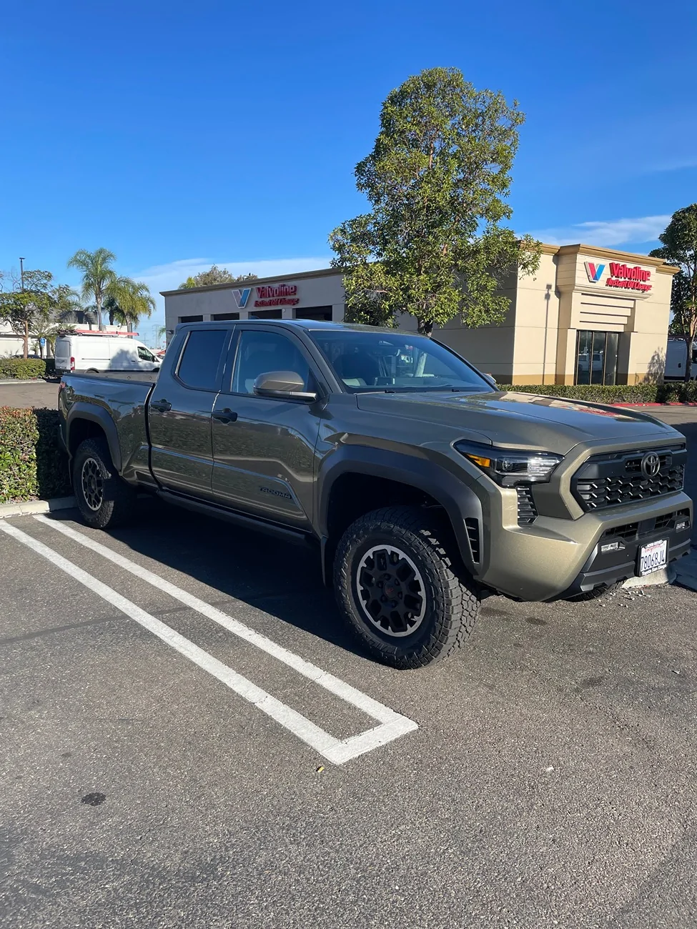

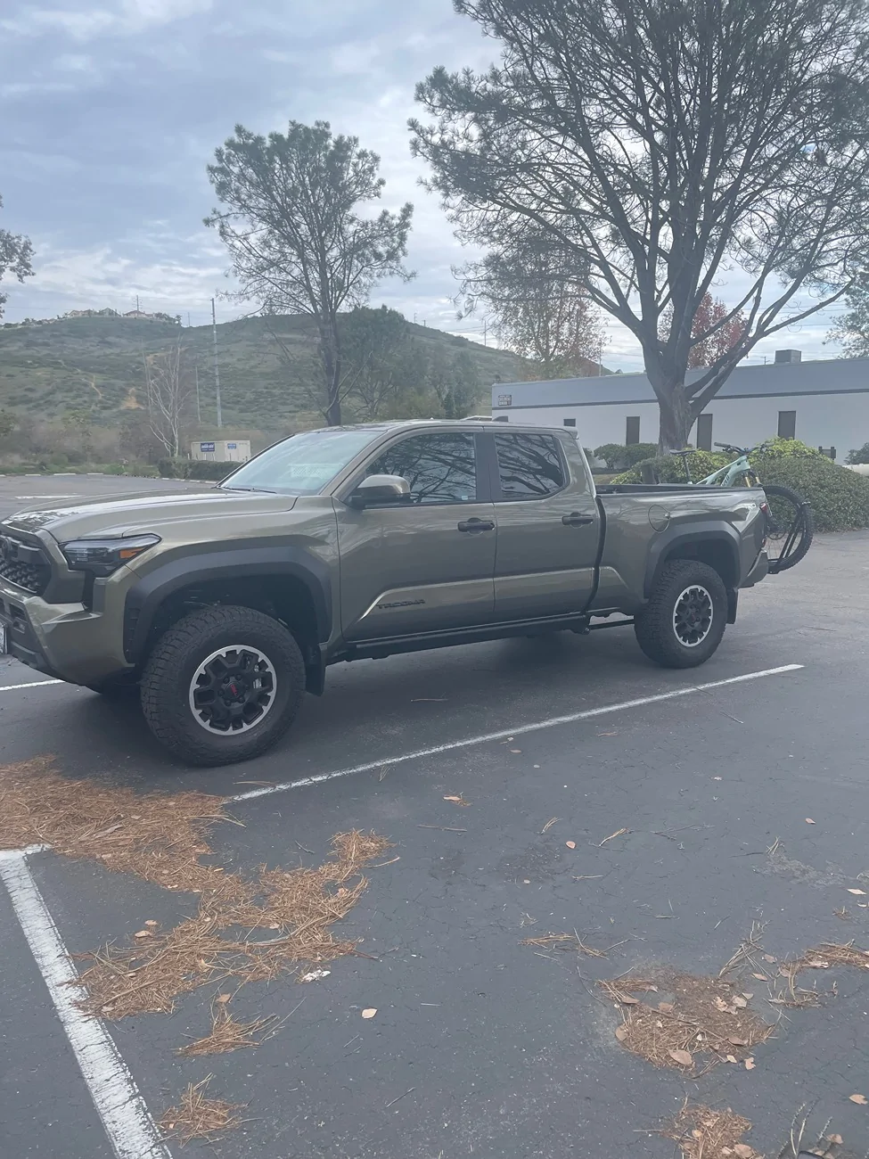

Just picked up a gen 4 and immediately swapped out the tires to Wildpeak 285/70 r17 tires and kept my original stock tacoma wheels.
Looked ok as I had also popped in some RC 1 1/2" spacers in front to level it out a bit.
Here is a couple of pics with the stock rims 17 x 7.5 +55 offset.
2024 Tacoma 17 x 8.5 better than 17 x 7.5? IMG_0568
2024 Tacoma 17 x 8.5 better than 17 x 7.5? IMG_0586

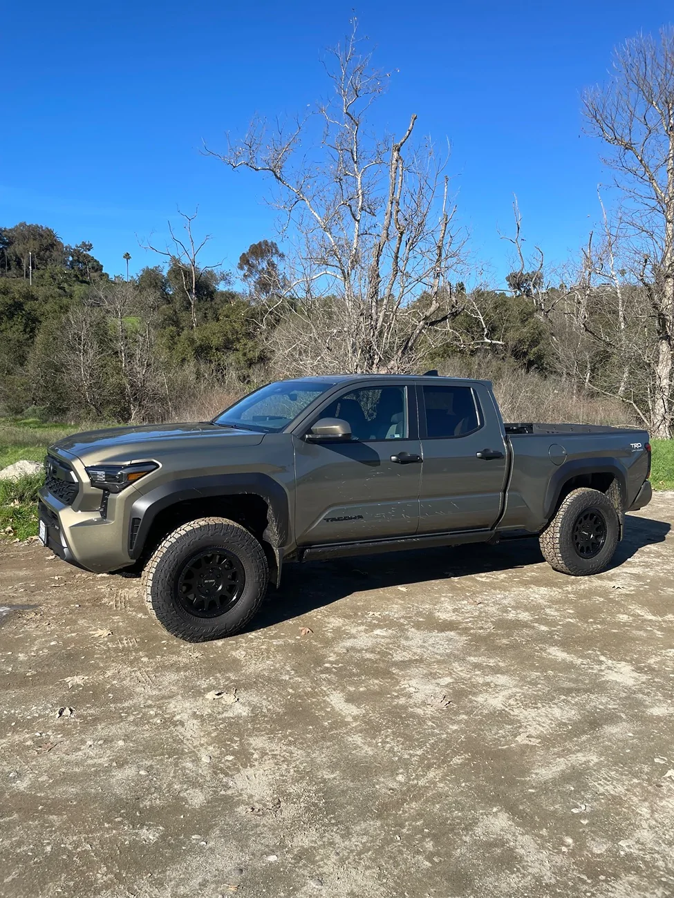

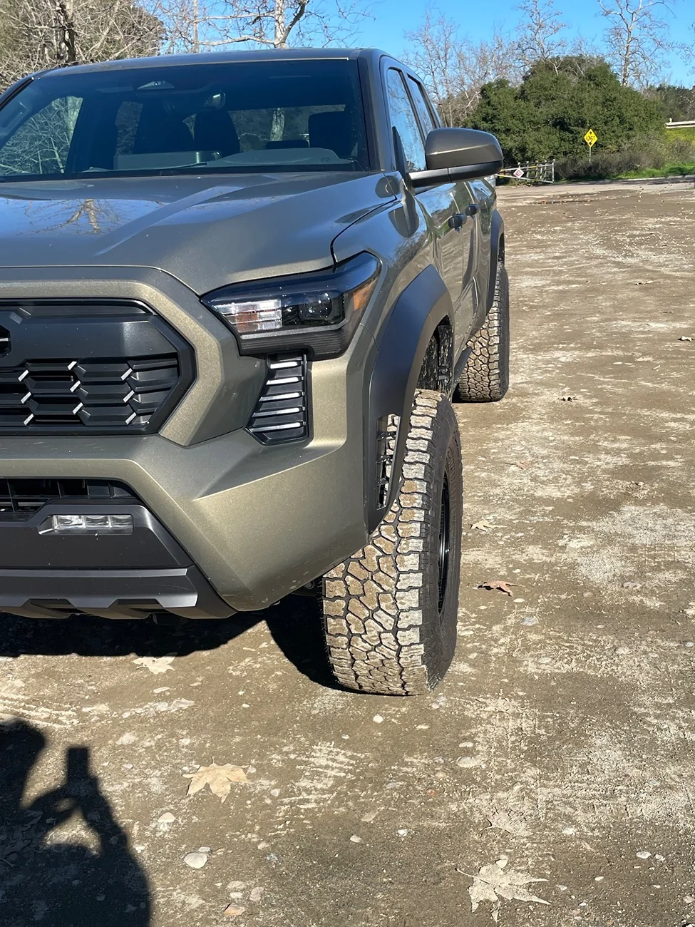

Now my conundrum.
Just got a good deal on some Method 305's in black sized at 17 x 8.5 and +25 offset and popped them on.
Maybe its because the rims are 1" wider making the tires look fatter, as they are of course, but looks a little odd to me.
That being said I am getting a Dirt King pre runner kit installed next week and so that will raise the body a bit and create a larger gap/space around the tires next to the body making it look more proportional in my eyes.
Here's a couple pics of the methods on.
Which look better?
Fire away.
2024 Tacoma 17 x 8.5 better than 17 x 7.5? IMG_0590
2024 Tacoma 17 x 8.5 better than 17 x 7.5? IMG_0588

Looks good to me, being a long bed it will last ok fantastic when lifted 🤩

Looks fine to me, but I suppose I'm not entirely sure what you are referring to. Are you meaning that the wider wheel makes the tire itself look funny, as in less "balloon" or are you referring to the different offset pushing the tire outward and away from the fender?

What I mean is the tire is wider and maybe doesn't have as tall as look as it did with the narrower rims.
Im hoping after getting the lift to space the tire away from the body it will look more proportional, for me anyway. Going from the +55 on the 7.5" wheels to the +25 on the 8.5's sticks me out about an inch more or so which is fine.

I see, that's what people around here refer to as "poke", or how much it pokes out from the fenders. Your current setup with the methods is probably the most popular. Raising the suspension will pull the front wheels in slightly but not the back, but you can always go back to stock. Even if you sold the OE wheels most would make that trade with cash on top for the methods.
Btw the increased "poke" is supposed to be ideal for larger tires especially off road. Also, you'll probably wanna upgrade those mudflaps to a set of Arks or something if you end up keeping that setup. They OEM barely does the job at stock offset.

I like stock much better, but I pretty much don’t like any aftermarket wheels in general.

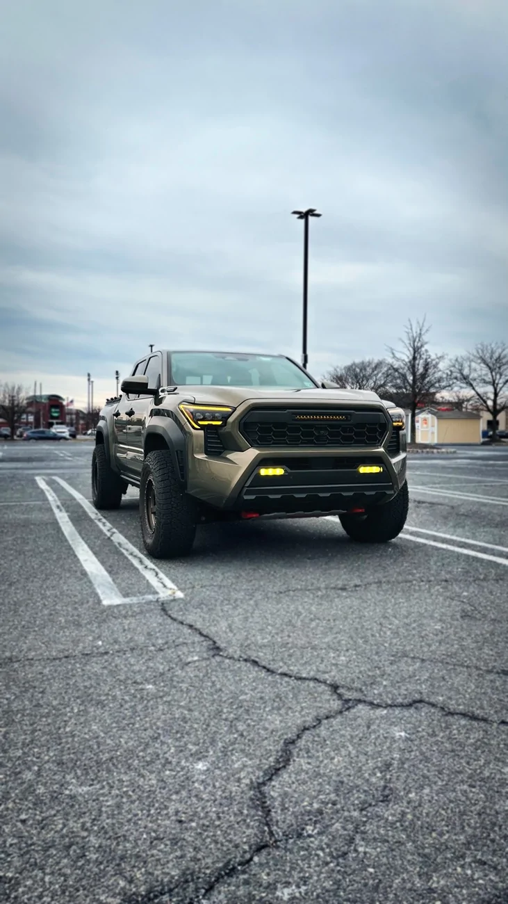

Guess what will go through your mind after the lift… I need 35” tires now. :)
I installed 285/70/17 wildpeaks on my 0 offset wheels immediately after I purchasing my truc with stock suspension. This is My first truck ever and km contemplating going 35” but with the zero offset I’m certain to trim.
2024 Tacoma 17 x 8.5 better than 17 x 7.5? 178248B9-5805-4051-9DC9-7D39863E8ECE
